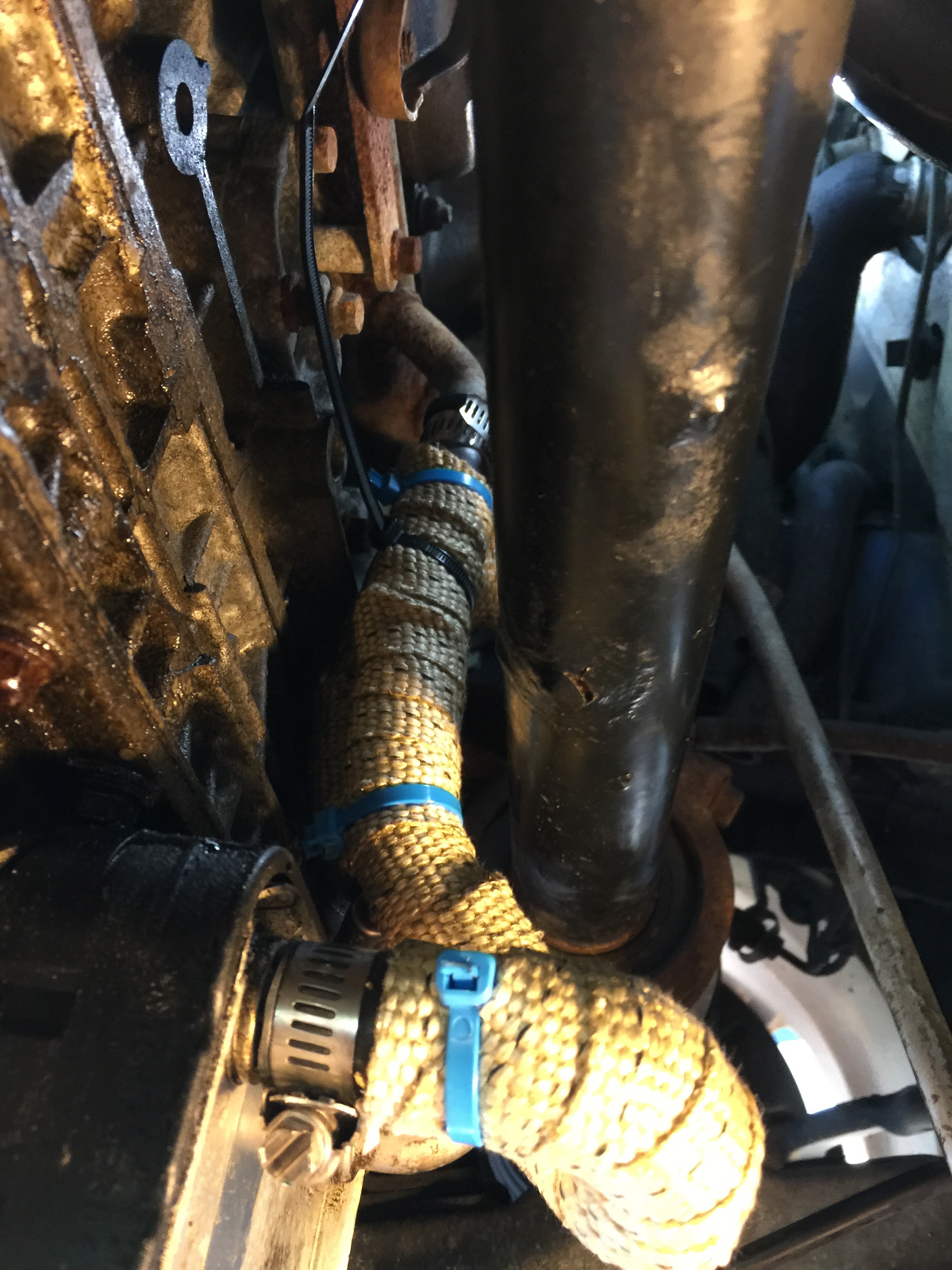

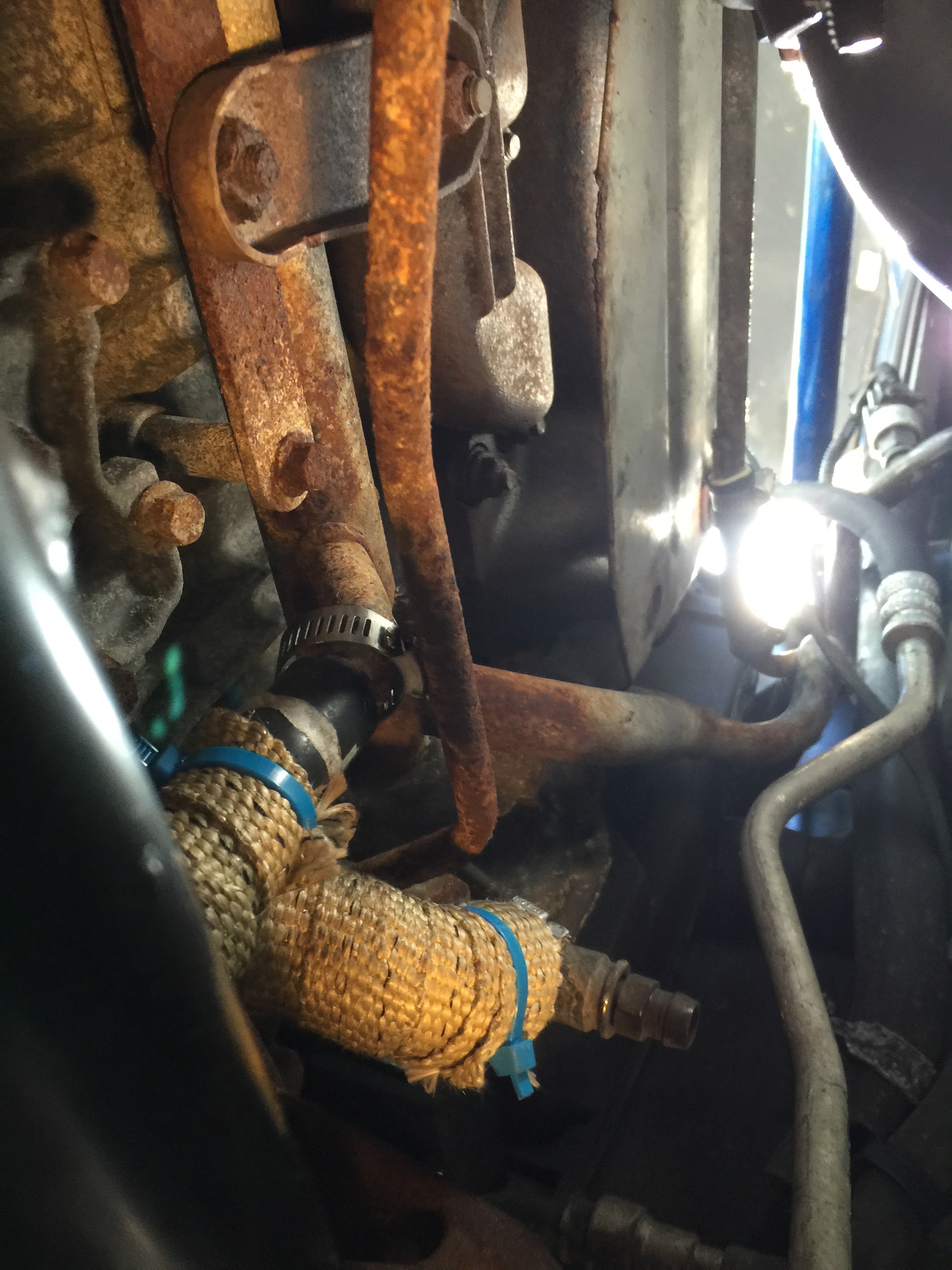

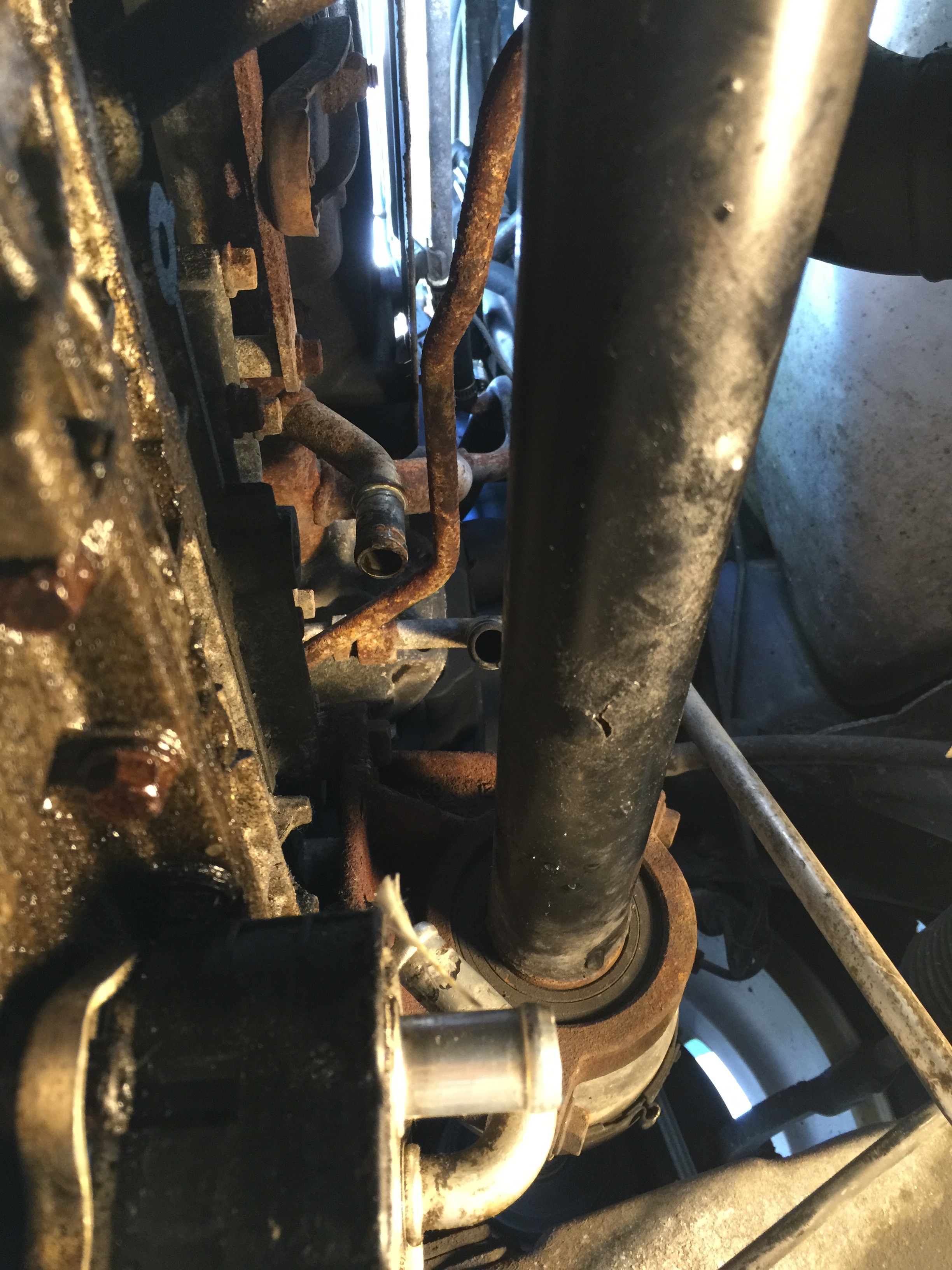

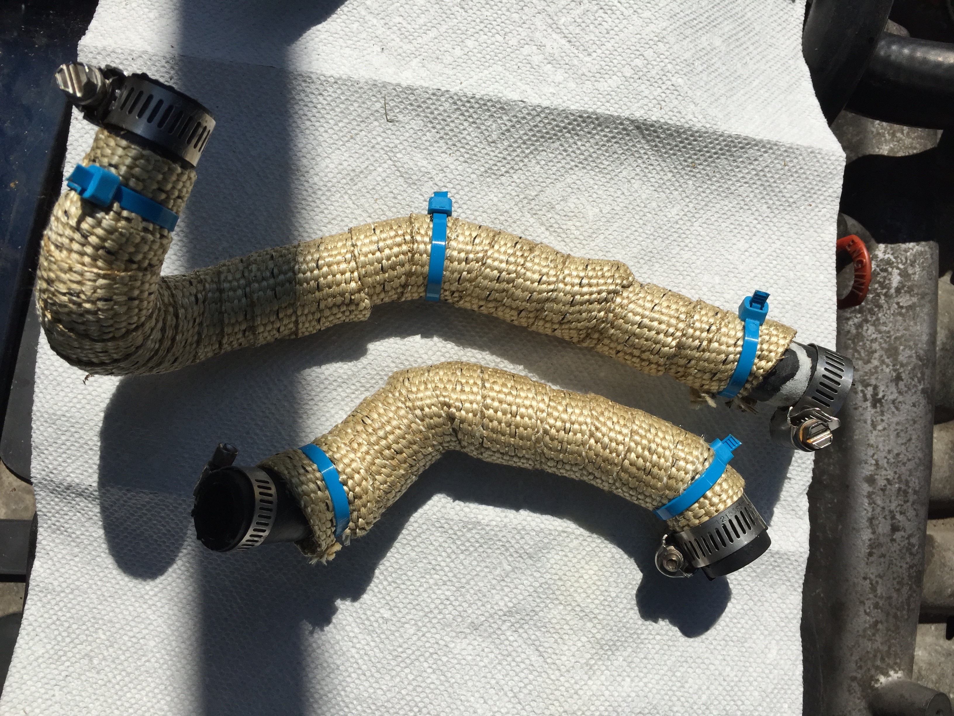

I replaced the two hoses on the brick style oil cooler under my T5 - elapsed time 75 minutes

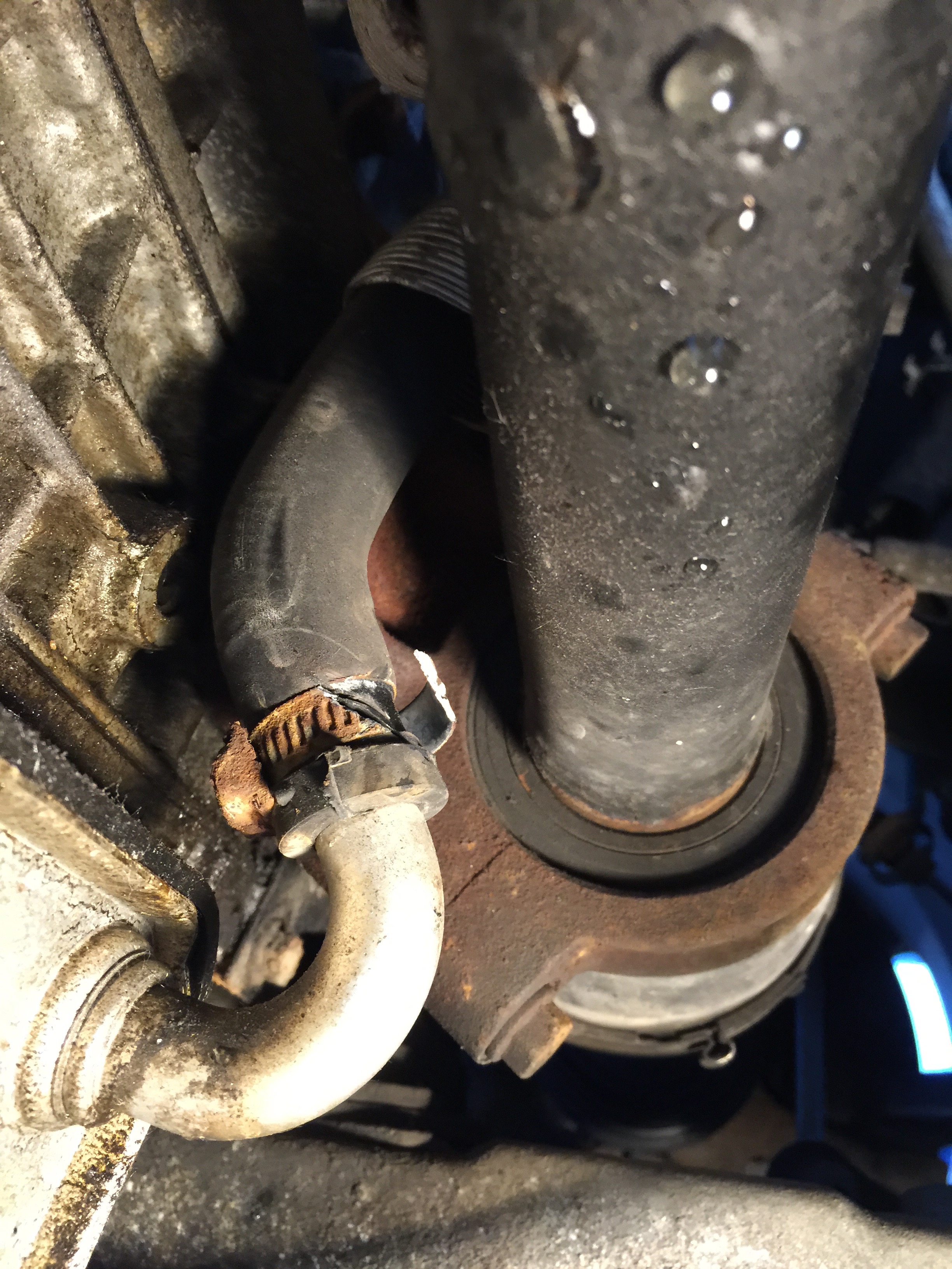

I Dremeled off the old hose clamps which were 'Jubilee type and pretty rusty. There is great satisfaction in hearing the 'ping' of the hose clamp releasing without busting knuckles. Elapsed time per hose clamp - 15 seconds.
Clean and wet the hoses before pushing them on firmly. Think about where the clamps go so you can easily get a socket on them (not a screwdriver) and get them nice and firm.

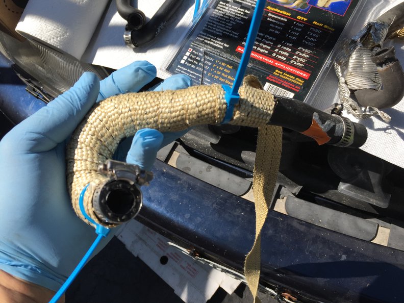

I replaced the factory heat wrap with muffler wrap to protect them from heat, and then zip tied them together just like Volvo did
1999 V70 T5 oil cooler hose replacement DIY 31104688 30676906V

A much needed DIY so nicely documented, thanks for posting.

Strictly Volvo stuff for hoses, especially around turbo. It's brutal working back there.
