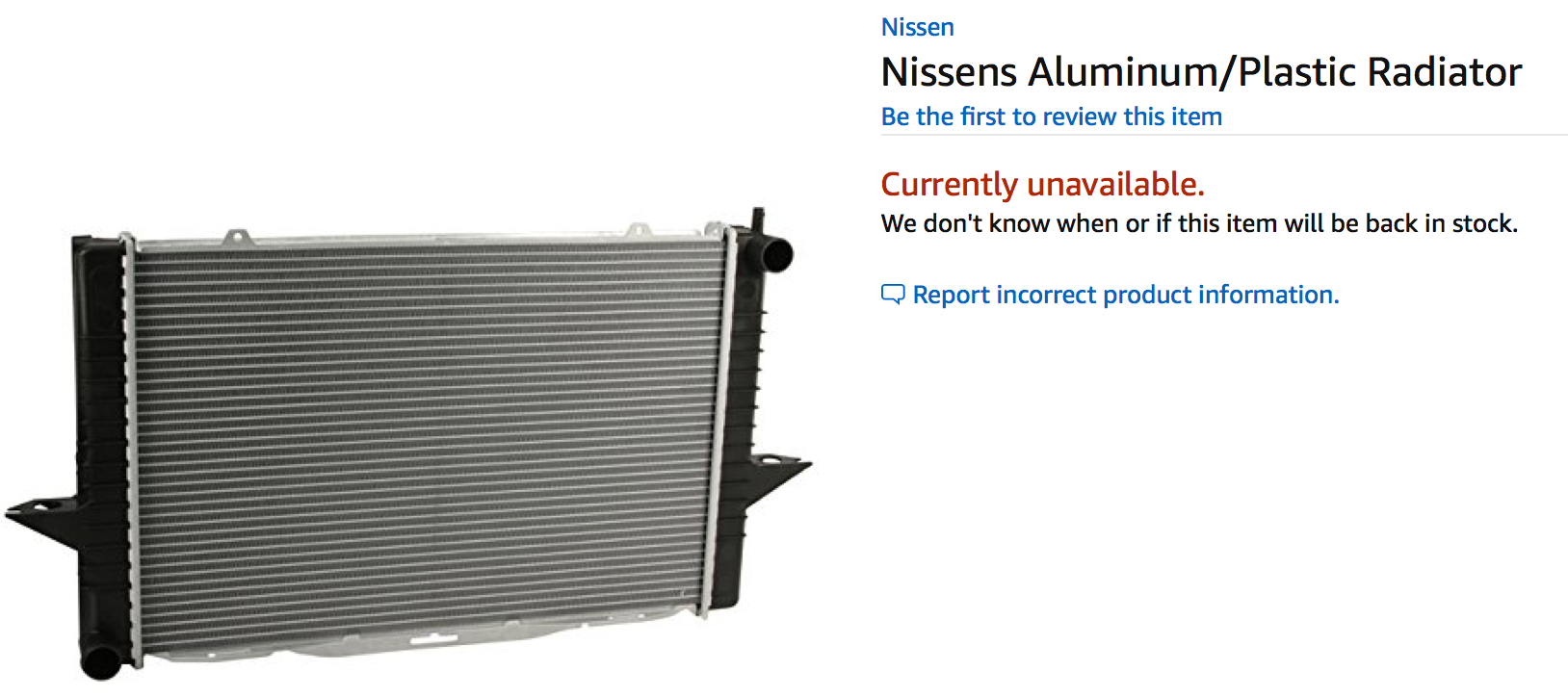

I recently went through this with my 99 S70 base M/T. I too was confused when I started researching this and was told to just use the AT variant and leave the AT coolant ports plugged. I was about to buy a AT radiator when I found a Nissens M/T (no extra ports) on Amazon. I bought that and it went in just fine. I was all excited to finally answer someone's post with good news and post you a link to the radiator I bought but it's listed as "unavailable."
Ugh.
You can't even find this on amazon at this point. This picture is available through "my orders" so I can't post a link to the item anymore.
The only Nissens one on Amazon for the s70 is the AT one at this point.
I get why they don't make MT specific ones anymore (how many manuals are out there anymore) but when I found a MT specific one I figured I'd grab it.
