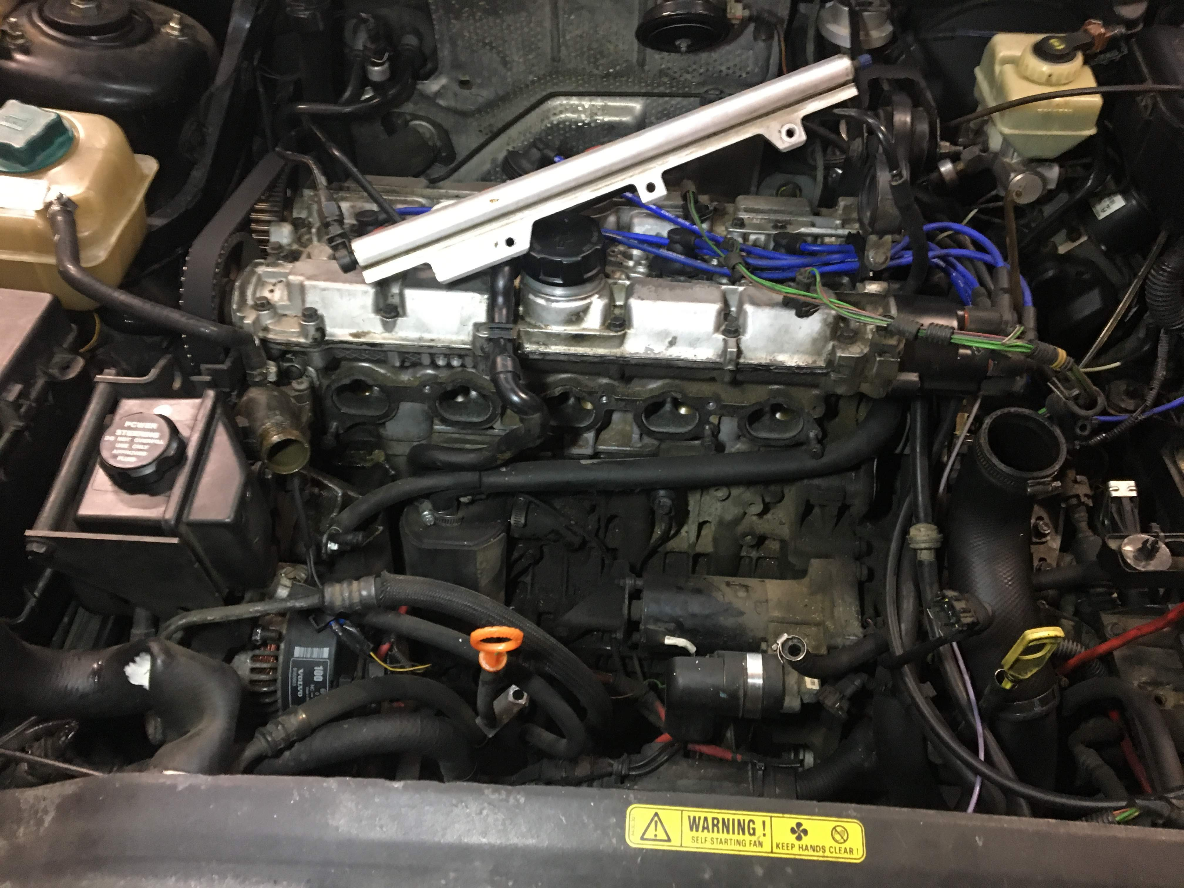

I pulled the intake manifold this morning, but I can't find an M10x1.0 tap locally to tap for the two barbs on the NA intake manifold that the turbo intake manifold requires. Going to look tomorrow, if not I'll order one and move onto the cam install.

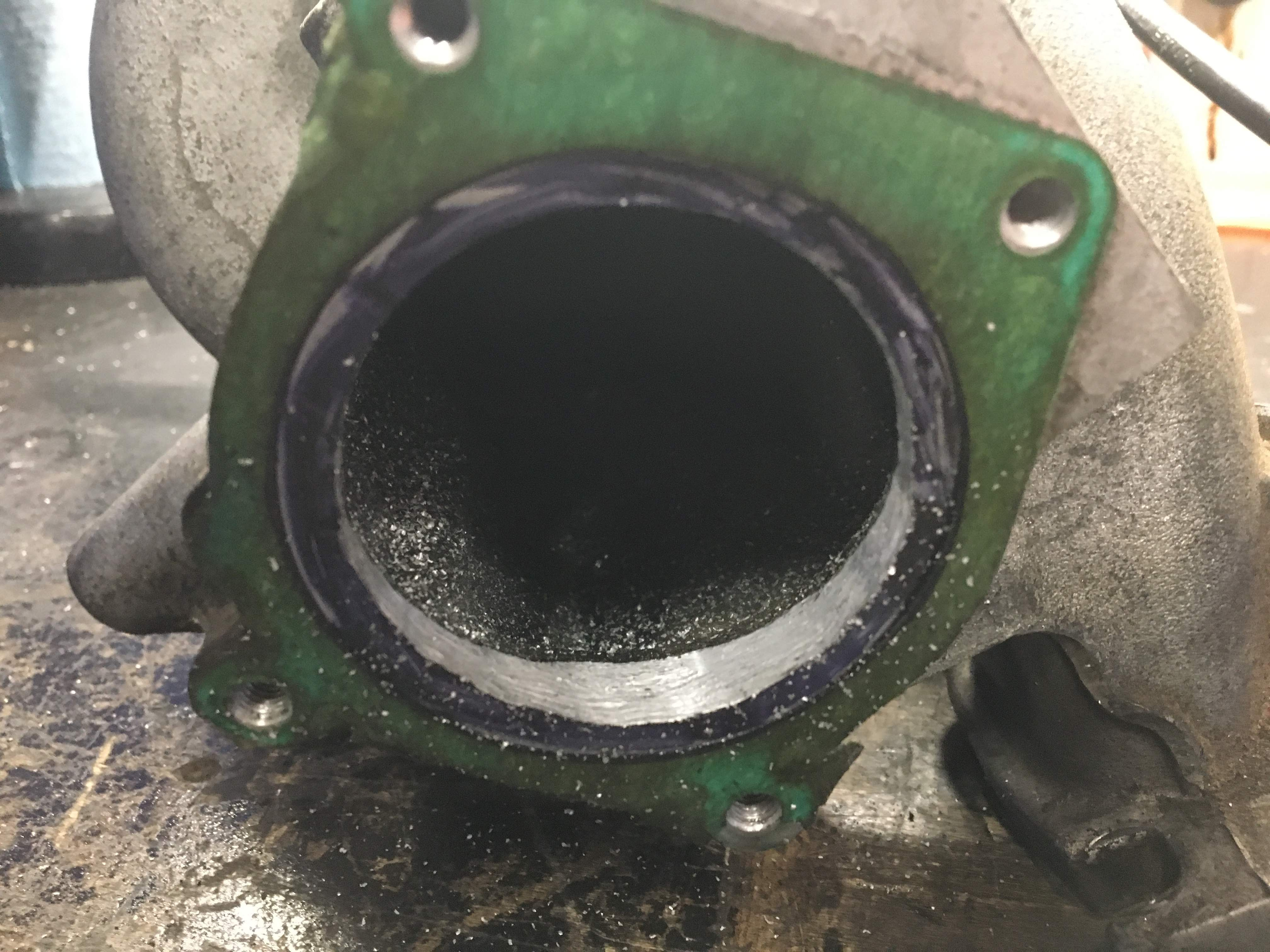

I attempted to port match the turbo intake throttle body, but I don't have the patience! Plus it makes a HUGE mess of aluminum shavings... not comfortable on the skin.
The only difference between the manifolds is that the turbo has two extra vacuum ports and a smaller opening for the throttle body. Options are to add two barbs to the NA manifold or port match the gasket on the turbo manifold. This is assuming both manifolds are for a '98. Older ones are different, I believe.

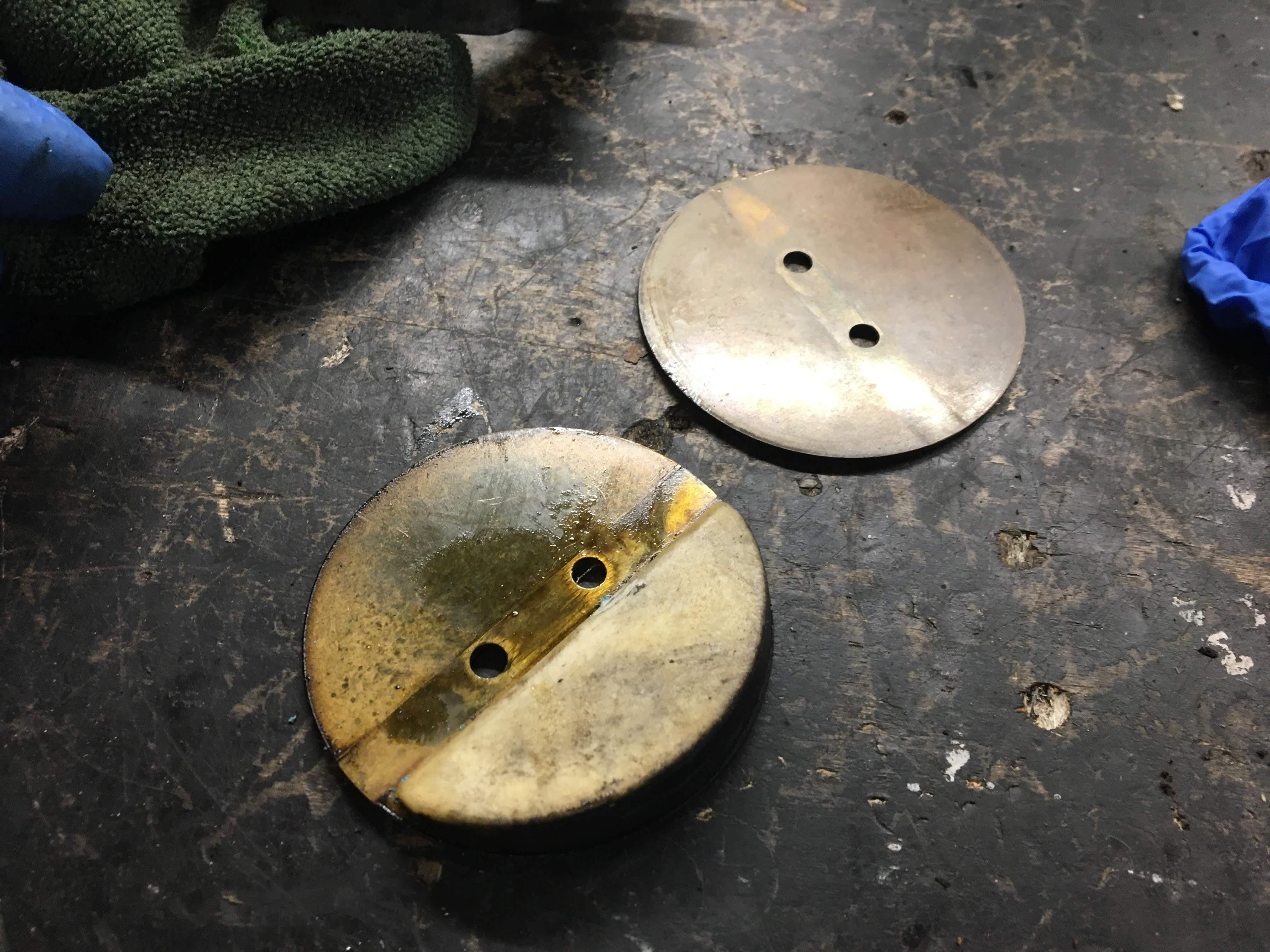

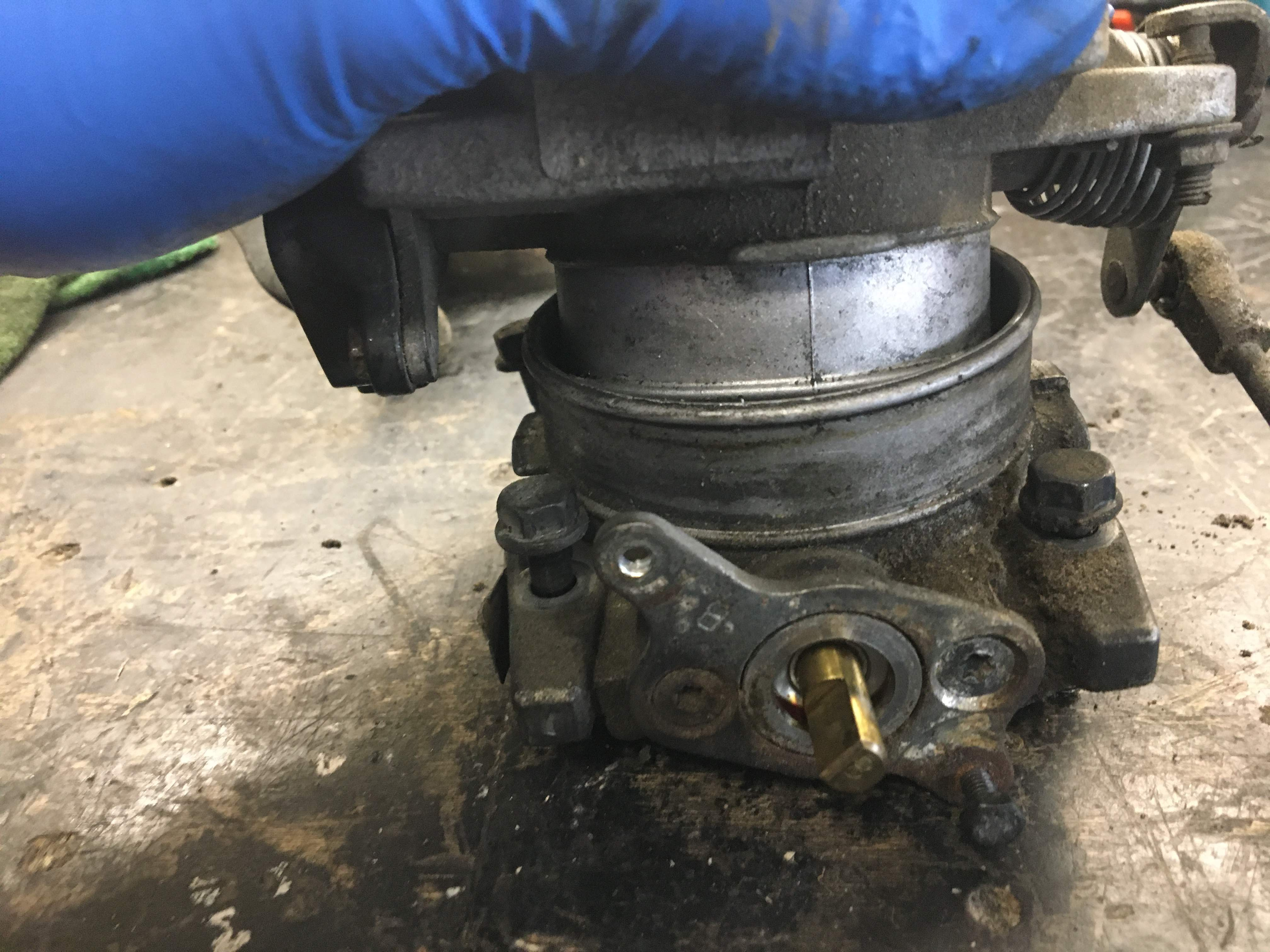

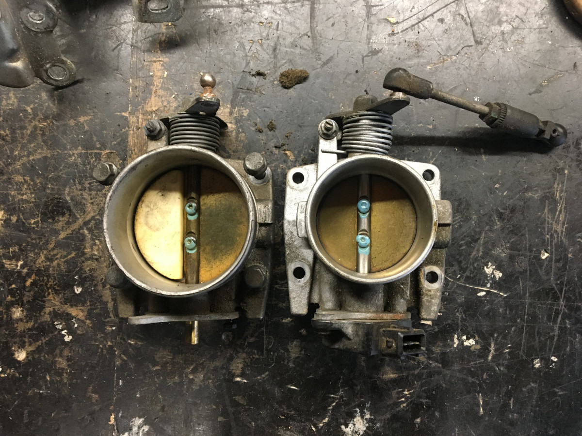

I also installed the 960 throttle plate into the NA throttle body. Just look at the size difference between the turbo and NA throttles!
