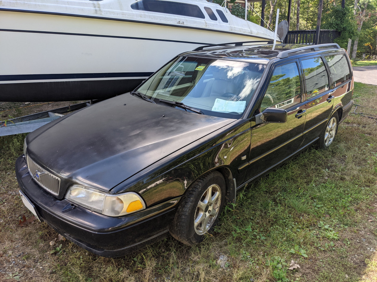

This is Geronimo, a 2000 V70 FWD NA with almost 353,000 miles. The questions are: What's wrong with it and how much will it cost to fix?
The owner is a long time Volvo lover having previously owned a 240 (and more?). She really loves Geronimo and is truly happy that it may get to drive again.
Her goals for Geronimo are to fix it enough to drive it this winter, then spend money over time to make it more reliable. My goal is to determine how the car can be fixed, break the repair into phases, and give her a price for each repair phase. The phases I see are:

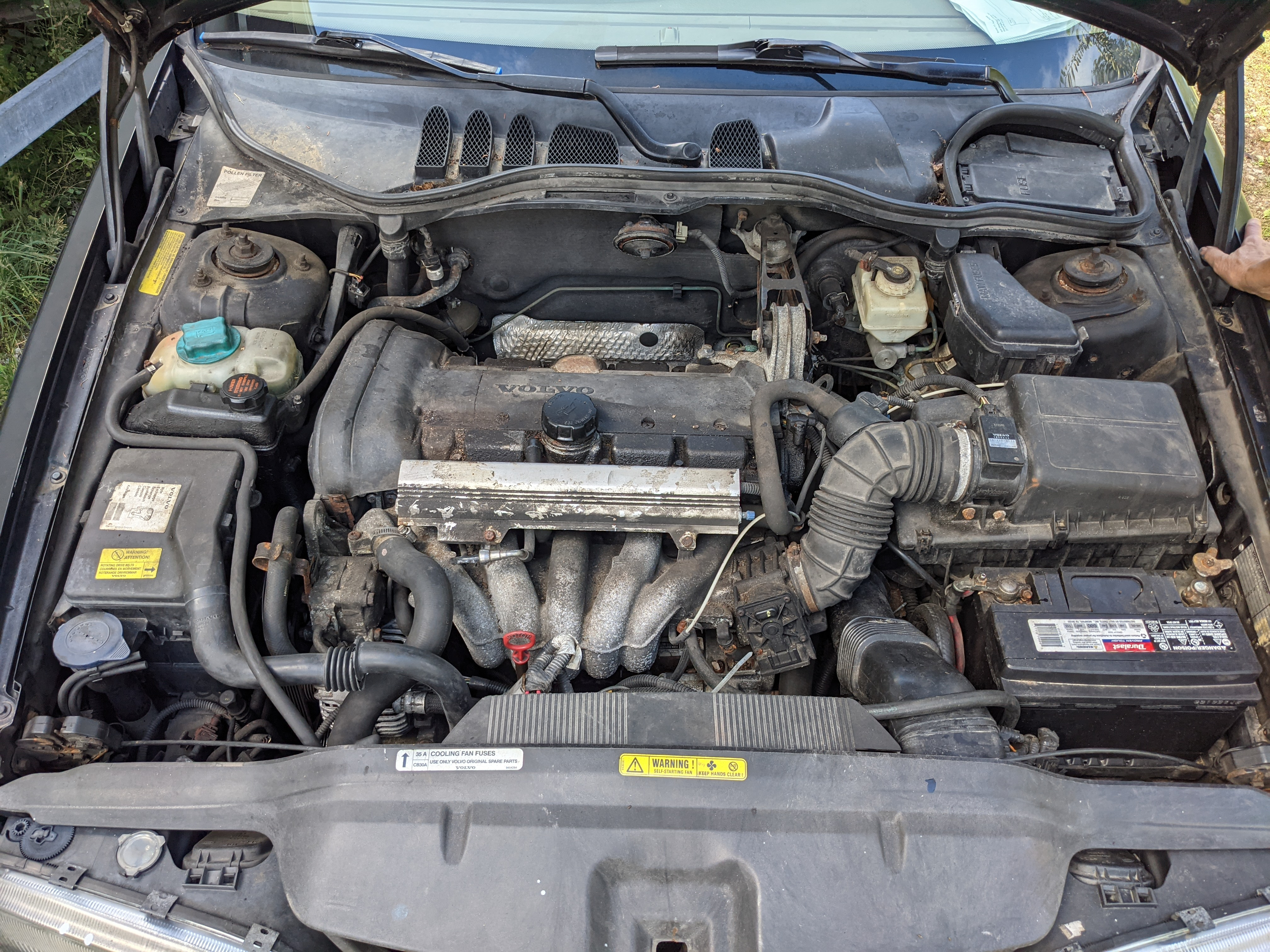

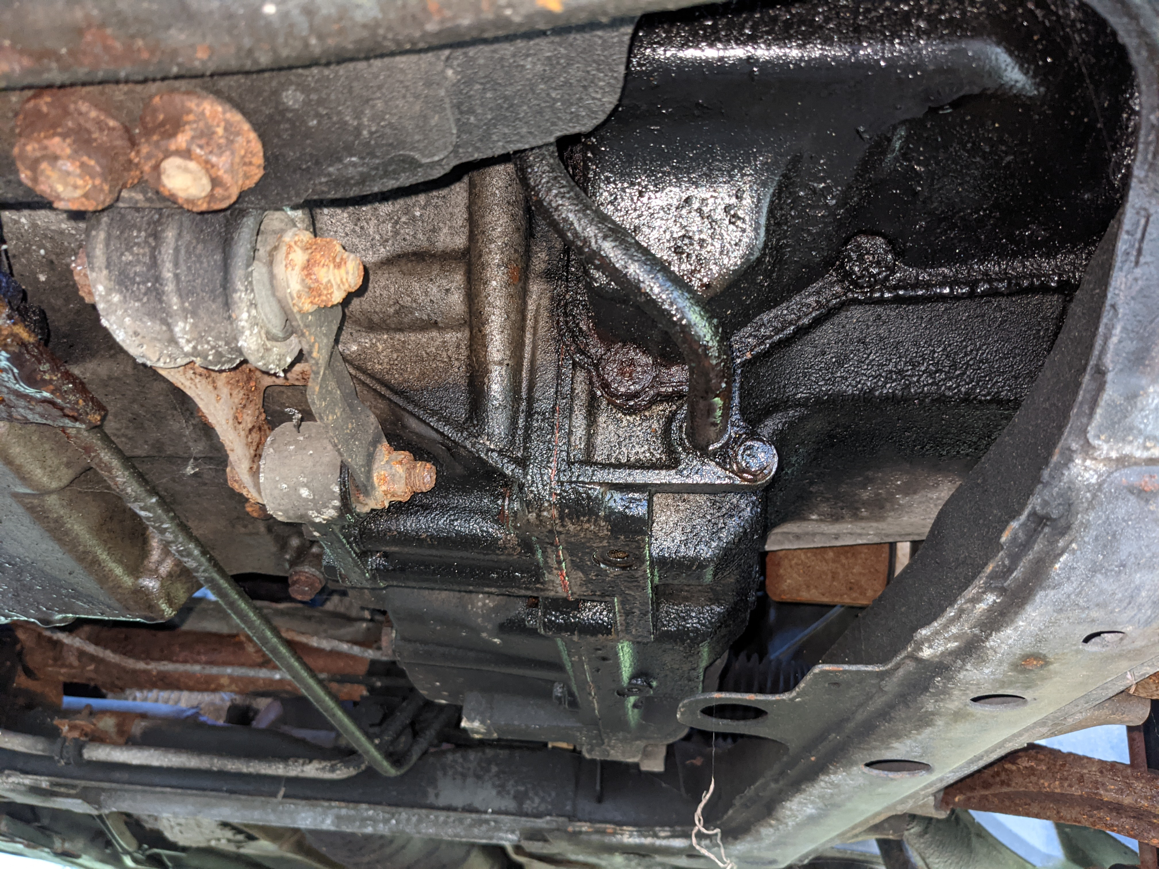

I've never seen so much leaked fluid in an engine bay. There are leaks in the oil cap gasket, power steering tank, and transmission cooler lines at the radiator. There may be leaks in the transmission valve body cover, dipstick base, PCV / oil trap, and oil filter cover. This must all be cleaned to determine where leaks are coming from. What damage could be caused by having fluid all over the engine bay?
Since the primary problem is limp mode, I'm worried about the transmission fluid level. I couldn't find the transmission dipstick (among all the leaked fluid) in order to check it.
The engine idles very roughly, fluctuating its rpms. It sounds like one or more pulleys are failing. The engine (and passenger cabin) shakes at idle, mostly at front passenger's side, and I see the upper driver's side mount is cracked. When I quickly tap on the gas pedal, the engine surges an additional one or two times after I've stopped giving it gas. This video shows the rough idle, then the whining power steering pump (fluid is very low), then tapping the gas for 3x revs two times.

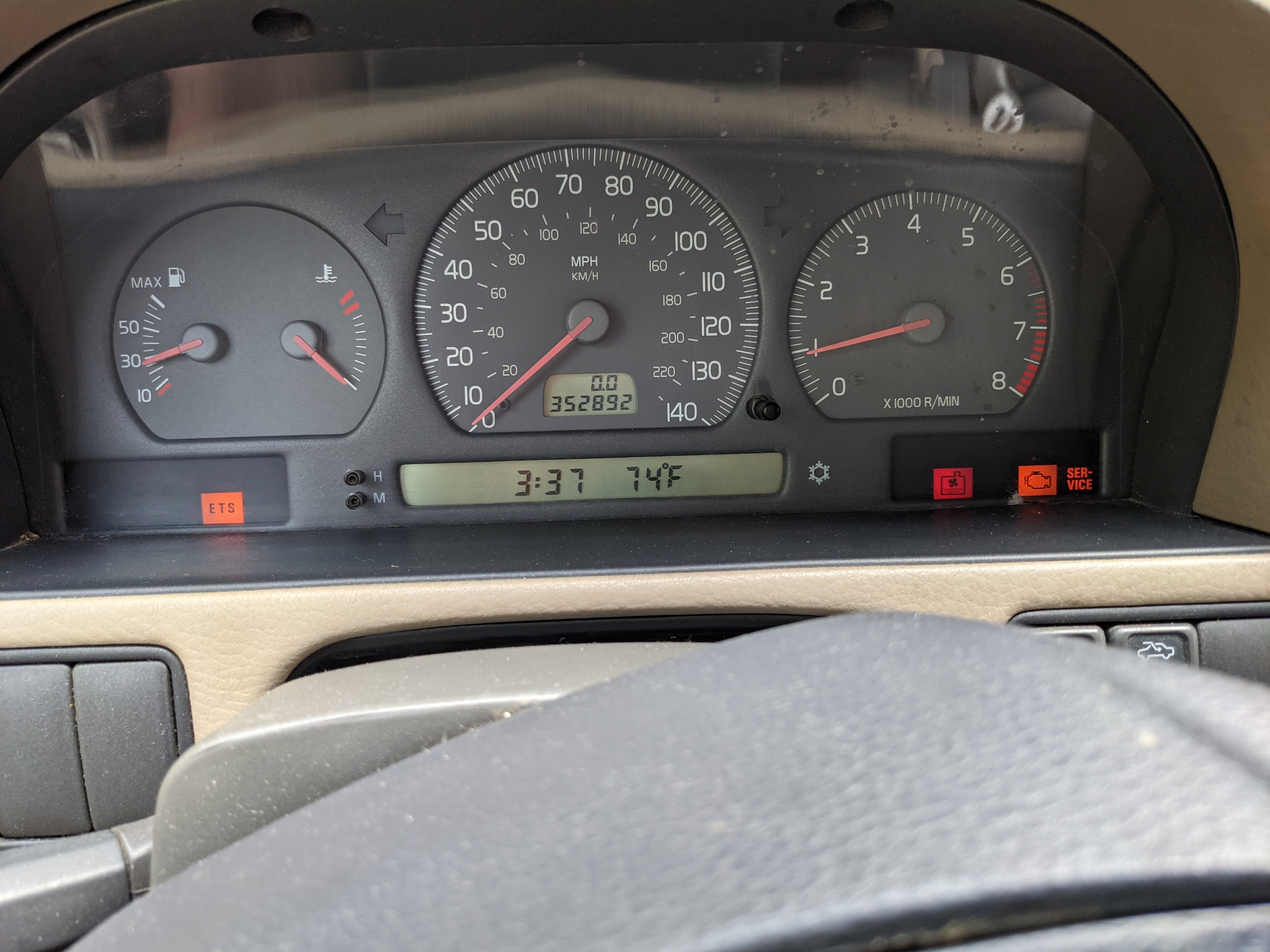

Geronimo must love Christmas because the dash lit up like a tree. Using a basic Innova 3100a OBDII scanner, I pulled the following codes. Would it help to see them in the order the scanner presented them (I sorted them by number)? Would it help to see the letters active for each (ie: M, F, CC, C, EV, O, OH)? Would you like the freeze frame data (from P1600)?
P0135 (pending) O2 Heater Circuit (Bank 1, Sensor 1)
P0220 Throttle/Pedal Position Switch B Circuit
P0221 (pending) Throttle/Pedal Position Switch B Circuit Range/Performance
P0717 Turbine/Input Shaft Speed Sensor Circuit No Signal
P0722 Output Shaft Speed Sensor Circuit No Signal
P0768 Shift Solenoid D Electrical
P1600 ETS Malfunction
P1610 (pending) Ignition Discharge Module (IDM) Group D
P1618 Fault in Lead Between AW 50-52 an Motronic 4.3 (MIL Requested)
Some of these errors could have been caused by mice chewing wires (they're living in the air box), fluid in the engine bay hurting electrical components, or the control module box overheating because its air line is broken.
Here are the dash lights at idle. The shift arrow is flashing (not shown).

- The air intake hose is disconnected at the air box base. It's pushed out of place by a crudely replaced transmission cooler line at the radiator. There's leaking where both trans cooler lines meet the radiator.
- Sparks flew up from the battery negative terminal when cranking during the compression test. No sparks flew when I turned the key with no plugs in (no cranks). The battery negative wire nut was only hand tightened.
- The coolant is overfilled yet the "coolant low" indicator light is on.

The GRRRR-70 is definitely Canadian. Tipoffs are the check engine symbol vs lights , and fuel in liters vs the fractions gauge we get in South Canada
My take..
Codes
> real code, newOXS or wire repair
Fake code, probably fixed with ETB replacement
Possible abs module rework, but chewed wires could also be root cause.
Cause of key problem or internal trans problem?
Time for a visit from Albany 2000 V70 parts depot
Double check code mapping
Chewed wires?

Good Lord what an undertaking. You're gonna have to start somewhere and work your way around one step at a time. First things first start cleaning what you can see. It runs and that's a good starting point. You may want to remove the air intake just to get a better look around the transmission and wiring. A smoke test would be very helpful in finding those vacuum leaks
The transmission fluid dipstick is under the air snorkel with a short yellow handle right on top of the transmission. It's well hidden. It would not surprise me if you had some vacuum leaks so going though any hoses you can find and inspect for damage or just buy a roll of it and start replacing them regardless.
- manovlov
- Posts: 1241
- Joined: 06 Jul 2011, 06:47
- Year and Model: 1995 850 GLT 2.5 170
- Location: Grenoble, France
- Has thanked: 673 times
- Been thanked: 164 times
So, here's a link to the manual, it may help :
www.volvotips.com/brochures/850/Volvo-S ... Canada.pdf
+ 1 with Zion XIX. I'm not afraid by all this oil : some break cleaner will be a good start , when the engine will be dry, to see more clearly from where The Grany loses its means...
Not useful to spend money on new fluids, because leaks everywhere. Clean the engine from bottom as much as you can, refill where needed, turn the key and let the engine turns for a couple of minutes. Then, have a look under the old lady's petticoats.
I also agree with Neil, if you have to start from somewhere, check the transmission fluid level at first. Here's a link to our friend's video Robbi DIY on automatic transmission, you will see where's the dipstick :
I know that some petrol cars on these years have an issue with a part built by MAGNETI MARELLI the throttle body. To repair that part may be a bit expensive. But maybe in US you can find here an address to do that job for few bocks.
I would also check the fuel filter and the spare plugs.
Geronimo has a lot of nice tips, sunroof, Headlight washers... it's cool !
Manov
Manov
