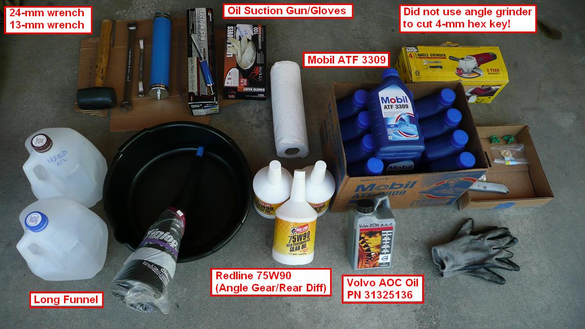

PARTS/TOOLS
- ATF is Mobil 3309, case of 12 for ~ $70 on Amazon
- I have been using Redline 75W90 for a long time in my BMW Rear Diff without any issues. It is a very good fluid. This is why I use this in the XC90 Angle Gear (which is basically similar to a diff) and Rear Diff.
- Angle Gear: I removed about 600 mL, you can use Volvo oil (see chart), I used Redline 75W90 oil.
- AOC system: I removed about 500 mL, new PN for oil is 31325136, Volvo sells this for $18/L.
- Rear Diff: I removed about 650 mL, you can use Volvo oil (see chart), I used Redline 75W90 oil.
- Trans Cooler Green Clips: 9485149 ($7/each), qty = 2. These clips break often during removal, so best is to replace them before you get stranded!
- Trans Cooler O-rings: 988840 ($4/each), qty = 4.
- The AOC Filter PN 30787687 ($20): no need to drop exhaust/driveshaft for this job: but your best bet is to buy or make a small ratcheting wrench with 4-mm hex head that can fit in that tight space (see photo). The space is about 32mm, yes it is tight! All stores were closed and I didn’t know where to buy the ratcheting wrench with 4-mm hex head, therefore I improvised with drift + hammer, worked well, read on.
- 24-mm wrench
- 13-mm socket with swivel, Iron Pipe for added leverage
- Long Funnel ($4 at local autoparts store)

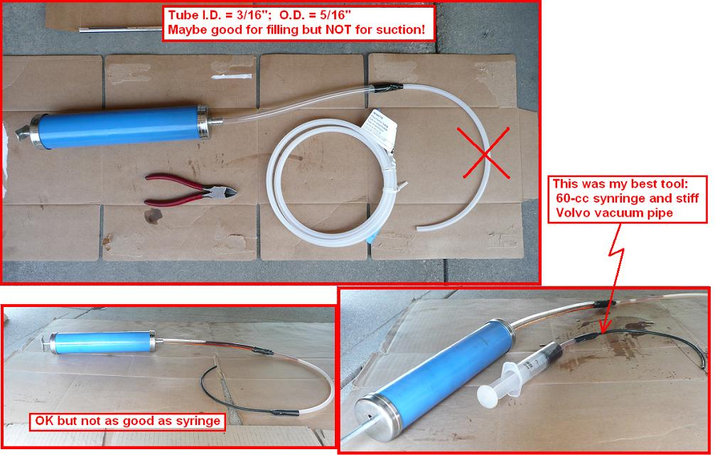

- The Oil Suction Gun is fine for filling up fluids but it is not very good at sucking old fluid out. So I used a 60-cc syringe and the stiff Volvo vacuum line I have lying round the garage. It is slow with the syringe but for something I do once every 8-10 years, this is fine. You can also use oil evacuation tool (Pella etc.).
- I re-used all crush washers, just make sure they go back in the same orientation. The little indentation (created by tightening the bolt) on the washer faces the bolt.

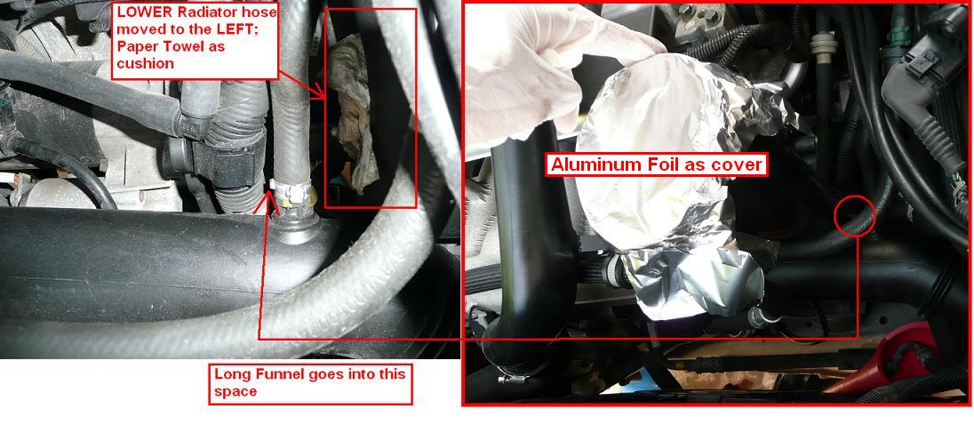

2. Study the ATF flow, basically AT ---> LOWER line ---> Through Cooler ---> UPPER Line ---> Another Cooler in Front ---> Back to AT.
Some people flush from the UPPER Radiator Port, I find it easier to flush from the disconnected LOWER Cooler Hose.
3. Drain ATF (24-mm wrench), clean the drain bolts, then tighten it snug, no need to over-tightening it.
4. Remove Air Duct (8-mm bolts). The dipstick is hidden directly below the area as shown, it is held down by a metal clip, simply slide the clip out a bit to remove the dipstick. To make it easier, move the LOWER radiator hose to the left (I use a piece of paper towel as a cushion to protect the hose from the plastic clip).
You will see a narrow opening where you can slide the long funnel down to insert into the dipstick housing to fill with ATF.
5. The LOWER Cooler line is shown: to d/c from Radiator, simply squeeze on the clips, rotate the line a bit to undo the bond, then slide it out.
- For the old Green Clips, use a pair of pliers to cut it off, then slide new clip in. The O-rings: use small flat screwdriver to remove old O-rings, then install new O-rings. Wet the O-rings with a bit of ATF before insertion.
- To drain, I simply place the disconnected LOWER cooler line into a Funnel with an Oil Pan underneath to catch old fluid. Note the dark ATF being drained.

- Add fresh ATF 2-3 qts each time, start engine and run until bubbles comes out of the disconnected LOWER cooler line.
- I worked outside, so avoid area under trees, you don’t want any debris, however small, in the trans! I used Aluminum foil to cover the funnel when not in use. The bottom line is: remove the Aluminum foil only to add fluid, then cover it immediately. A small leaf or some flies/bugs can cause problem for the trans!
- Save 4qts for FINAL Fill! During Final Fill: re-install the cooler lines with new Green clips, O-rings. Then add about 3.5 qts of ATF.

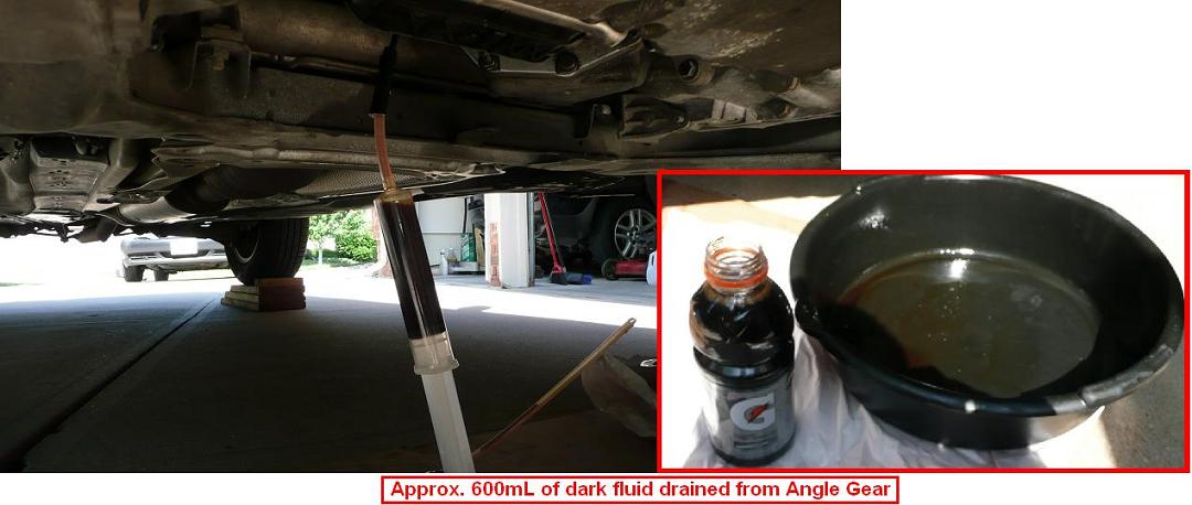

Angle Gear Fluid
1. My Angle Gear needs a reseal job, but the leak is minor, only slightly wet around the casing, no oil on garage floor, so I skip the resealing job for later.
2. I used 13-mm socket + swivel +ratchet + Iron Pipe. Old fluid was dark.

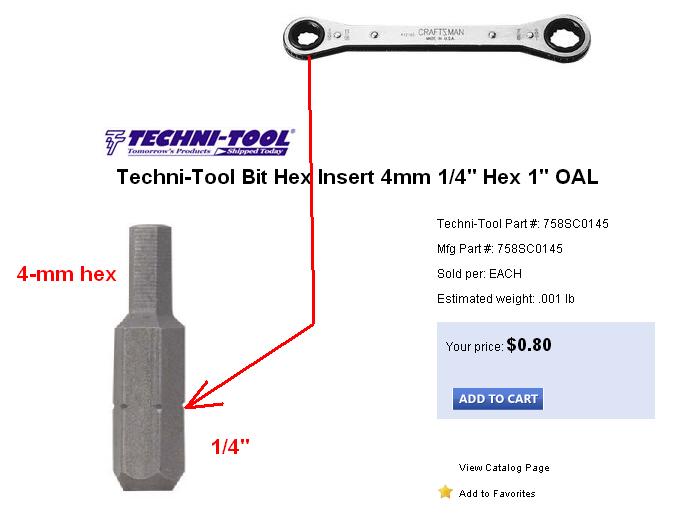

1. The Filter is a challenge because I don’t have the 4-mm ratcheting tool. Do a google search on “4-mm ratcheting tool”, and you should find something that fits in that tight space.
2. I improvised and used a drift + hammer to work the 4-mm hex bolts loose. Hit the bolt in such a way that makes it go counter-clockwise. Mark with Sharpie so you know it has turned! Then use long needle-nose pliers to undo the bolts.
3. Note the old AOC filter with 82K: it is dark, time to be replaced. Since I didn’t have the “4-mm ratcheting tool”, I had to re-use the old plate b/c the new plate design does not allow me to use the long needle-nose pliers to tighten the bolts.

I forgot to mention that some people used the I.D. 1/4" soft hose and during insertion for suction, the hose may be damaged by the internal gear ---> lost inside the Angle Gear, AOC or Rear Diff.
This is why I used the stiff Volvo Vacuum hose (same as the stiff hose used for SAS or cruise control system) together with the 60-cc syringe, this combination worked perfect.
PS: I think I found the solution for the difficult AOC Filter bolts. A 4-mm hex bit that fits a 1/4-inch ratcheting tool, see photo. Not that I need it now (I already did my AOC Filter) but this is for future readers...
I went to the basement and just found drill bits set I bought years ago, the set with different bits (Phillips, Torx, Hex etc.). I already have the 1/4-inch ratcheting wrench and just found out the 5/32-inch hex bit fits the 4-mm bolts on the AOC filter perfectly! I wished I found this drill bits set yesterday, it'd have made my life easier!!!

On the issue of suction pump, you can look up "Pela", "Motive" etc. etc. For most of us who don't fix cars for a living and perform this job once every 10 years, you have 2 "minimalist" options:
1. The syringe method as I mentioned:
* 60-cc syringe + clear tubing with I.D. = 3/16"; O.D. = 5/16" + Volvo stiff vacuum line.
Wit this setup, you don't even need to tape the connections. It is a "tight-fit" system.
* When done, clean it with water/soap and let it dry before next use (10 years from now...lol).
* Actually I now like this syringe combo because I can change oil in my lawn mower w/o removing the drain plug (a pain!), removing brake fluid before a flush, changing PS fluid etc. It is a small device but very clean, once done, you have no container to clean!
* The only downside is the slowness, so while you suck the fluid out, just close your eyes and think about the beach in Bahamas etc. lol...

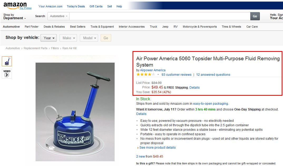

2. I have also heard good things about "Air Power America 5060" $50 on amazon.
So, if anyone has this device, please comment:
Whatever suction device, you will need to use the Volvo stiff vacuum line to access the very tight space inside the Angle Gear, AOC and Rear Diff.
