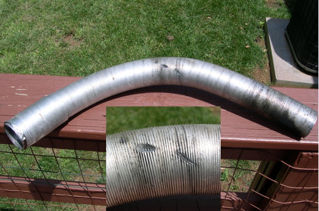

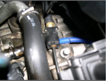

I thought this whirring noise I had was some sort of harmonic that inline sixes produce, since others have mentioned it in the forums too. But then I noticed that people where saying it happened at different RPMs than mine, and you'd think a natural harmonic would be produced at the same oscillation/frequency. So I started poking around and discovered that there's a pipe that goes from a heat shield over the exhaust manifold (near where O2 sensors go) that runs into the air box -- and now I also know why my Volvo warms up so fast in the winter. Well, in one place it was touching the block. So I tied it down with steel wire to the lower radiator hose, being careful to wrap wire around metal part and not rubber. Took it for a test drive, whirring noise is finally gone!
I can't believe the problem was so stupid and the fix so simple. I'm attaching pics for reference.

Well, got 90% of the whirring anyways. Still a little ~1850-1900 RPM, but was like from 1800-2500 RPMs before, so I'm pretty sure that corrugated aluminum tube is the source. I'm gonna try a couple hose clamps tomorrow to dampen the vibrations some more and hopefully that'll make the fix 100% effective.
And if that doesn't work I might just remove the tube entirely. So my car warms up a little slow in the winter... I don't care, that noise was really bothering me -- sounds serious (like bearings or gears or something like that) even though it really isn't.

I don't know what the official name for this part is but I'm calling it the "Volvo guitar string". As you can see from pic the block was contacting almost dead center, where the natural harmonic is. The corrugation makes it vibrate like a guitar string. The tube and air box together act like a megaphone, amplifying the sound.
Anywho, I decided I didn't need it in there. It's not sucking exhaust gases (in the non-turbo 2.9L version anyways) just hot air from around exhaust manifold, so I don't think there's any danger. I'll keep sniffing around just to be sure.

Well, I still have the 1850-1900 whir but it's so slight I can barely hear it now. In fact, if rest of car wasn't so quiet I probably wouldn't hear it all all. So I'm keep the "Volvo engine noise amplifier" (my new name for it) out of the car permanently.
One last pic that's a little troubling. Seems that tube had been rubbing against the lower radiator hose and ate a bald spot in it. I estimate about 25% of the hose material is missing in one section. The tube also seems to have shifted positions, so I imagine if it had stayed in the same place it may very well have eaten through 50% or more of the hose and caused it to fail.
