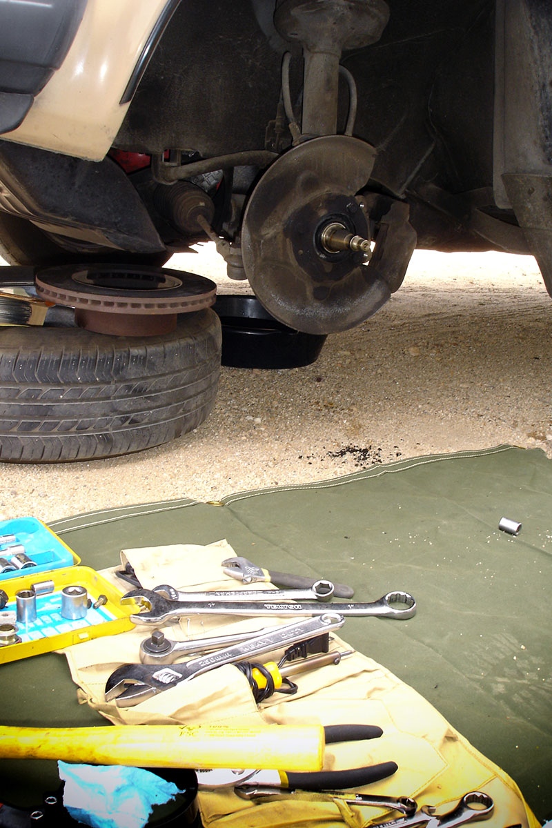

- I'm into the job but got caught out = not straight forward if unexperienced and no press to use.
Take your time. - Wheel-bearing-and-oil-change-small.jpg (252.01 KiB) Viewed 4740 times
