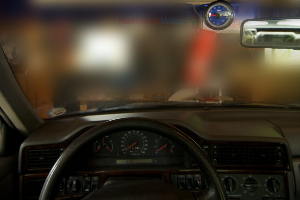

Headliner?! I know what you're thinking... why mount this in headliner?
To put it simply, it was the best place for me. I tried A-Pillar, lower-left dash, and instrument cluster, but found that headliner/rearview mirror was best. I'm tall so my eyesight is up there anyway.
I have an A-pillar gauge holder if anyone wants it.
The end result is a nice-looking, nice-functioning boost gauge that dims with the rest of my 1997 850's instrument gauges. Because it's mounted up high it's unobtrusive, and far less likely to be seen by street racers, cops or thieves. It's there when I need to know boost, and invisible to me all other times. It's slightly nearer to my field of vision than any of the other mounting positions I tried, so my eyes are on the road more.

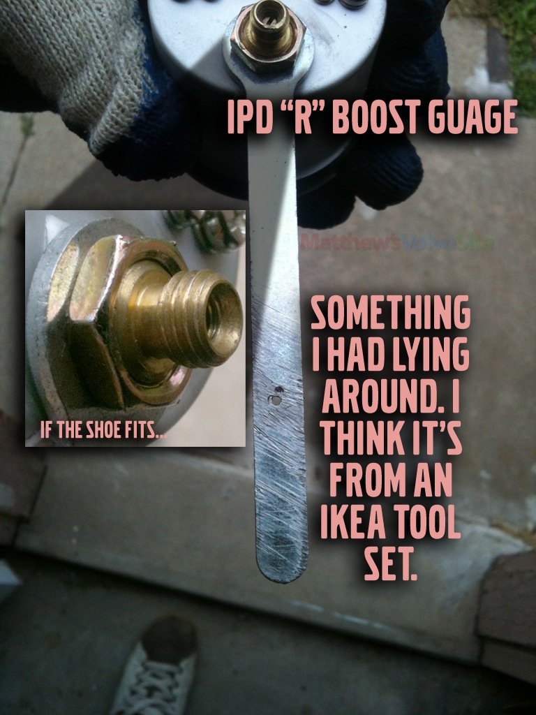

  • You need a boost gauge, either lit or unlit. If you choose an unlit one, you don't have to do any electrical wiring, but it won't be illuminated at night. I chose the iPD R Boost Gauge (link to kit).
  • Assuming you're going to do the headliner install like mine, you'll need a bracket or some random piece of metal to mount and keep the gauge where you want it.

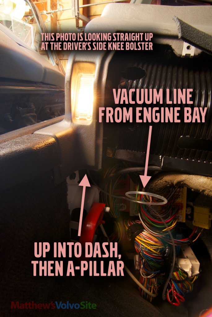

The vacuum line that comes with the iPD gauge is very generous, so I was able to go from the vacuum tree, through the firewall, up through the dash and A-pillar, and over to where you see the gauge. Really! :shock: :D It kinks easily, but that doesn't affect the reading unless the kink is not straightened out.

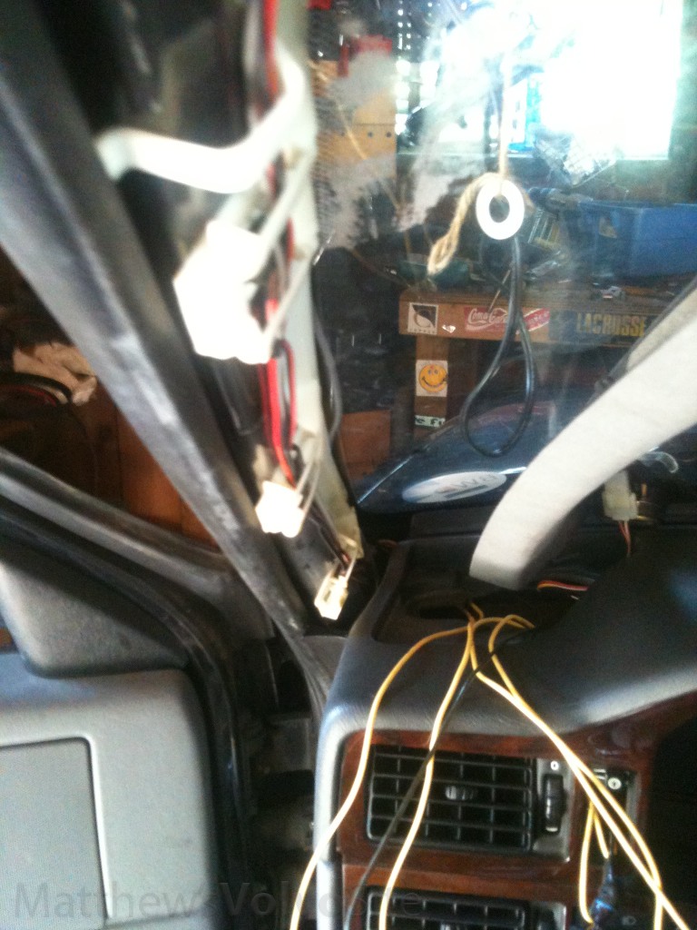

The knee bolster area of the dash has a fairly clutter-free zone that extends up to the dash speaker that lives at the base of the A-pillar. Take the grille off the speaker, then take the speaker out. Then you can run the vacuum line up to the speaker area by taping the end to a coat hanger.

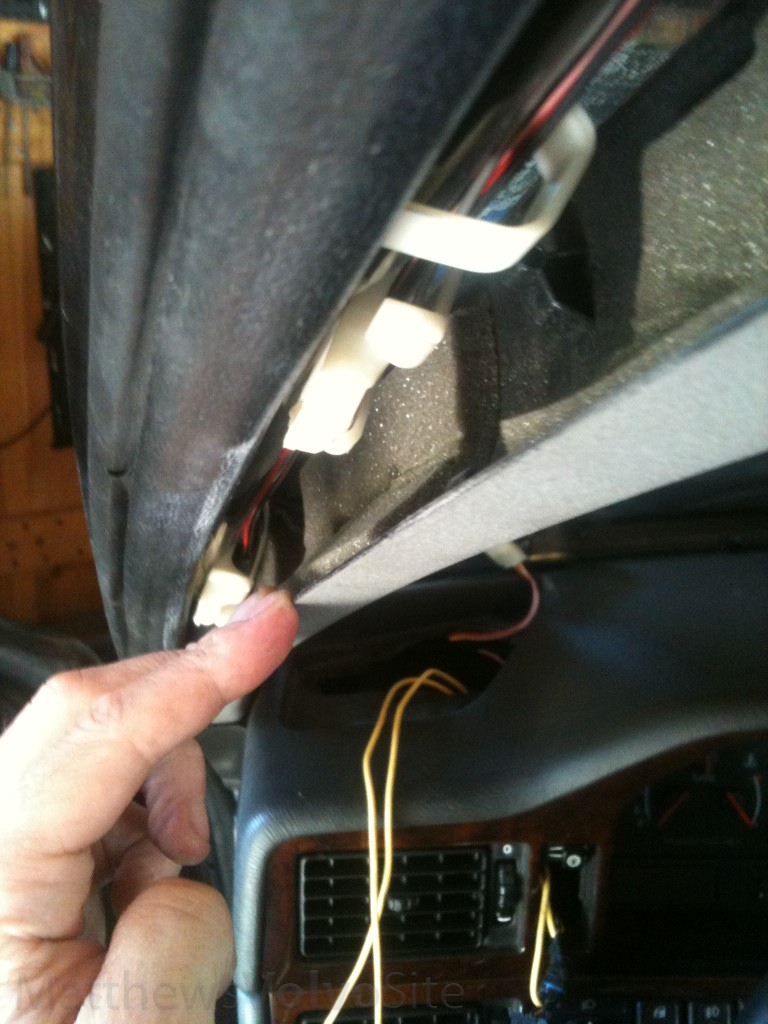

From there, the line joins the two wires from the dimmer switch, and you snake those up the A-pillar, whose trim piece comes off with gentle (or not) prying. There are U-guides inside that pillar made just for wires. Snake your three items up to the top, then out of the pillar and under the headliner. The headliner comes open with a little tenderness, just like the pillar trim.

This is where everybody will have a different method to secure the gauge to the ceiling. I just happened to rummage around until I found something that worked. I ended up bending that piece of metal in my vice grip until the flat part was level with the roof. Two bends I think. Then I simply (and carefully) put a nice dab of Gorilla Glue on the surface -- after roughing it, as seen in the photo -- and pressed it between the headliner and whatever is above it. I pressed up for about 5 minutes. So far, it's held for months, and it feels rock solid.
If you have a pre-made bracket, so much the better.

Thread the dimmer switch wiring up under the speaker hole. This is where you can use the speaker hole as an access point to continue the wires to under the A-pillar. In other words, the wires don't come up through the speaker hole.
Pry off the A-pillar trim gently. It takes some force, but start gentle. Who knows, yours might be easier than mine was.
There's the clip guides for wiring. Use em!
