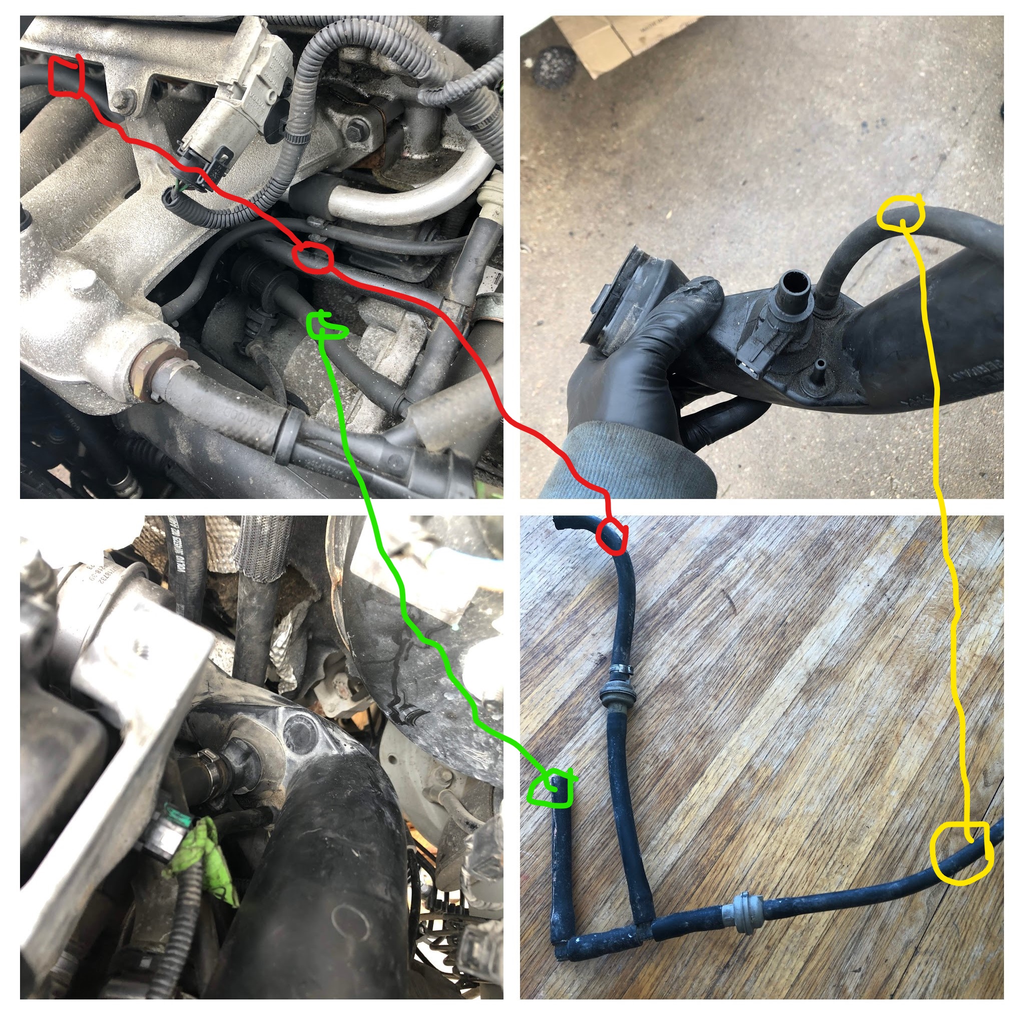

I struggled to reassemble vac hoses after engine swap. One reason for my confusion was that donor engine came from '06 XC70, but mine is a 2008 S60. I even made an extra trip to the junkyard to take pictures of vac hose routing, but it was all in vain, because it turns out Volvo modified routing for year 2008. Take a look at the attached photo collage (sorry, it's the best I could wrestle out of Google Photos). Bottom left photo is from my 2008 S60 air hose, the other three pics are from the 2006 vehicle. Bottom right is the hose I took from the junkyard before I realized it was not necessary. In the upper right pic the bottom hose bib is where turbo connects. My pencilwork on the image is not very good, but it is accurate.Hope this helps.
- Posts: 36137
- Been thanked: 4064 times
Nice use of the sketch tool across the pictures to guide the eye!!
Removing them and putting back old ones is a real fools errand - take that labor and put those parts to bed for another 10 years - for $10 worth of hose.hink I will just try diving in to dismantling and follow hoses if leak is found will check replacement part and just duck tape leak for now as it is only air leak.
