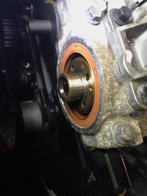

Jeez I don't know how everyone keeps these threads separate in their heads. So I read in a post somewhere that you can use the locking tool to adjust the cams. And I did just that and it worked out fine. Now I'm just trying to pinpoint the true source of my oil leak. Can't see how its the camshaft seals. There is no oil leaking from them, just oil pooled up behind them. Hard to follow the path the oil would take in there. is it being pushed out the inner edge of the seal? Meanwhile I'm expecting it to come from the outer edge of the seal? I'm attaching a picture which I hope you can see that the oil is not leaking out the outer edge of the orange seals, but its pooled up behind them. would you say that changing the seals would stop the leak?
by the way, I've already put in a new PCV breather box and made sure there was a clear path to the oil pan so there should be no pressure build up, also changed the oil pump gasket and seal, timing belt, tensioner etc. hoping these new seals will stop the leak.
Thanks!!!!
Posts: 36175
Joined: 17 Feb 2013, 17:54
Has thanked: 1614 times
Been thanked: 4078 times
You have run 26 miles of the Marathon and are wondering if you should finish!
Replace it.
