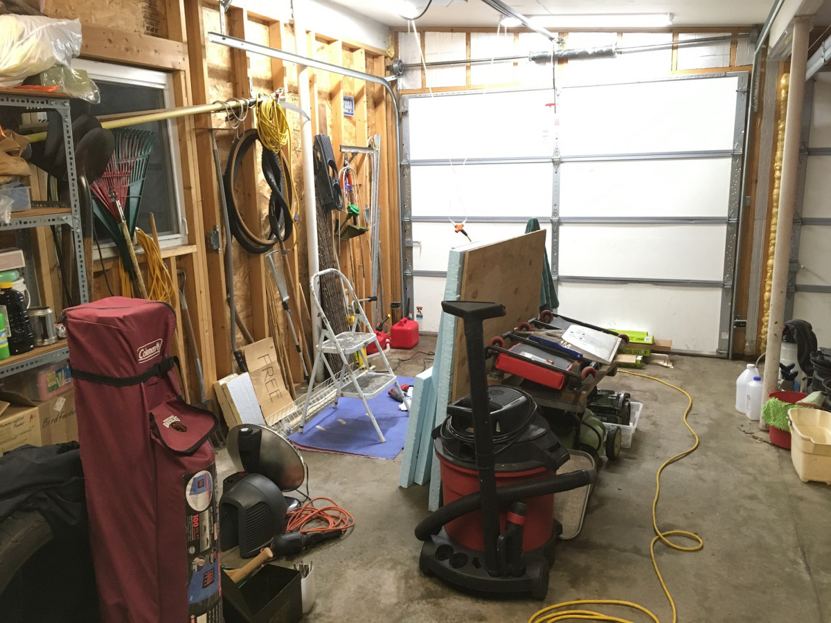

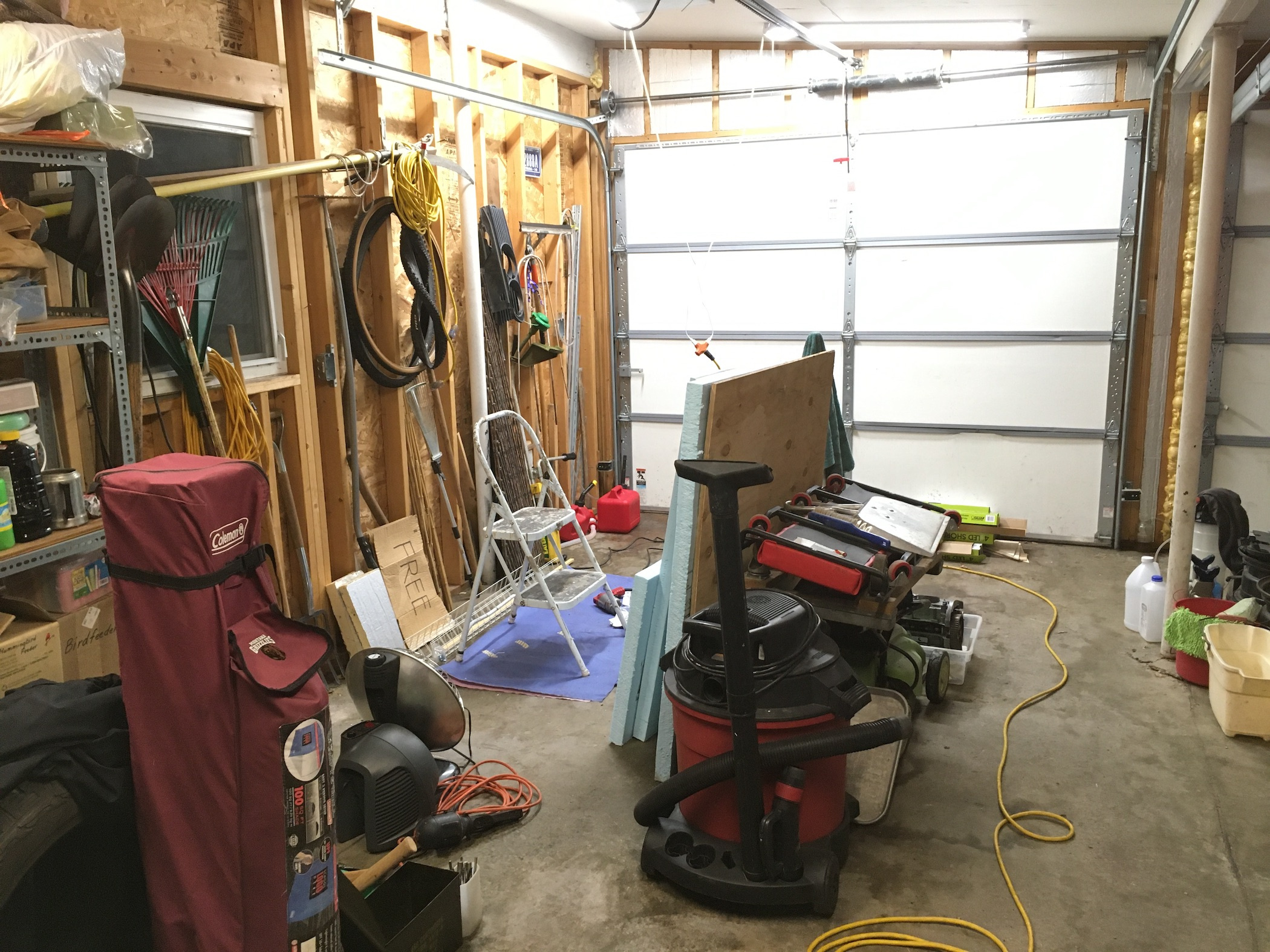

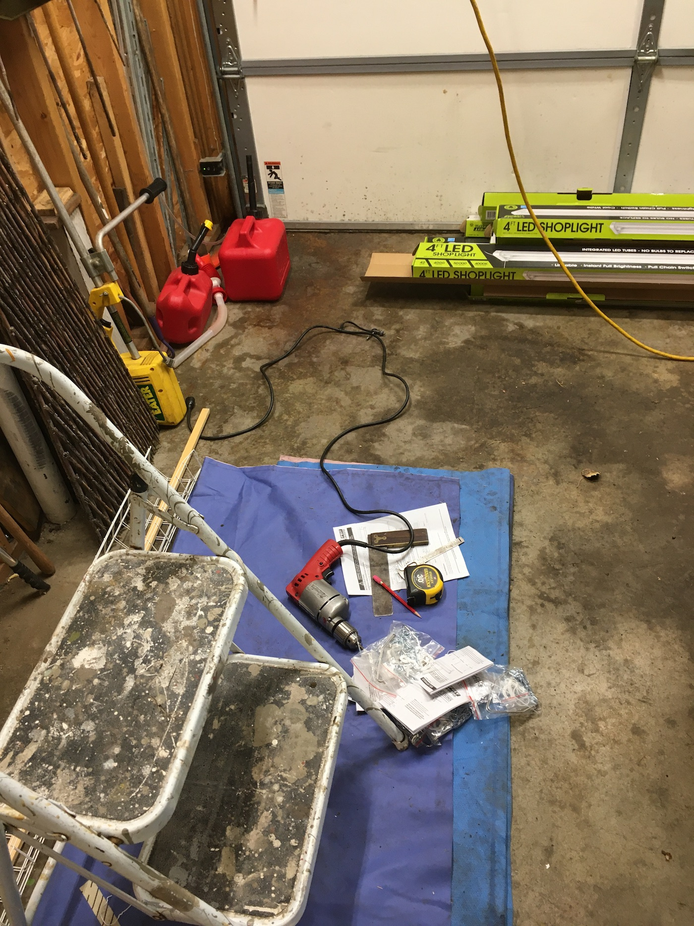

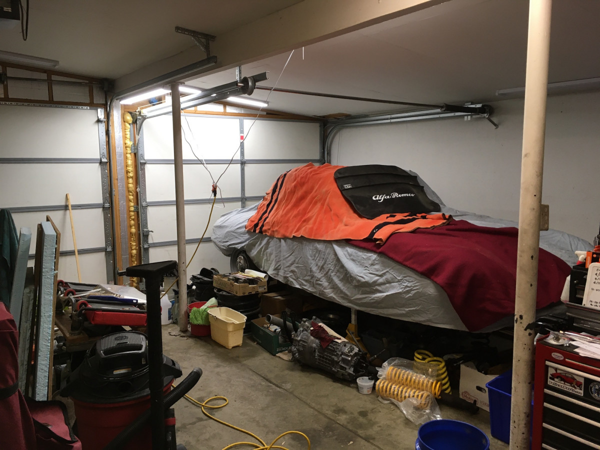

My Very Good Electrician is very picky, but things don't burn down. All of the metal outlet boxes I put up are too small - out they came. None of the brand new receptacles I brought with me from Seattle meet new codes - can't use them. All outlets and overhead light runs need to be in conduit - no Romex on this job! Heater 240 is in flex armor cable all the way to the panel. GFI outlet on each outlet circuit.
Installed fixtures and tested last night. Shopped until I was purple.....$150 fixtures, $80 fixtures, all made in China; it's hard to avoid. I settled on the $28 Costco 42W LED with good color and many good reviews. A builder friend has them in his shop with no issues.
These are with just two on them on with an extension cord. It will be bright, and they have pull chains so I can shut off the un-needed ones, and above the doors when they're open. Lights located around perimeter of cars for working. Double-checked overhead door clearance!! Insulation next.
