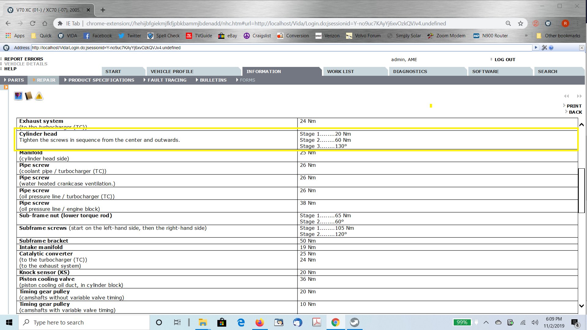

Per Volvo Vida:
Tighten the screws in sequence from the center and outwards.
Stage 1........20 Nm (15 Ft-lbs)
Stage 2........60 Nm (44 Ft-lbs)
Stage 3........130°

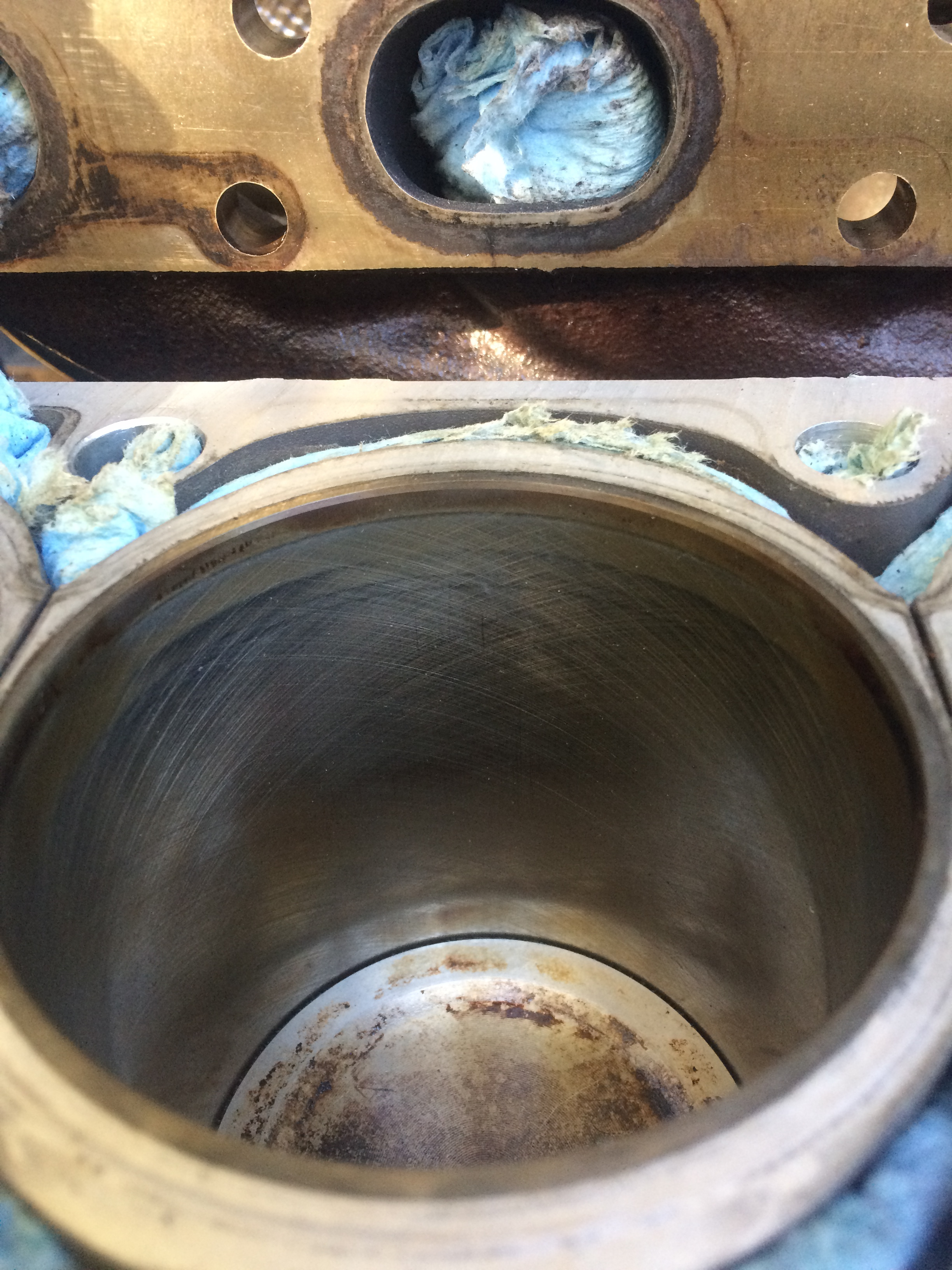

Hey does anyone know what the cross-hatching is supposed to look like on the cylinder walls? Mine are at about a 60 degree angle and almost look like scratches. I have some pictures just got to figure out how to upload them.

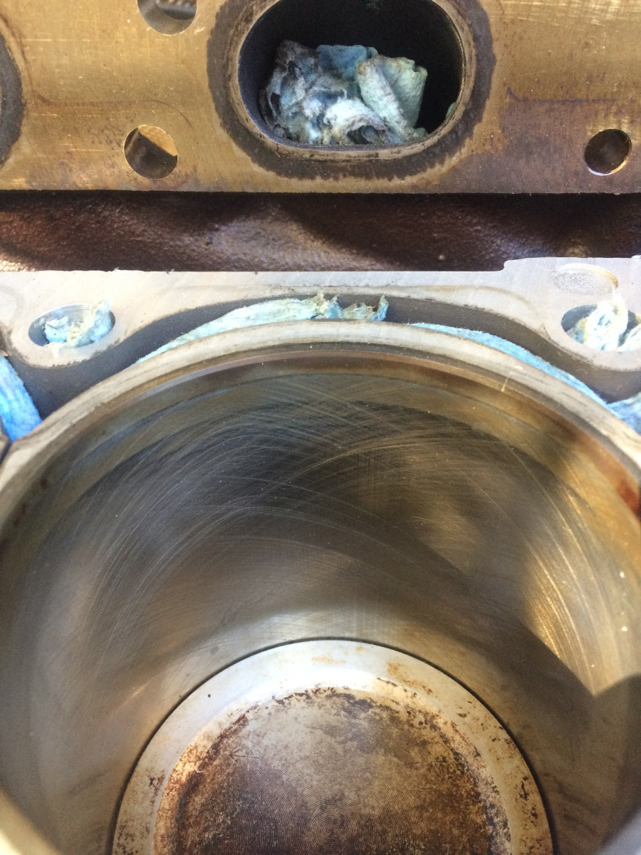

Ok here are my cylinder walls, only 100k miles on the car so I’m really hoping these aren’t scratches..
