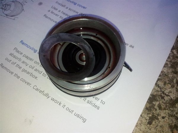

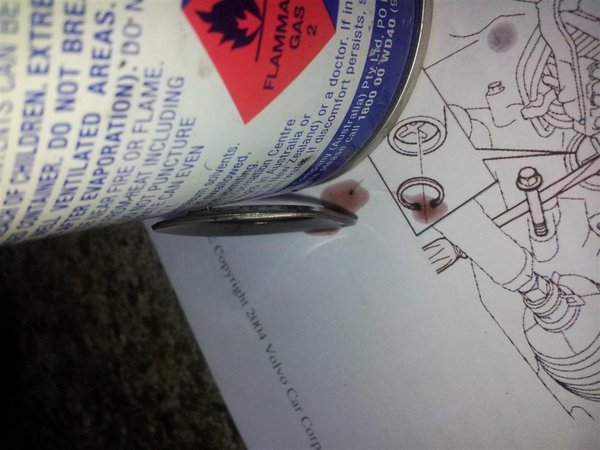

Well, I'm not sure about D&F advice in particular, but one common design flaw was a washer breaking loose under the B4 solenoid. Apparently this is limited to that range of cars, meaning if your VIN is lower or higher than that range, you will not need to do the B4 solenoid cover fix.
If you are within that range and have tranny troubles, that is a quick cheap fix and should be an early effort in repairing it.

It is a fix for CERTAIN troubles only (like those related with 2-3 shifr flare). There are quite a few other 'bugs' that the B4 Servo Cover Update by itself won't cure, and it is great that you do not have any of those.
I am glad to hear about another flawless Aisin 5-speed transmission in existence (like mine '02)

A follow up to Fazool's post, within the chassis range, the first 3 digits of the serial number on the affected transmissions are between 01C (March 2001) and 01L (December 2001).
IPD suggests a software update (regent noted above) before replacing the B4 Servo Cover. Does this replacement remedy the design flaw you point to Fazool?

We have a 2000 V70 with a 5 speed AW55-50SN transmission that was built in 2000 ( I think it was July) . The B4 servo cover was bent and we had the 2-3 shift flare problem.xHeart wrote:A follow up to Fazool's post, within the chassis range, the first 3 digits of the serial number on the affected transmissions are between 01C (March 2001) and 01L (December 2001).
We had the software update done then had the cover replaced. The trans is not perfect but seems to be adapting after a battery cable pull.
