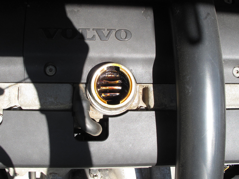

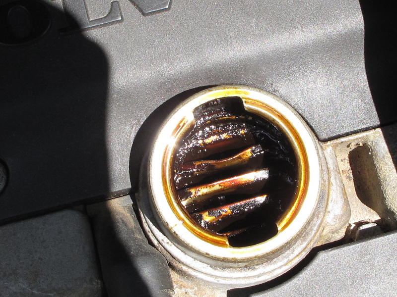

This 2001 V70XC runs great. Idles at 800rpm, quiet car. I am preparing for 2nd oil change. This time looking closer at the oil filler. Does it need cleaning?
Is the grill bent or is it by design?
How to clean out stuff without it falling in?

It is an indication that your engine has accumulated sludge inside. It would be a good idea to clean it. The oil filler condition will improve during the cleaning process. Many products are available. It may take more than one treatement and I list only a few.
Personnaly for this kind of cleaning I prefer Auto-Rx. It is not radical and it works over oil changes. You will find on this site many discussions about Seafoam. Also "Bob the oil guy" is a good site if you want to investigate the subject.

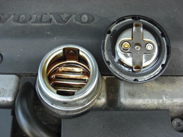

Find a picture of my oil filler. The car has 85K miles.
And the glove test to assess the state of your PCV system. A good system will pull the glove in.

To summerize,
Yours is a mess and this is not "starting", it's clogged.
I have no idea how those fins could get bent!!!

This typical for irregular oil changes. The whole engine is sludged up, not just the PCV. Chemical cleaners available have limited effect, but it's better than nothing I guess. Timing belt is due at 105K miles per book, but that's stretching it... no pun intended.

You system is really gunked up. However, regardless of the method you choose, do not let the filler area determine how well you think you've cleaned your engine as that will be to last place to come clean.
Diesel fuel whether 100% or a mixture of Diesel to Motor Oil has been the standard
