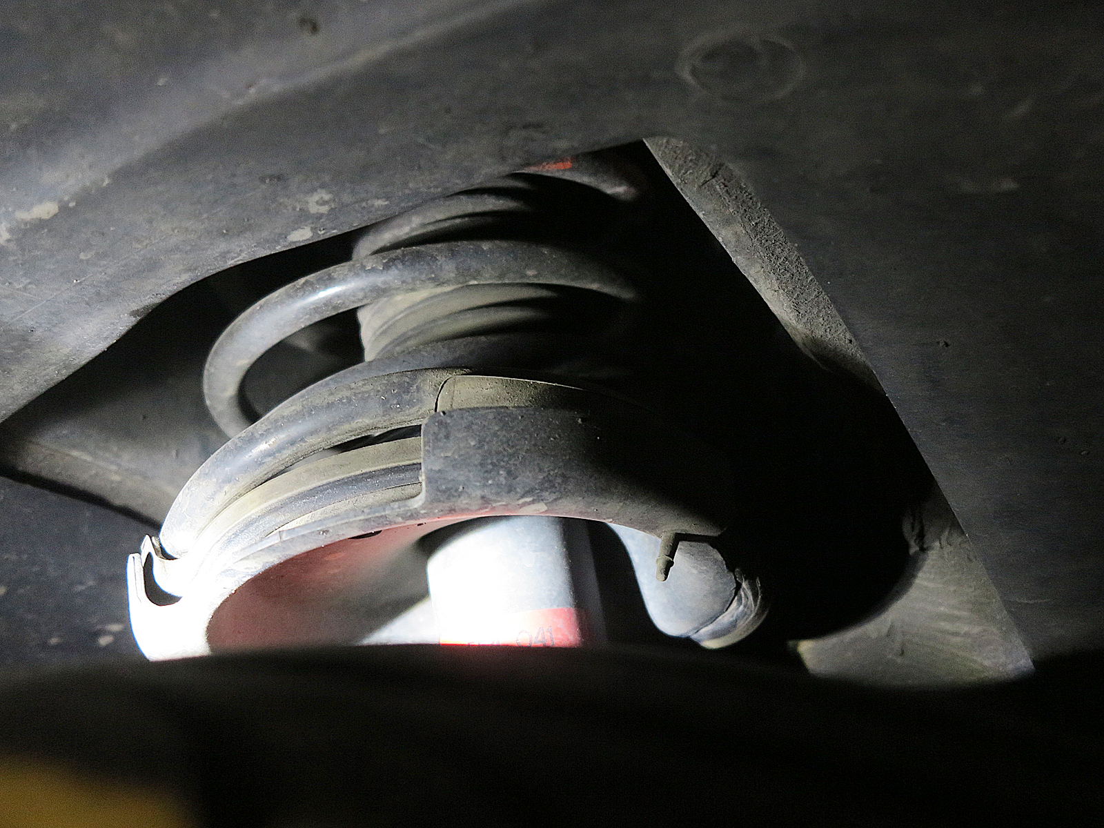

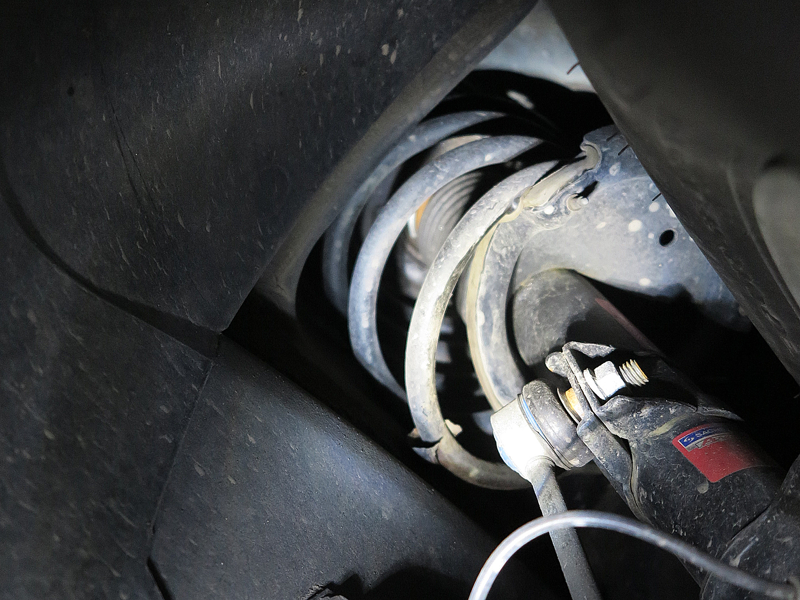

Not a good start of the week.
How damaging is it to drive off the ramp and back in the garage.
Is LESJOFORS a good replacement, Part Number: W0133-1855852... http://www.partsgeek.com/catalog/2001/volvo/v70/suspension/coil_spring.html
Else, I could go with Volvo springs.
Here are few photos...
No break for this lad!
2001 V70XC - Out of nowhere comes snapped spring

Decided on Volvo Spring PN 31200372.
Replacing it on both side.
All suspension parts were replaced Feb 2013 with OE/OEM parts – minus the spring.
What precautions are needed when taking off the strut with broken spring?
Will it force out in any way after the three nuts are removed, taking my fingers with it?
What happens when the strut is freed at the knuckle?
I will place the spring compressor before the disassembly and removing the star nut.
