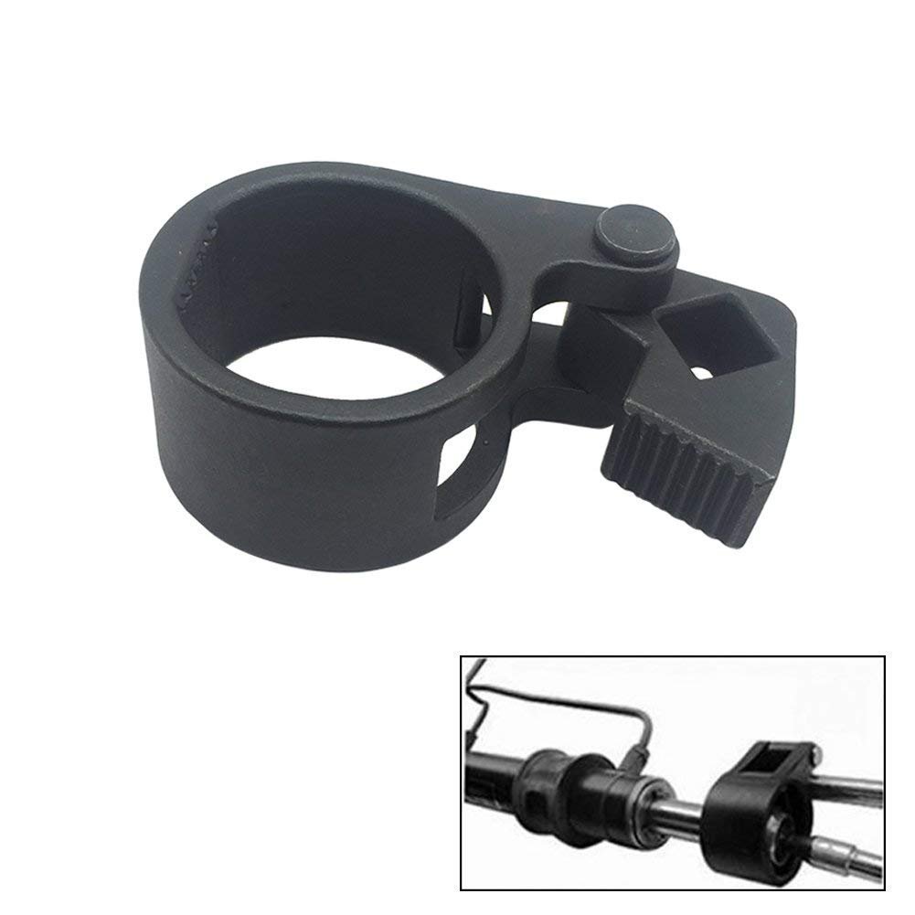

There is Lemforder with inner, outer and boots. Thank you for pointing out the tool.dlundblad wrote: 03 Feb 2019, 04:40 I've been using Lemforder a lot, but it looks like TRW is the OE part on FCP. Perhaps someone else can chime in? Don't forget the tool too.
Amazon has one too. This looks interesting but may not work. Torque is 52ft-lb.

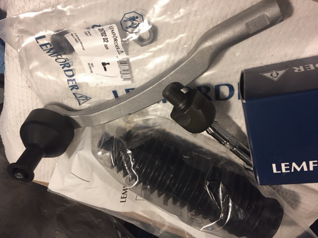

Lemförder it is. Per IPD's note, does the thread length looks right?
- Posts: 36147
Does the thread length matter? Is the hole on the rack a blind or open hole ?

Reviewing procedure for tie rod replacement. The original outer tie rod is TRW, a lot muscular than the replacement LEMFORDER -- is the material science of LEMFORDER better even though it appears significantly sculpted?

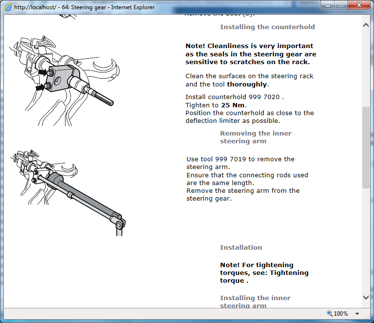

The tools are coming. VIDA instruction points to "deflection limiter" - what is it? The diagram is relative to the driver's side inner tie rod.
