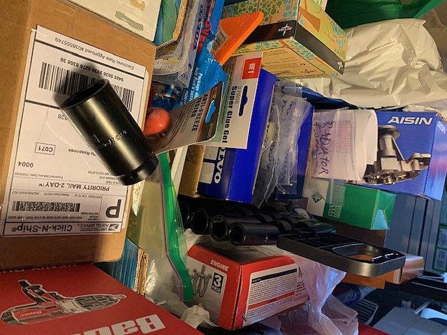

I'll complete collecting replacement parts this weekend -- exhaust vvt hub, cam seals, oil pump service kit, water pump, t-belt, s-belt, tensioners, and idler pulley -- anything missing?
My next step is collecting tools.

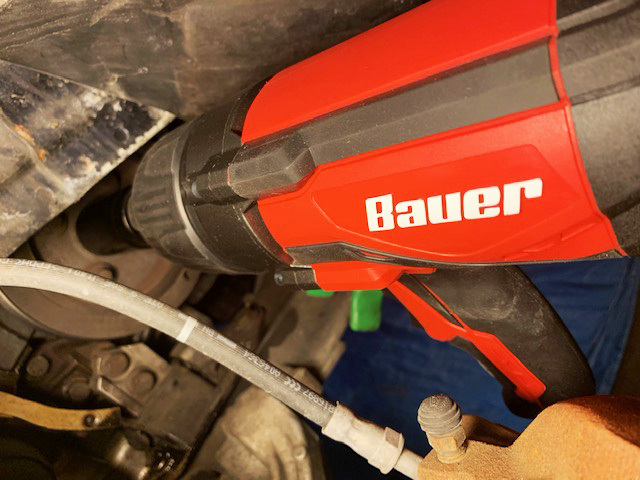

Introduced Bauer to the beast.
