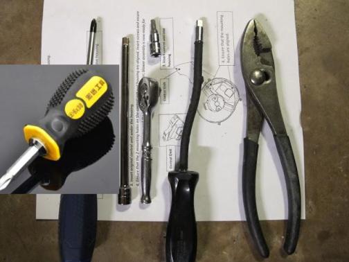

DanOrbis wrote:removing the five screws that hold the blower unit is a 5 on a scale of 1 to 5, where 5 comes with a lot of #*!!@#
This photoshop will cool it down from 5 somewhere to near 2 8)

Same here, the 5th screw rests in the tool box 8) An electric screw driver or drill helps with these screws.
