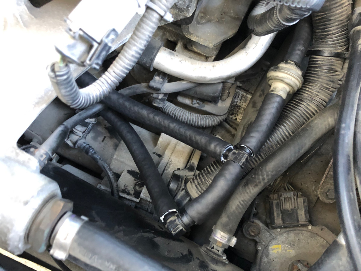

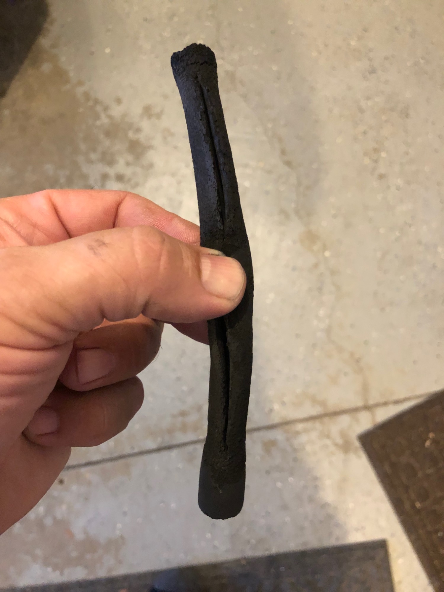

Hoping I got to the bottom of the EVAP codes on the kids 05 XC90. This hose look gone to anyone? I think the Brits refer to this as manky.
All new fitted.

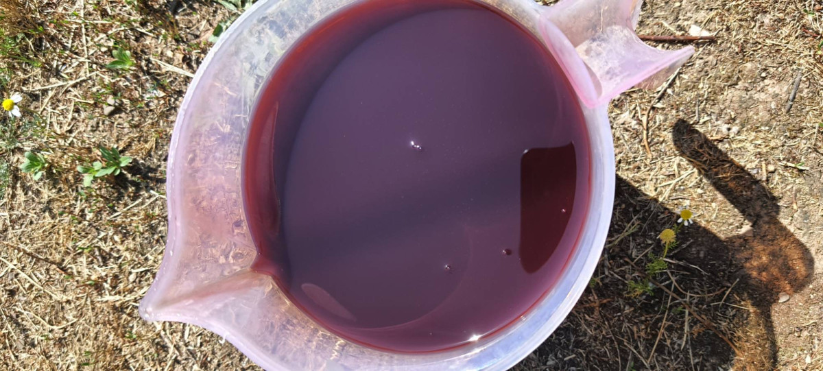

I drained 1l today to check its color and consistency and filled 1l of Ravenol. It is almost like before(I know, it doesn't look as good as it should after 30l drain and fills). In total I have done around 30 or more liters with drain and fills since i began my journey with this gearbox. As soon as I get my lubeguard today or tomorrow I will drain 3l and fill with more Ravenol and possible the whole bottle of Lubeguard(once I read the instructions)

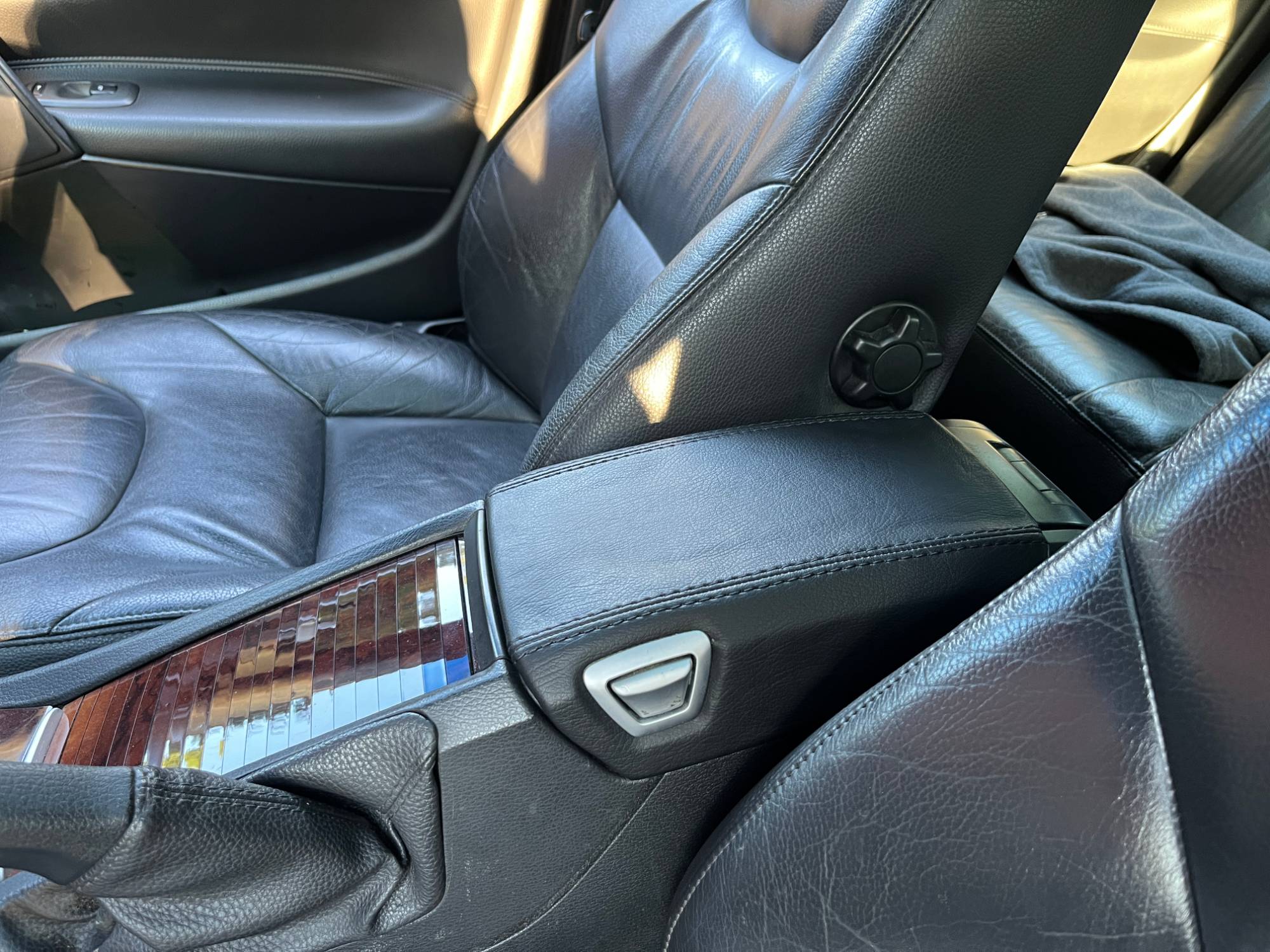

I finished installing a new center console lid cover. It took forever and I would do a few things differently next time, like using different glue. Not perfect, but worlds better looking than before.
