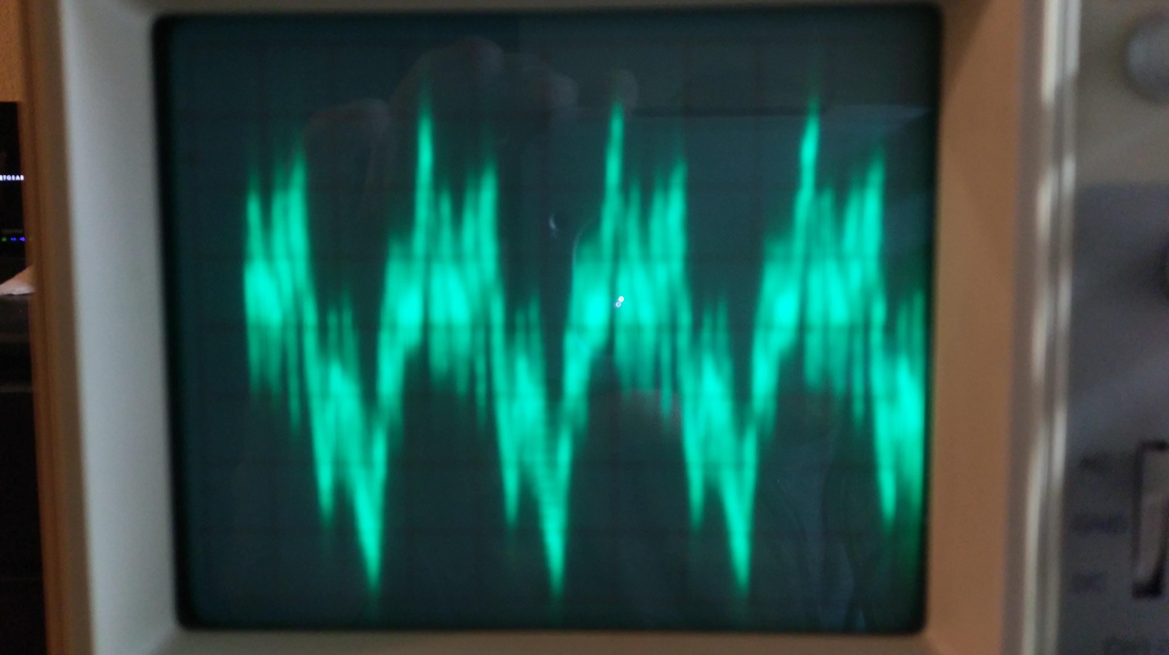

RickHaleParker wrote: 13 Apr 2021, 15:56
T5Luke wrote: 13 Apr 2021, 03:03 For me it looks like to much noise on the can bus, i dont trust this 3,3V transceivers.
Ordered some 3V - 5V CAN Transceivers based on the NXP TJA1051. Should be here next week. I'll run them at 5V and see if it makes a difference. Will post the log with no other changes in test conditions.
No change in results.
What CAN transceivers are the rest of you using and how is the performance?
When the weather warms up. I'll go to the local yard and get some CEMs so I can do bench testing.
Did check the 5V line for noise. It only 40 mv PP. That is less then 0.8%.
Vertical 5mv/ division. Cycle repetition time 1.35 ms.

0: 89 = 263155
1: 61 = 263151
2: 97 = 263094
3: 91 = 263091
4: 85 = 263081
5: 65 = 263065
6: 49 = 263054
7: 93 = 263039
8: 47 = 263028
9: 43 = 263011
10: 71 = 263009
11: 79 = 262998
12: 99 = 262993
13: 75 = 262991
14: 87 = 262986
15: 55 = 262962
16: 59 = 262947
17: 67 = 262945
18: 53 = 262942
19: 45 = 262937
20: 73 = 262937
21: 63 = 262929
22: 57 = 262917
23: 77 = 262908
24: 51 = 262879
pin[1] candidate: 89 with latency 263155
Warning: Selected candidate is very close to the next candidate!
         Selection may be incorrect.
[ 68 89 00 -- -- -- ]: 000 000 000 000 000 046 924 084 1381 043 522 000 000 000 000 : 263017
[ 68 89 01 -- -- -- ]: 000 000 000 000 000 047 710 090 1261 066 826 000 000 000 000 : 264067
[ 68 89 02 -- -- -- ]: 000 000 000 000 000 040 660 091 1300 053 856 000 000 000 000 : 264234
[ 68 89 03 -- -- -- ]: 000 000 000 000 000 045 670 088 1307 048 842 000 000 000 000 : 264169
[ 68 89 04 -- -- -- ]: 000 000 000 000 000 038 647 090 1340 067 818 000 000 000 000 : 264205
[ 68 89 05 -- -- -- ]: 000 000 000 000 000 040 653 084 1305 059 859 000 000 000 000 : 264267
[ 68 89 06 -- -- -- ]: 000 000 000 000 000 043 652 090 1353 053 809 000 000 000 000 : 264148
[ 68 89 07 -- -- -- ]: 000 000 000 000 000 042 742 089 1297 044 786 000 000 000 000 : 263917
[ 68 89 08 -- -- -- ]: 000 000 000 000 000 055 697 092 1374 043 739 000 000 000 000 : 263870
[ 68 89 09 -- -- -- ]: 000 000 000 000 000 043 641 095 1291 051 879 000 000 000 000 : 264303
[ 68 89 10 -- -- -- ]: 000 000 000 000 000 048 836 094 1208 052 762 000 000 000 000 : 263666
[ 68 89 11 -- -- -- ]: 000 000 000 000 000 049 780 081 1248 062 780 000 000 000 000 : 263834
[ 68 89 12 -- -- -- ]: 000 000 000 000 000 044 745 086 1238 058 829 000 000 000 000 : 264008
[ 68 89 13 -- -- -- ]: 000 000 000 000 000 047 750 087 1246 051 819 000 000 000 000 : 263961
[ 68 89 14 -- -- -- ]: 000 000 000 000 000 054 777 082 1258 055 774 000 000 000 000 : 263805
[ 68 89 15 -- -- -- ]: 000 000 000 000 000 044 769 092 1225 051 819 000 000 000 000 : 263927
[ 68 89 16 -- -- -- ]: 000 000 000 000 000 058 772 074 1257 051 788 000 000 000 000 : 263835
[ 68 89 17 -- -- -- ]: 000 000 000 000 000 047 765 080 1191 070 847 000 000 000 000 : 264013
[ 68 89 18 -- -- -- ]: 000 000 000 000 000 057 733 086 1286 060 778 000 000 000 000 : 263893
[ 68 89 19 -- -- -- ]: 000 000 000 000 000 044 750 090 1250 051 815 000 000 000 000 : 263959
[ 68 89 20 -- -- -- ]: 000 000 000 000 000 034 675 106 1281 060 844 000 000 000 000 : 264190
[ 68 89 21 -- -- -- ]: 000 000 000 000 000 058 761 075 1258 049 799 000 000 000 000 : 263876
[ 68 89 22 -- -- -- ]: 000 000 000 000 000 049 805 084 1219 061 782 000 000 000 000 : 263784
[ 68 89 23 -- -- -- ]: 000 000 000 000 000 050 767 083 1264 054 782 000 000 000 000 : 263851
[ 68 89 24 -- -- -- ]: 000 000 000 000 000 062 801 064 1258 056 759 000 000 000 000 : 263722
[ 68 89 25 -- -- -- ]: 000 000 000 000 000 044 768 082 1250 063 793 000 000 000 000 : 263899
[ 68 89 26 -- -- -- ]: 000 000 000 000 000 045 788 098 1223 055 791 000 000 000 000 : 263828
[ 68 89 27 -- -- -- ]: 000 000 000 000 000 036 802 086 1197 053 826 000 000 000 000 : 263907
[ 68 89 28 -- -- -- ]: 000 000 000 000 000 055 816 073 1238 058 760 000 000 000 000 : 263708
[ 68 89 29 -- -- -- ]: 000 000 000 000 000 047 789 081 1245 064 774 000 000 000 000 : 263812
[ 68 89 30 -- -- -- ]: 000 000 000 000 000 042 829 069 1231 054 775 000 000 000 000 : 263751
[ 68 89 31 -- -- -- ]: 000 000 000 000 000 053 766 087 1235 052 807 000 000 000 000 : 263888
[ 68 89 32 -- -- -- ]: 000 000 000 000 000 065 762 075 1242 058 798 000 000 000 000 : 263860
[ 68 89 33 -- -- -- ]: 000 000 000 000 000 054 776 084 1221 058 807 000 000 000 000 : 263874
[ 68 89 34 -- -- -- ]: 000 000 000 000 000 045 764 087 1247 052 805 000 000 000 000 : 263912
[ 68 89 35 -- -- -- ]: 000 000 000 000 000 051 752 085 1242 061 809 000 000 000 000 : 263937
[ 68 89 36 -- -- -- ]: 000 000 000 000 000 053 759 084 1206 051 847 000 000 000 000 : 263984
[ 68 89 37 -- -- -- ]: 000 000 000 000 000 055 764 086 1274 050 771 000 000 000 000 : 263813
[ 68 89 38 -- -- -- ]: 000 000 000 000 000 057 785 075 1232 068 783 000 000 000 000 : 263818
[ 68 89 39 -- -- -- ]: 000 000 000 000 000 062 750 081 1217 048 842 000 000 000 000 : 263965
[ 68 89 40 -- -- -- ]: 000 000 000 000 000 048 651 081 1290 054 876 000 000 000 000 : 264279
[ 68 89 41 -- -- -- ]: 000 000 000 000 000 043 693 106 1283 047 828 000 000 000 000 : 264082
[ 68 89 42 -- -- -- ]: 000 000 000 000 000 052 761 082 1261 054 790 000 000 000 000 : 263874
[ 68 89 43 -- -- -- ]: 000 000 000 000 000 050 773 078 1210 062 827 000 000 000 000 : 263942
[ 68 89 44 -- -- -- ]: 000 000 000 000 000 050 777 085 1253 059 776 000 000 000 000 : 263822
[ 68 89 45 -- -- -- ]: 000 000 000 000 000 052 768 078 1236 071 795 000 000 000 000 : 263891
[ 68 89 46 -- -- -- ]: 000 000 000 000 000 045 764 086 1232 048 825 000 000 000 000 : 263949
[ 68 89 47 -- -- -- ]: 000 000 000 000 000 045 768 096 1263 054 774 000 000 000 000 : 263835
[ 68 89 48 -- -- -- ]: 000 000 000 000 000 052 764 084 1241 048 811 000 000 000 000 : 263902
[ 68 89 49 -- -- -- ]: 000 000 000 000 000 056 793 085 1264 037 765 000 000 000 000 : 263728
[ 68 89 50 -- -- -- ]: 000 000 000 000 000 049 806 086 1298 053 708 000 000 000 000 : 263624
[ 68 89 51 -- -- -- ]: 000 000 000 000 000 045 765 098 1220 054 818 000 000 000 000 : 263927
[ 68 89 52 -- -- -- ]: 000 000 000 000 000 045 795 077 1180 058 845 000 000 000 000 : 263946
[ 68 89 53 -- -- -- ]: 000 000 000 000 000 057 805 078 1250 055 755 000 000 000 000 : 263706
[ 68 89 54 -- -- -- ]: 000 000 000 000 000 051 779 076 1252 055 787 000 000 000 000 : 263842
[ 68 89 55 -- -- -- ]: 000 000 000 000 000 055 746 080 1232 056 831 000 000 000 000 : 263981
[ 68 89 56 -- -- -- ]: 000 000 000 000 000 041 777 083 1196 064 839 000 000 000 000 : 263982
[ 68 89 57 -- -- -- ]: 000 000 000 000 000 055 787 080 1222 055 801 000 000 000 000 : 263838
[ 68 89 58 -- -- -- ]: 000 000 000 000 000 050 814 077 1288 055 716 000 000 000 000 : 263632
[ 68 89 59 -- -- -- ]: 000 000 000 000 000 042 753 083 1236 065 821 000 000 000 000 : 263992
[ 68 89 60 -- -- -- ]: 000 000 000 000 000 051 641 087 1294 061 866 000 000 000 000 : 264271
[ 68 89 61 -- -- -- ]: 000 000 000 000 000 048 755 089 1191 064 853 000 000 000 000 : 264027
[ 68 89 62 -- -- -- ]: 000 000 000 000 000 055 769 080 1228 056 812 000 000 000 000 : 263897
[ 68 89 63 -- -- -- ]: 000 000 000 000 000 051 756 066 1248 062 817 000 000 000 000 : 263965
[ 68 89 64 -- -- -- ]: 000 000 000 000 000 054 759 082 1243 051 811 000 000 000 000 : 263911
[ 68 89 65 -- -- -- ]: 000 000 000 000 000 047 825 076 1210 047 795 000 000 000 000 : 263770
[ 68 89 66 -- -- -- ]: 000 000 000 000 000 049 753 068 1254 061 815 000 000 000 000 : 263970
[ 68 89 67 -- -- -- ]: 000 000 000 000 000 046 775 083 1223 059 814 000 000 000 000 : 263916
[ 68 89 68 -- -- -- ]: 000 000 000 000 000 049 809 084 1241 053 764 000 000 000 000 : 263732
[ 68 89 69 -- -- -- ]: 000 000 000 000 000 052 783 086 1186 056 837 000 000 000 000 : 263922
[ 68 89 70 -- -- -- ]: 000 000 000 000 000 052 864 089 1260 041 694 000 000 000 000 : 263456
[ 68 89 71 -- -- -- ]: 000 000 000 000 000 049 757 089 1246 051 808 000 000 000 000 : 263917
[ 68 89 72 -- -- -- ]: 000 000 000 000 000 043 722 089 1280 069 797 000 000 000 000 : 264001
[ 68 89 73 -- -- -- ]: 000 000 000 000 000 049 767 092 1229 054 809 000 000 000 000 : 263899
[ 68 89 74 -- -- -- ]: 000 000 000 000 000 040 815 093 1222 057 773 000 000 000 000 : 263760
[ 68 89 75 -- -- -- ]: 000 000 000 000 000 053 764 075 1221 055 832 000 000 000 000 : 263957
[ 68 89 76 -- -- -- ]: 000 000 000 000 000 053 761 083 1243 054 806 000 000 000 000 : 263902
[ 68 89 77 -- -- -- ]: 000 000 000 000 000 054 800 081 1252 049 764 000 000 000 000 : 263734
[ 68 89 78 -- -- -- ]: 000 000 000 000 000 053 810 083 1199 054 801 000 000 000 000 : 263794
[ 68 89 79 -- -- -- ]: 000 000 000 000 000 065 786 072 1233 053 791 000 000 000 000 : 263796
[ 68 89 80 -- -- -- ]: 000 000 000 000 000 045 692 079 1307 063 814 000 000 000 000 : 264093
[ 68 89 81 -- -- -- ]: 000 000 000 000 000 038 673 091 1273 053 872 000 000 000 000 : 264246
[ 68 89 82 -- -- -- ]: 000 000 000 000 000 049 670 093 1289 061 838 000 000 000 000 : 264157
[ 68 89 83 -- -- -- ]: 000 000 000 000 000 055 729 084 1343 052 737 000 000 000 000 : 263819
[ 68 89 84 -- -- -- ]: 000 000 000 000 000 061 755 085 1249 052 798 000 000 000 000 : 263870
[ 68 89 85 -- -- -- ]: 000 000 000 000 000 059 758 070 1246 058 809 000 000 000 000 : 263913
[ 68 89 86 -- -- -- ]: 000 000 000 000 000 056 802 075 1241 057 769 000 000 000 000 : 263748
[ 68 89 87 -- -- -- ]: 000 000 000 000 000 045 771 082 1243 062 797 000 000 000 000 : 263897
[ 68 89 88 -- -- -- ]: 000 000 000 000 000 053 792 081 1249 053 772 000 000 000 000 : 263773
[ 68 89 89 -- -- -- ]: 000 000 000 000 000 057 771 089 1198 050 835 000 000 000 000 : 263918
[ 68 89 90 -- -- -- ]: 000 000 000 000 000 051 838 086 1228 044 753 000 000 000 000 : 263635
[ 68 89 91 -- -- -- ]: 000 000 000 000 000 053 795 086 1230 049 787 000 000 000 000 : 263788
[ 68 89 92 -- -- -- ]: 000 000 000 000 000 059 757 083 1219 047 835 000 000 000 000 : 263943
[ 68 89 93 -- -- -- ]: 000 000 000 000 000 055 767 081 1214 044 839 000 000 000 000 : 263942
[ 68 89 94 -- -- -- ]: 000 000 000 000 000 063 796 078 1211 060 792 000 000 000 000 : 263785
[ 68 89 95 -- -- -- ]: 000 000 000 000 000 051 781 092 1193 055 828 000 000 000 000 : 263904
[ 68 89 96 -- -- -- ]: 000 000 000 000 000 061 759 075 1246 054 805 000 000 000 000 : 263888
[ 68 89 97 -- -- -- ]: 000 000 000 000 000 047 780 097 1223 062 791 000 000 000 000 : 263846
[ 68 89 98 -- -- -- ]: 000 000 000 000 000 045 762 079 1208 060 846 000 000 000 000 : 264014
[ 68 89 99 -- -- -- ]: 000 000 000 000 000 045 792 090 1236 045 792 000 000 000 000 : 263820
0: 09 = 264303
1: 40 = 264279
2: 60 = 264271
3: 05 = 264267
4: 81 = 264246
5: 02 = 264234
6: 04 = 264205
7: 20 = 264190
8: 03 = 264169
9: 82 = 264157
10: 06 = 264148
11: 80 = 264093
12: 41 = 264082
13: 01 = 264067
14: 61 = 264027
15: 98 = 264014
16: 17 = 264013
17: 12 = 264008
18: 72 = 264001
19: 59 = 263992
20: 36 = 263984
21: 56 = 263982
22: 55 = 263981
23: 66 = 263970
24: 39 = 263965
pin[2] candidate: 09 with latency 264303
Candidate PIN 0x68 0x89 0x09 -- -- -- : brute forcing bytes 3 to 5 (3 bytes), will take up to 658 seconds
Progress: 0%..5%..10%..15%..20%..25%..30%..35%..40%..45%..50%..55%..60%..65%..70%..75%..80%..85%..90%..95%..
PIN is NOT cracked in 1233.13 seconds
done
Resetting all ECUs.
---> ID=000ffffe data=ff c8 00 00 00 00 00 00
T5Luke
Posts: 142
Joined: 11 November 2020
Year and Model: S60 T5 2001
Location: DE
Has thanked: 11 times
Been thanked: 130 times
Post by T5Luke »
I didn't mean the noise over the voltage, i meant the voice in timing. You have an scope, can you measure the time between sending and receiving, lines should stay at 2.5V for 60 to 90us. Also a logic analyzer performes very well for this task.
