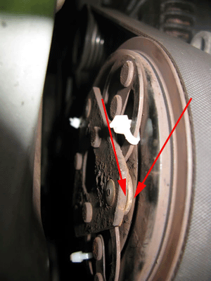

On the photo on volvospeed, it shows the clips on top of the rubbeer washers. On mine, I can't get the clips on as the washer doesn't move enough or my clips are to thin.
Is there any reason I can't put the clips below the washers. They're held pretty tight there so I don't think they'd fly off if I spuer glued them there.

I'm not really sure what you mean by "below the washers" but you will need to pry the clutch with a screw driver or something to open up the place where he is showing that the bread clips go. I think if you try to put the clips anywhere else you will have difficulty getting a uniform gap around the circumferance of the clutch. Read the volvospeed post once more and see if it makes more sense. If not, can you post a picture of your clutch or even post his picture and point to the "washers"?

C@lvin wrote:I'm not really sure what you mean by "below the washers" but you will need to pry the clutch with a screw driver or something to open up the place where he is showing that the bread clips go. I think if you try to put the clips anywhere else you will have difficulty getting a uniform gap around the circumferance of the clutch. Read the volvospeed post once more and see if it makes more sense. If not, can you post a picture of your clutch or even post his picture and point to the "washers"?
Probably should have said to the left or right of the washer (or whatever it is).
On the attached photo (not mine), I can get the clips where the right arrow points. Can't get them where the left arrow points.
Will it matter?
