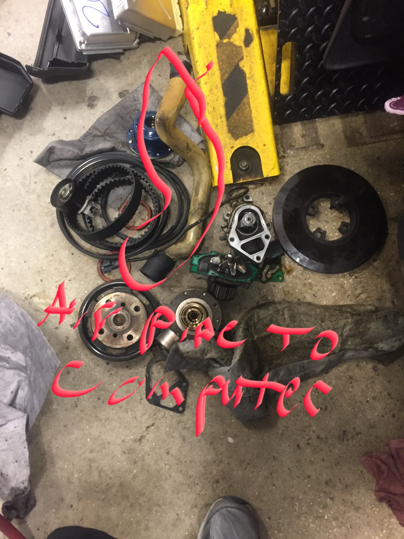

I found a post on another website where somebody did the timing belt on a 2005 S60R at had that part leftover when they where done.

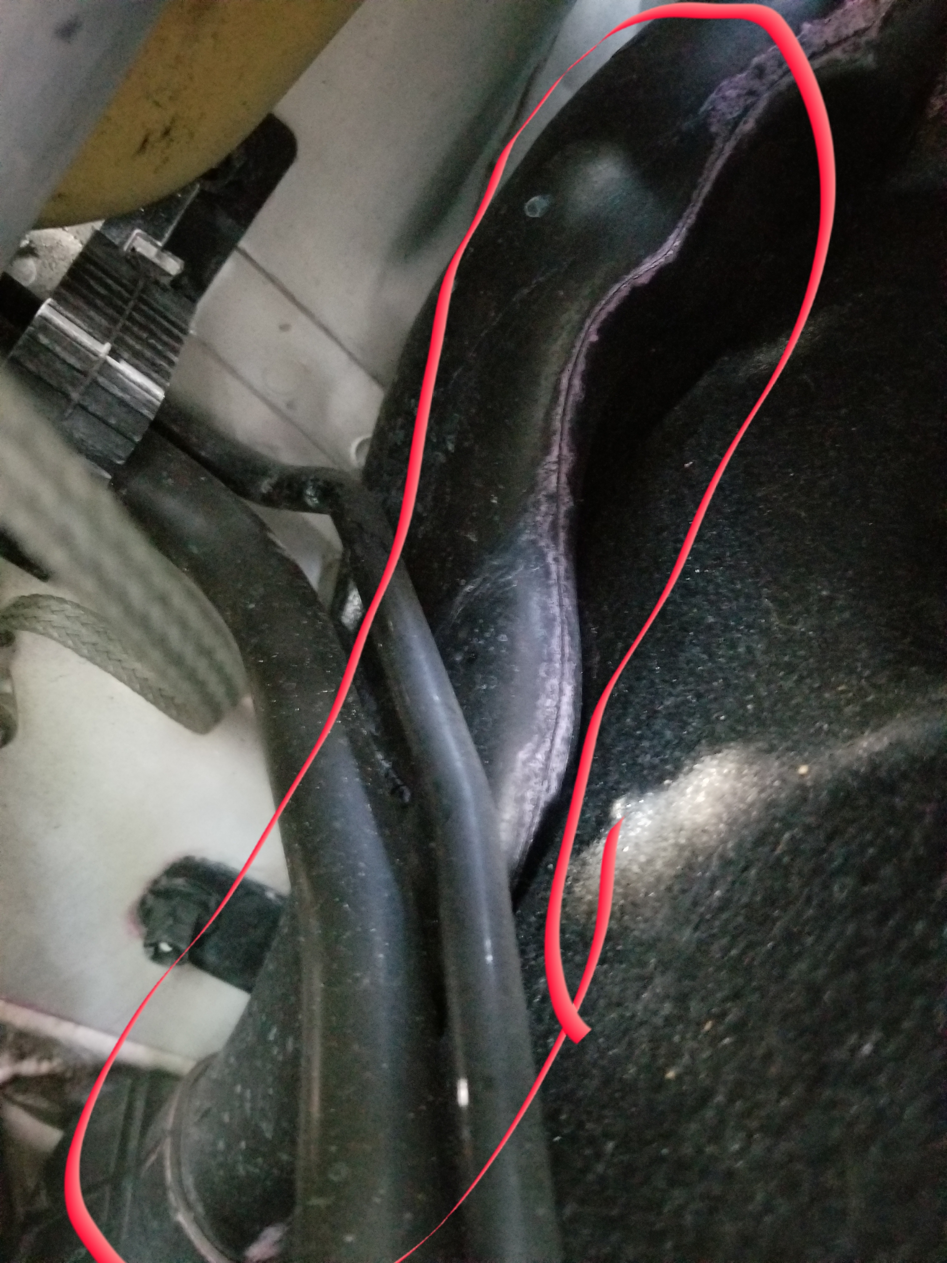

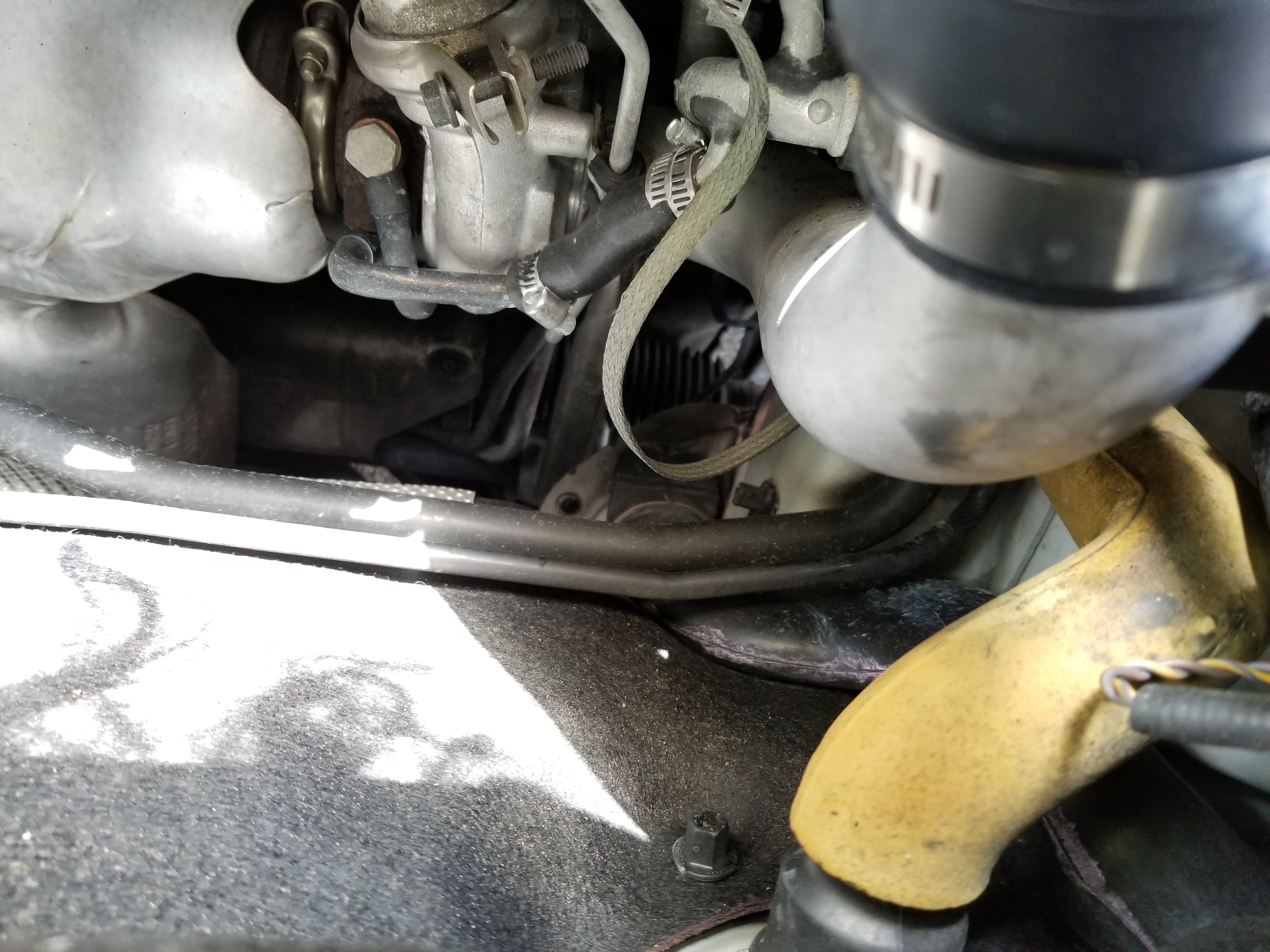

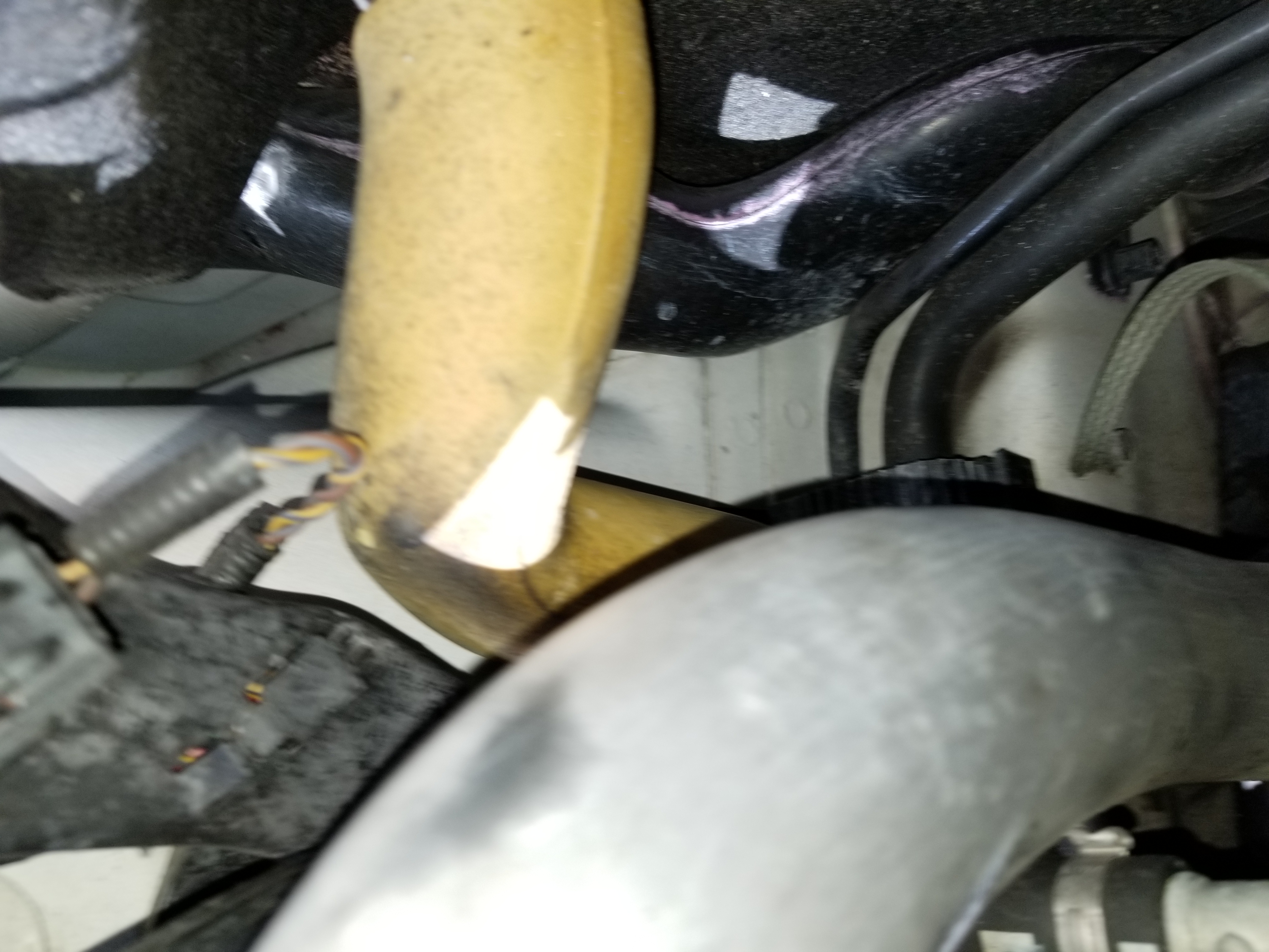

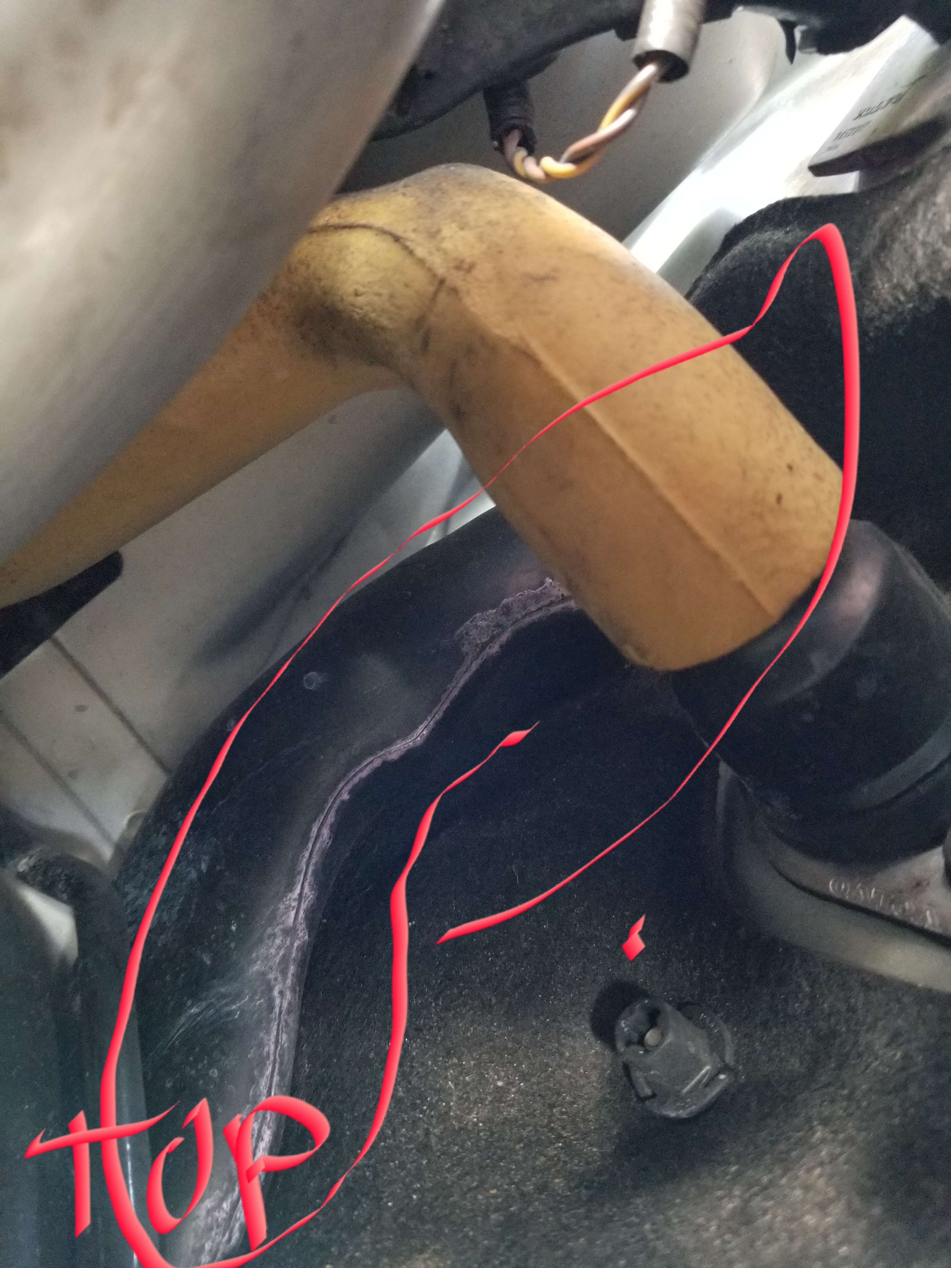

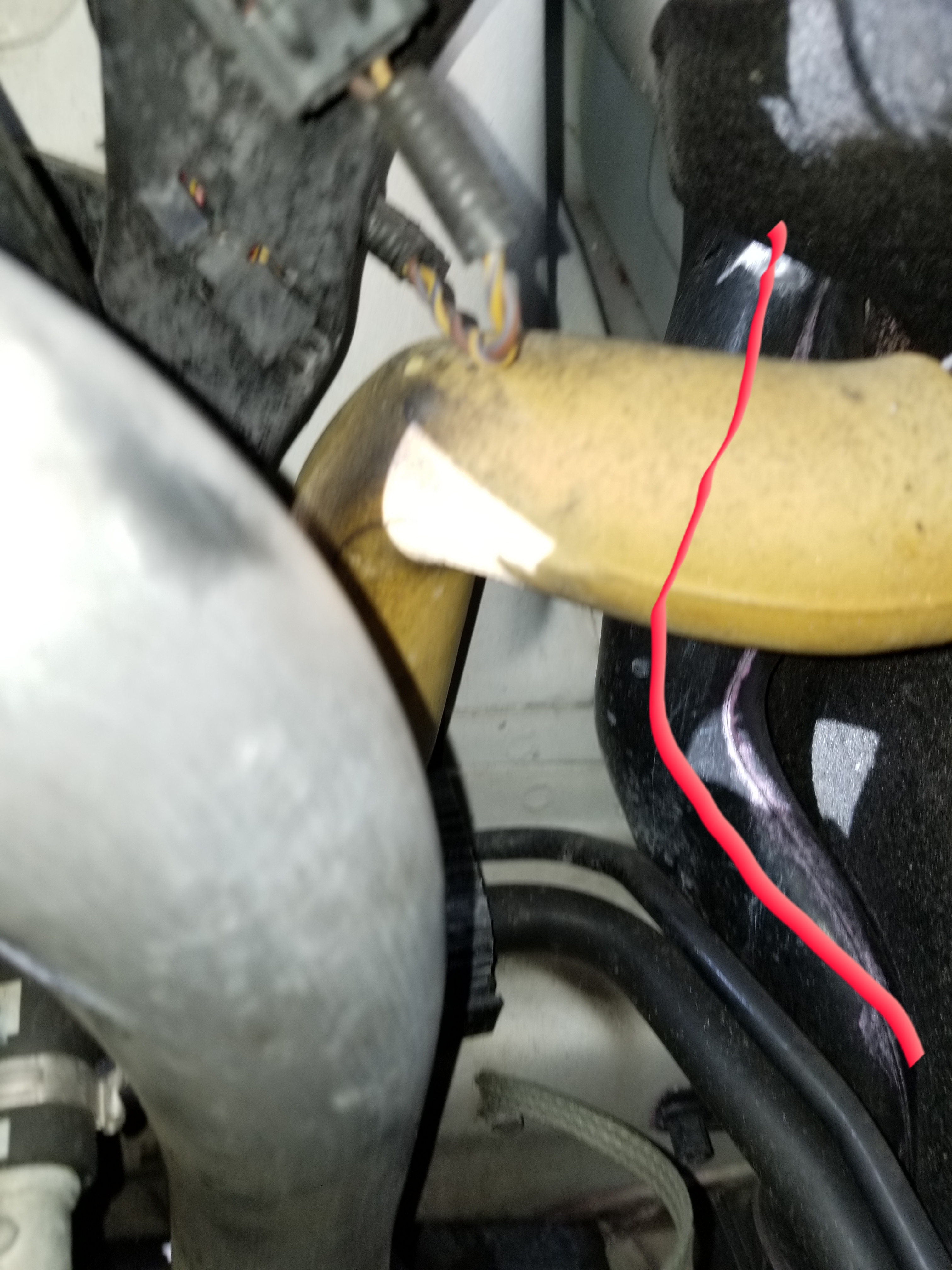

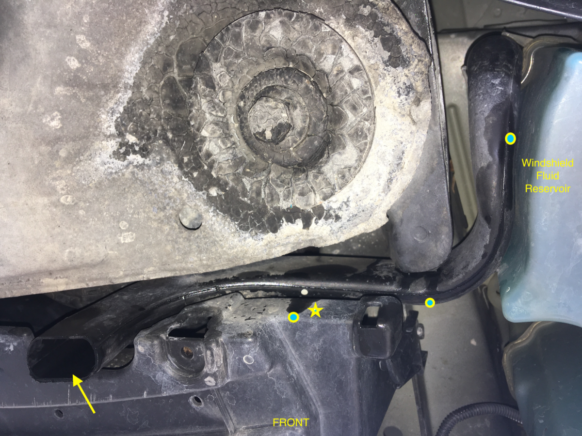

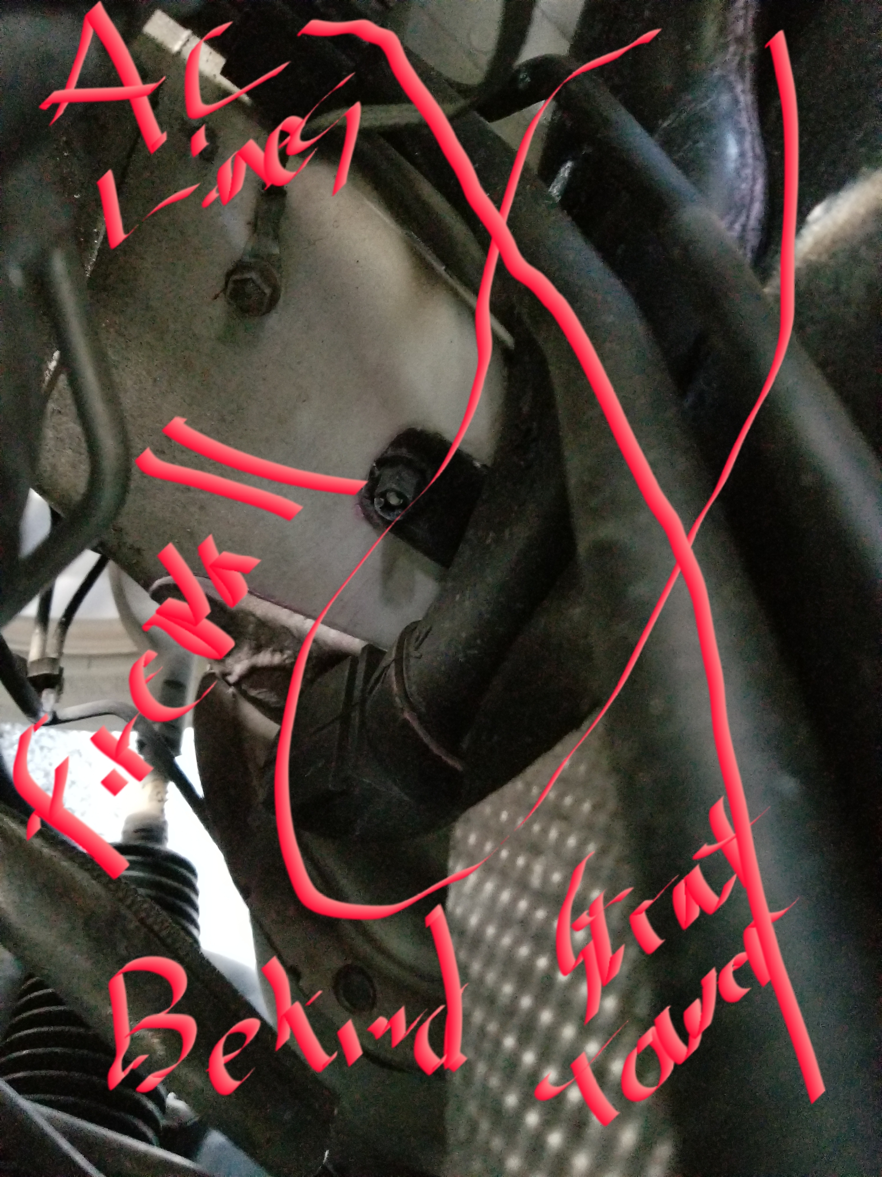

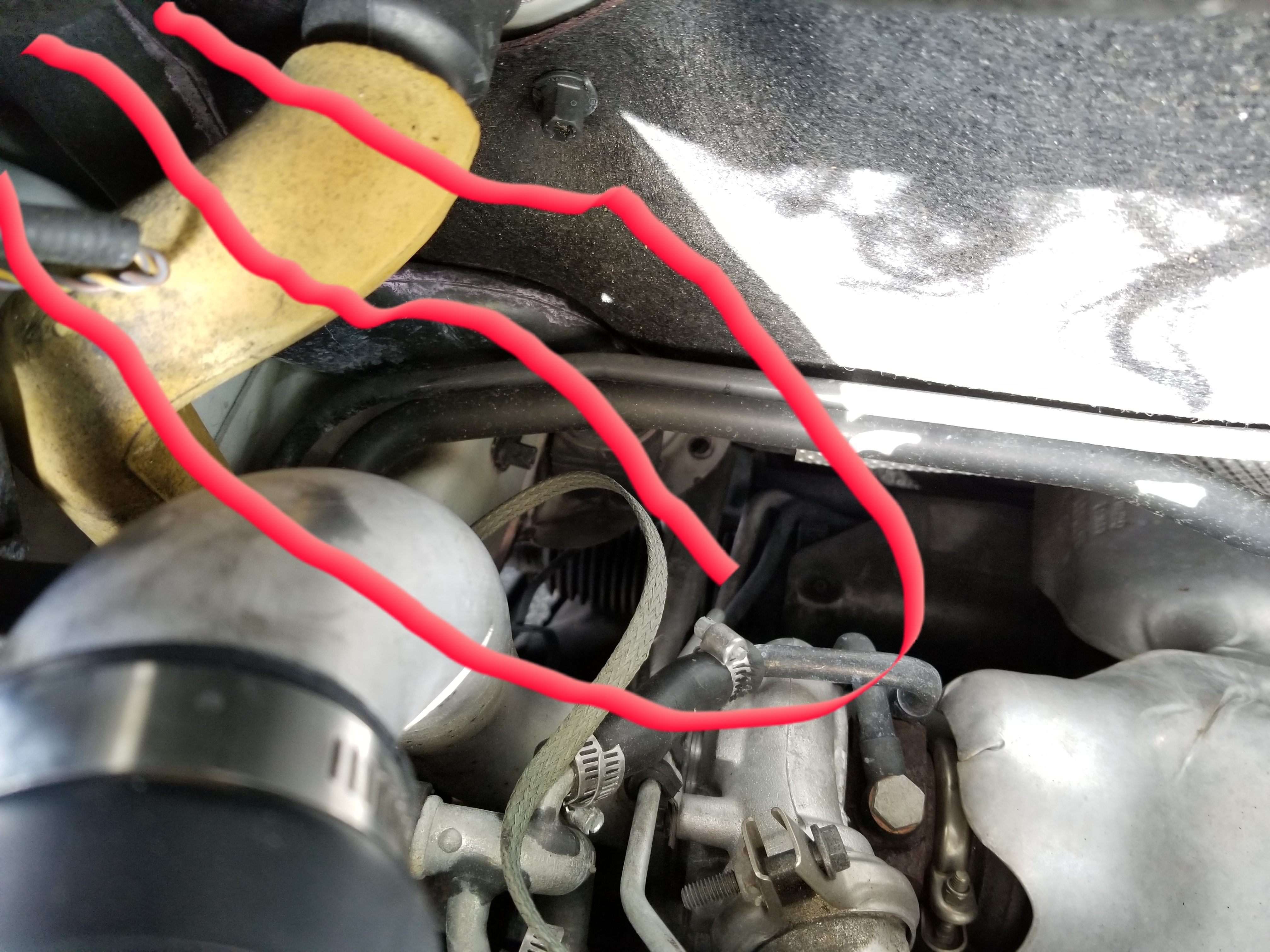

It is the passenger side drain for the cowl. It connects to the firewall behind the strut tower. Being in a tight spot I had to take pictures at different angles to capture it for you. If a mechanic did not reattach during a timing belt service they were a hack and I would not trust the work. I have seen that drainpipe off my car during both timing belt services. Both done by my Volvo dealer so pipe was put back properly. June
