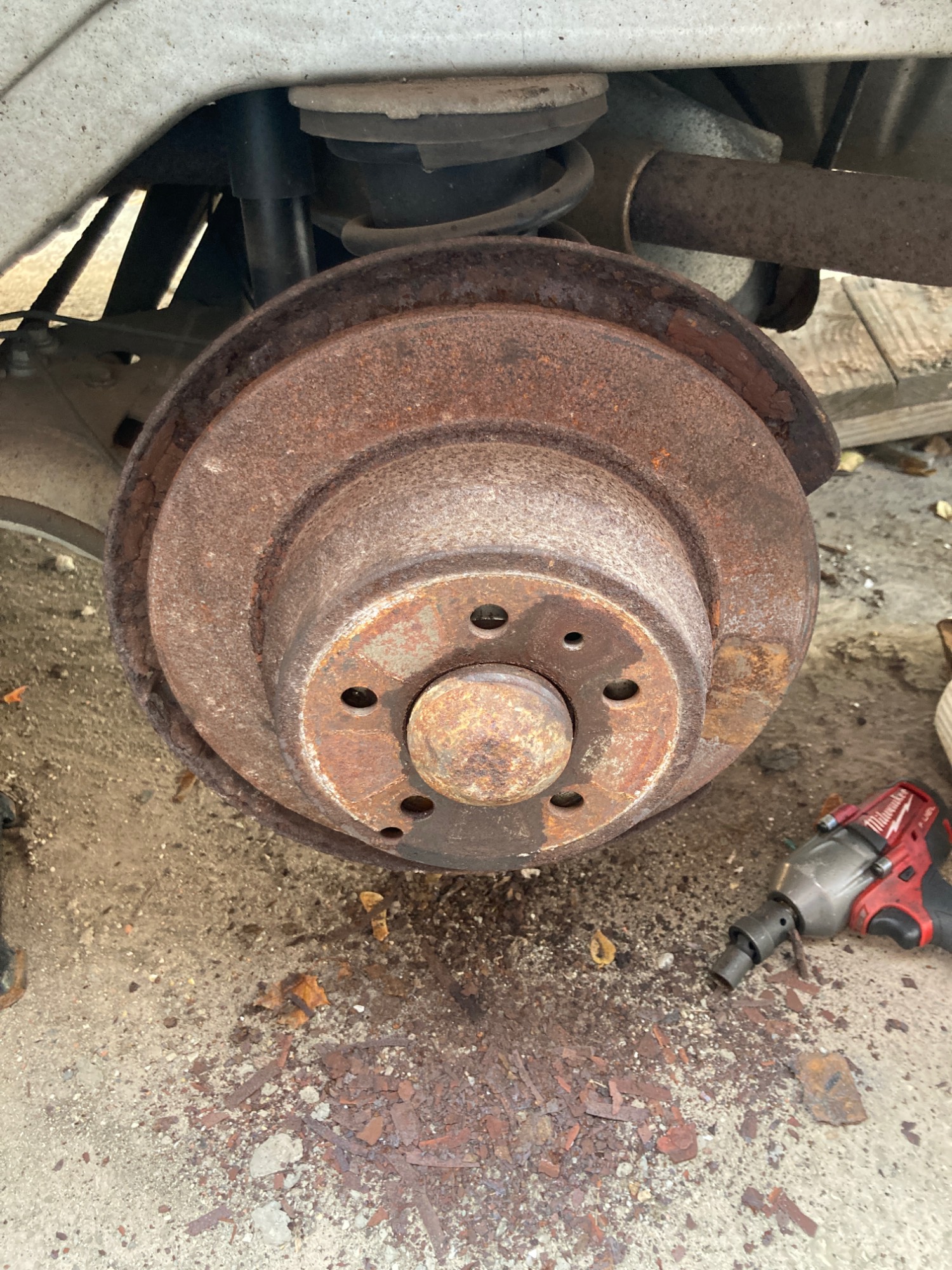

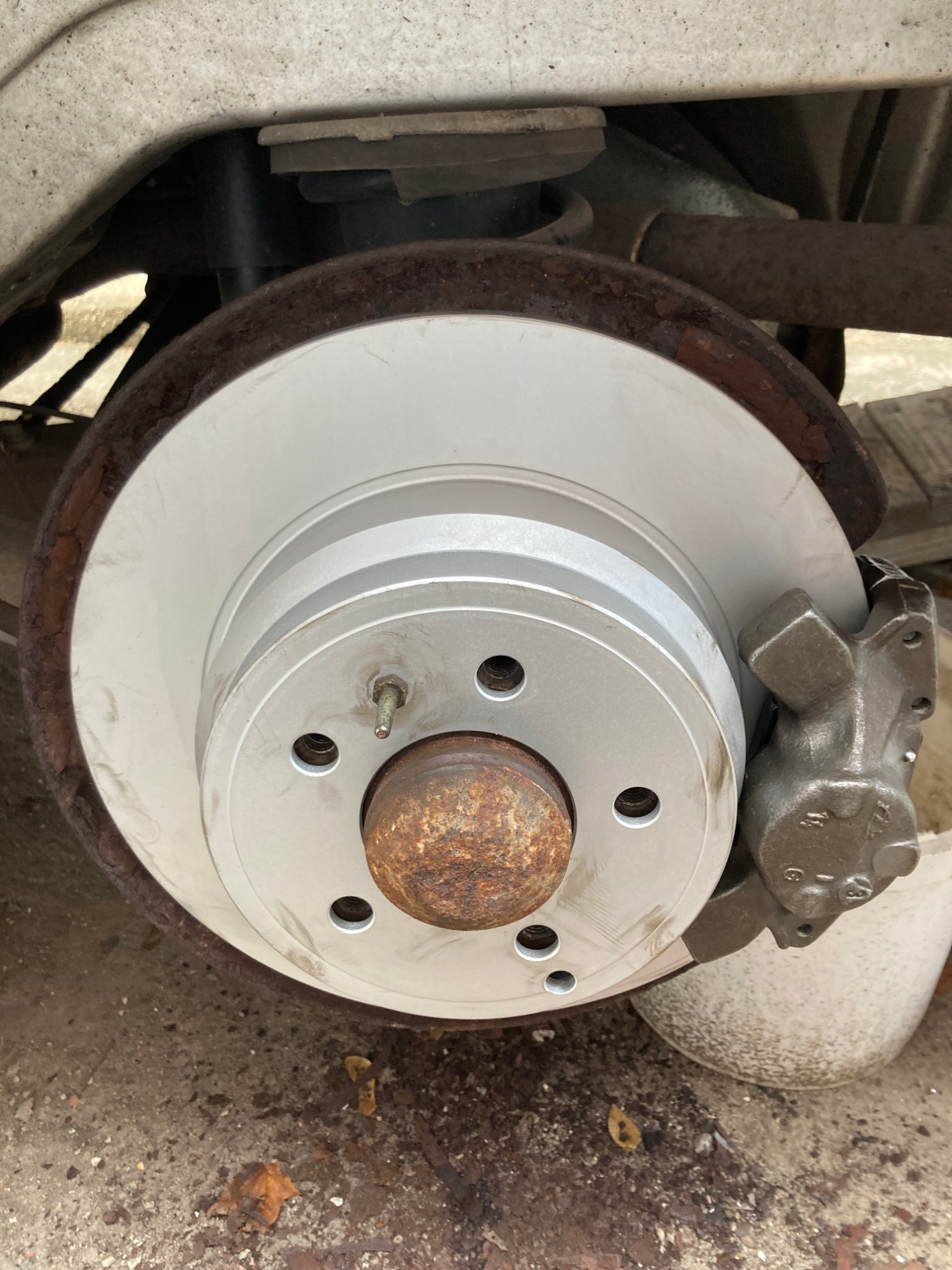

Replaced the seized rear brakes in the Silver Bullet with new Pagid pads and rotors, as well as Cardone-refurbished calipers, which appeared to have a lightly applied gray-beige powder coating.
Rusty rear brakes
Rusty rear brakes
New rear brakes and caliper

The caliper looks good. I'm contemplating doing the same thing on my 97 850. How much trouble if any did you have loosening up the brake lines?

I soaked them in PB Blaster well before starting, and one side loosen nicely. The other side seemed to bind after a couple of turns, so I ended up holding the brake line and turning the caliper off of it and the new one back on.

Don't spray the rotors with any brake cleaner just wipe with alcohol if needed. Many rotors now come with a break in coating while the remainder keeps it from rusting.
