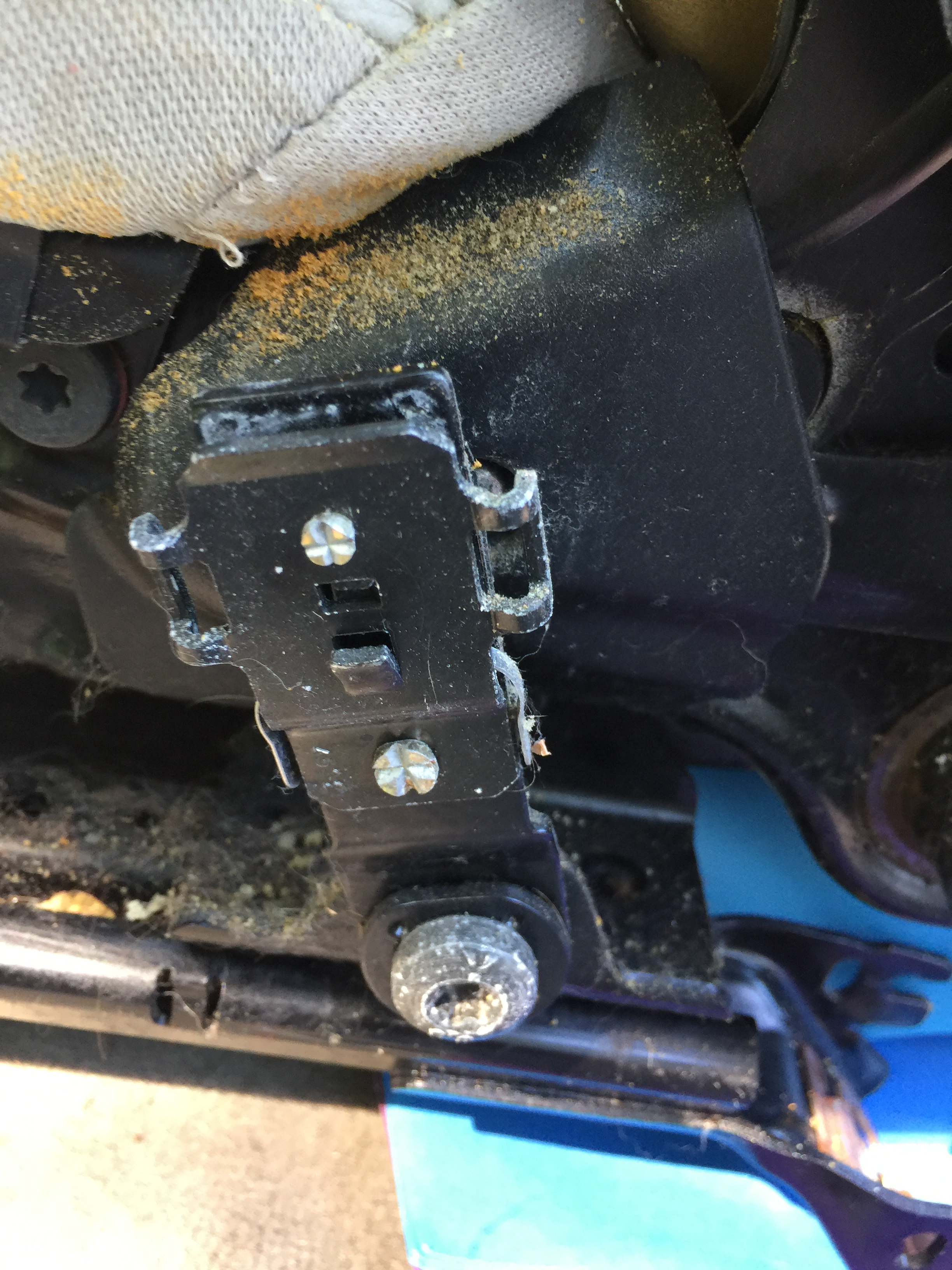

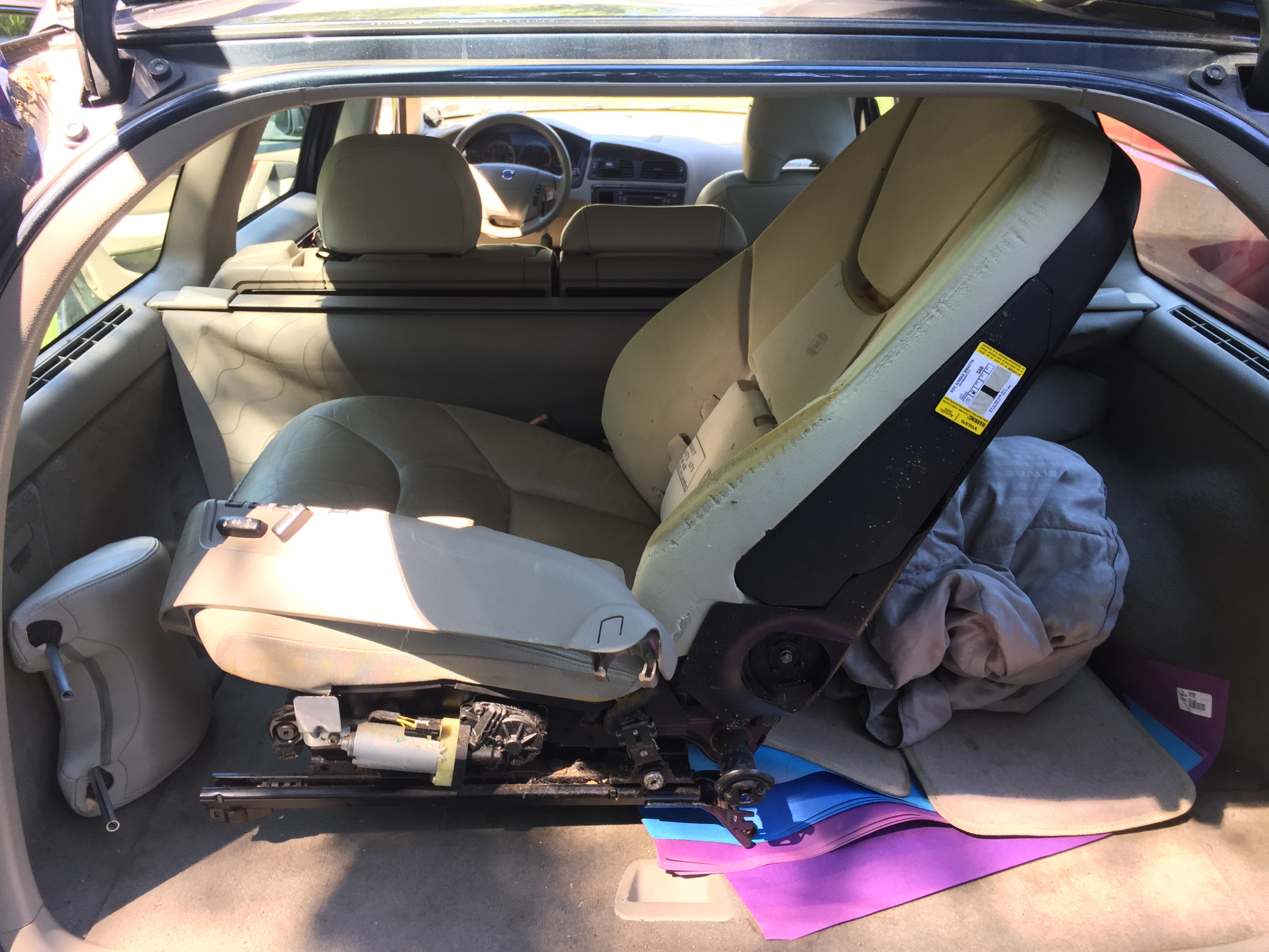

Remove four plastic covers and remove the M10 bolts (14mm hex, all vertical unlike the P80s), drive seat back to access front , forward for rear.
Remove small torn securing plastic switch cover/holder. Then lift at front, snap off tube in rear
Release the Showell pin to undo the seatbelt
Drive seat to forward so base Is just covering the front rails, set the seat back at 90+- 7 degrees
Disconnect negative on battery

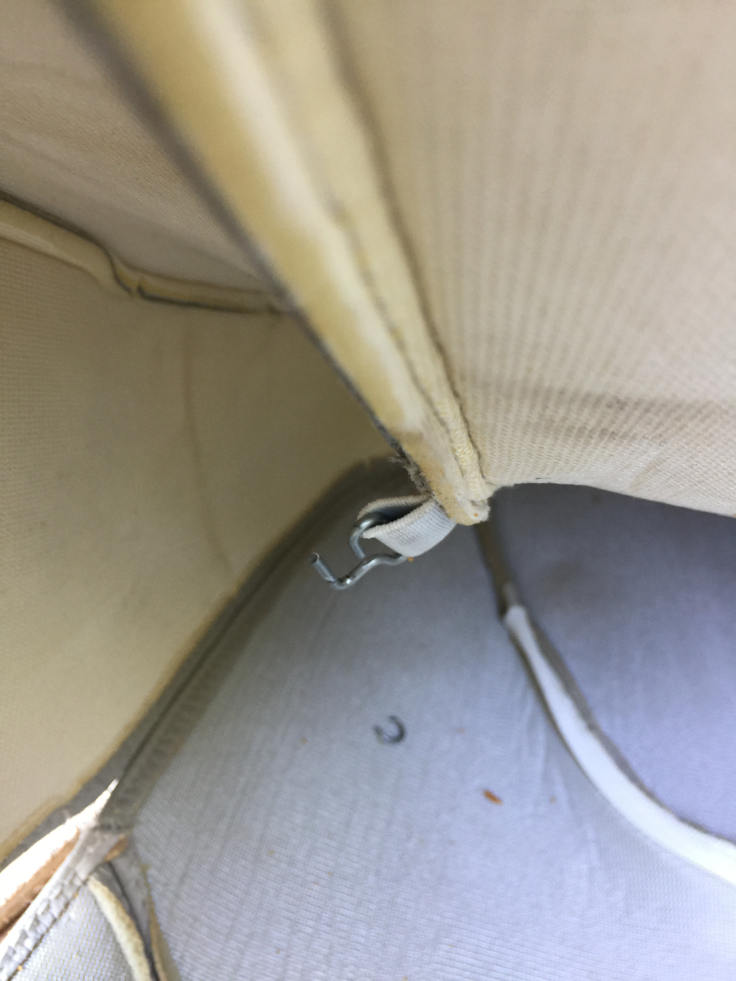

No hog rings at base, a plastic snap ring retainer

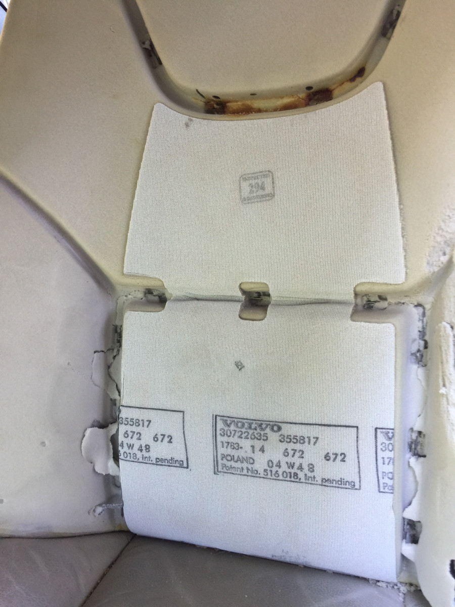

There about 1/2 as many hOg rings/springs as the P80 cars , work way up front\ doing side and three cross braces

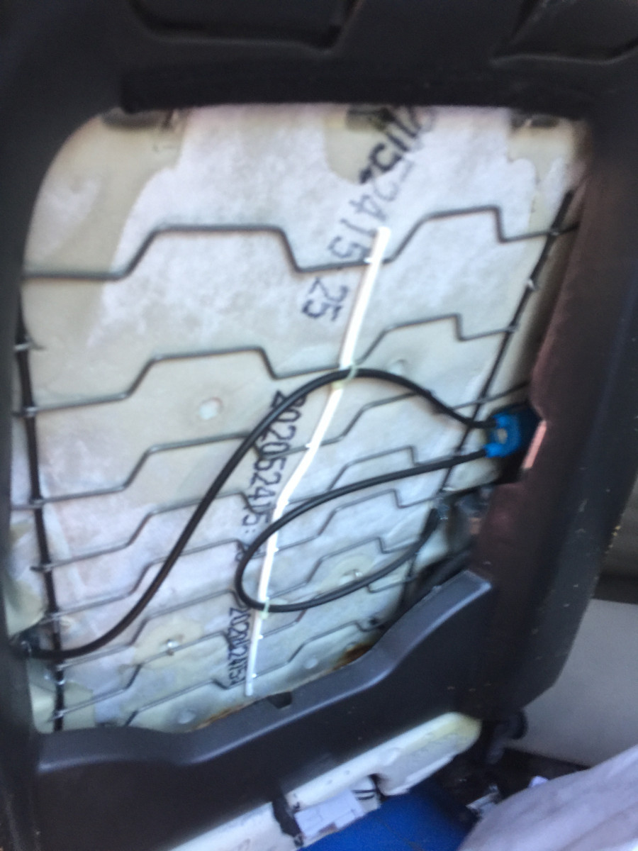

From rear, peel up as front releases, unclip catches on lumbar adjust from metal stays
(tabs with hole in them pick up clips)
Two cross braces with hog rings in rear.

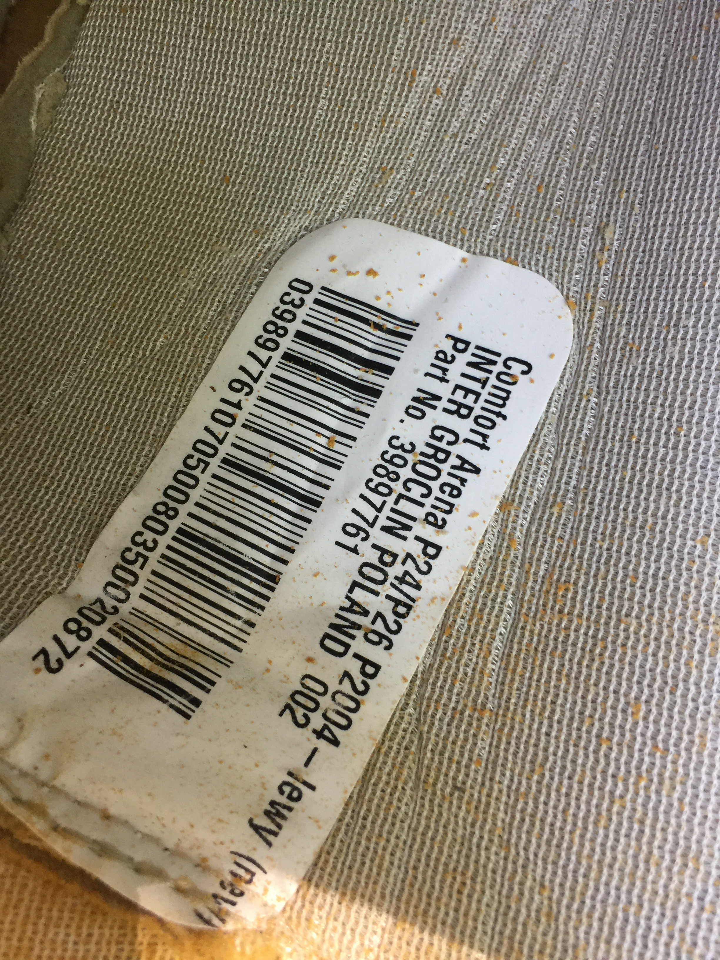

P2 2005 V70 upper driver seat skin repair 39897761

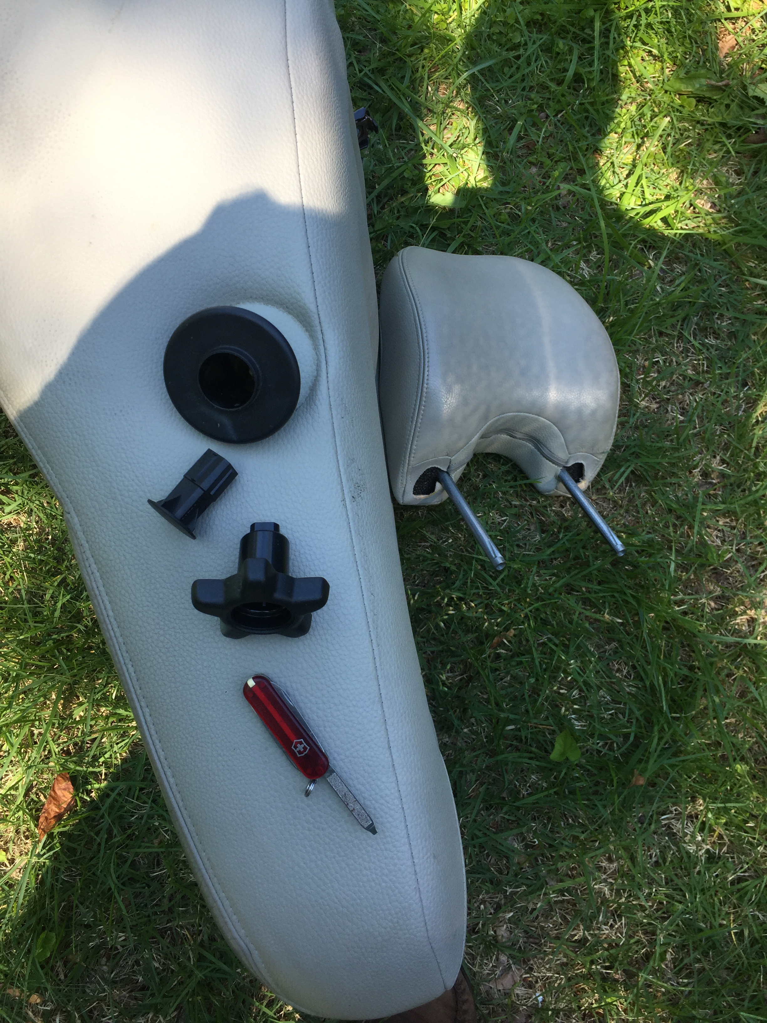

The lumbar knob is a minimal tools removal
Pop the cover with your swissarmy knife or a small Kroner coin
Pop out knob
Pop off trim plate
Pop out knob
Pop off trim plate

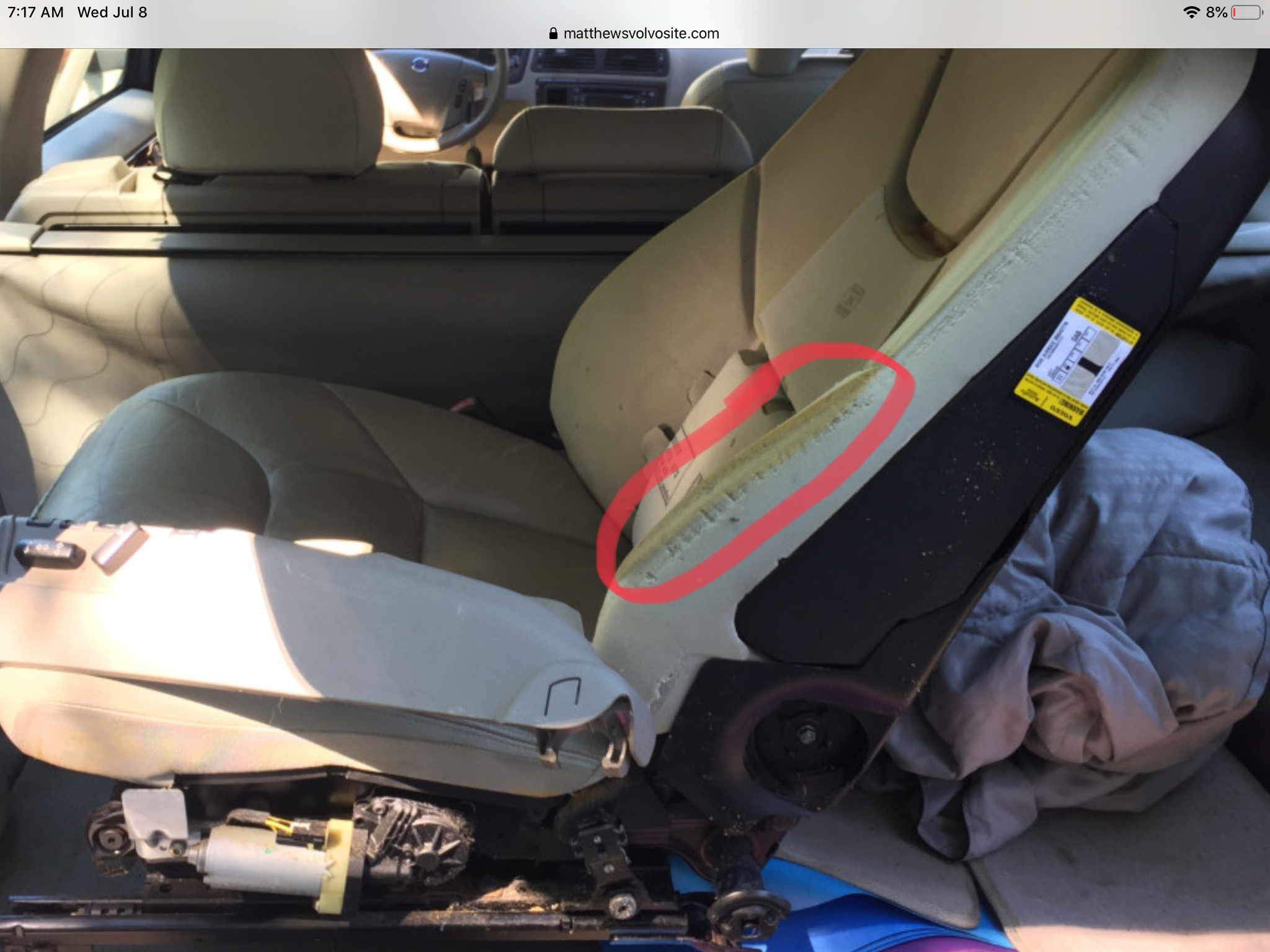

Okay, here is the seam I need to repair.
Anyone with a thimble with guidance on the right thread to use here?

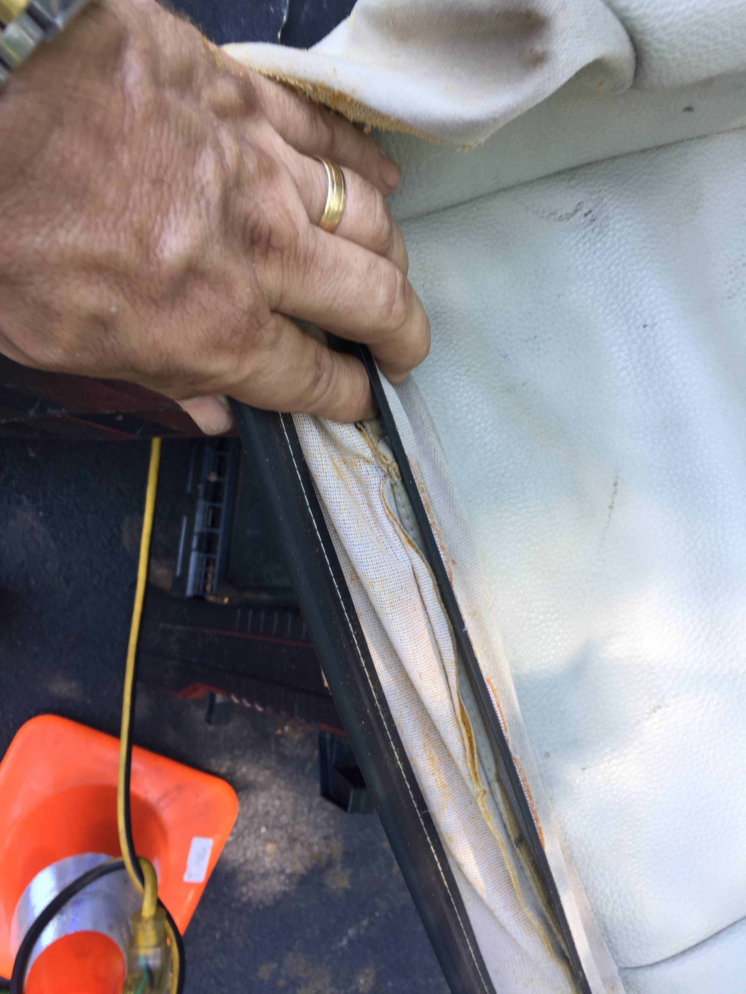

I forgot to do a before picture but you can see where my leather seam had split here
I sewed it up using doubled, standard thread, I only made three booboos which I will fix by restiching around them and then cutting the booboos out.
I sewed with the leather turned inside out using the existing holes as a guide
