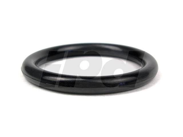

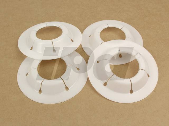

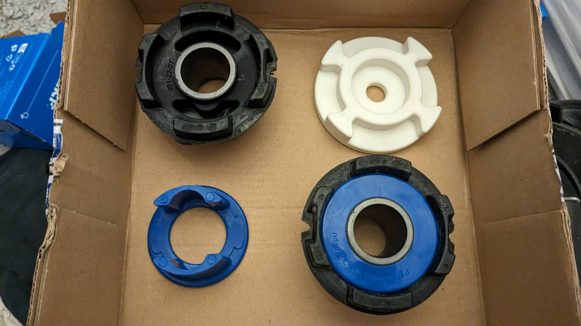

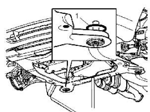

enotslim wrote: 11 Sep 2023, 09:23 I've seen o-rings part number 8638585 suggested as add-ons between the frame and subframe to suppress any movement/sounds that remain after renovating the subframe bushings. Is this worth doing up front as part of replacing the bushings or should this be reserved for only those cases when replacement doesn't achieve the desired results? Any downside to adding these 0-rings to P2 cars (specifically 2004 XC70) for which they were not originally intended?
If you have that popping noise that's the only fix. I would add those if you are going in there. I installed those rings (2), white washers (4) and blue inserts on the 03 S80 T6 original bushings. Didn't have the confidence to replace the bushings in a timely manner. Everything tighten up and no more popping noise. I did replace all the bolts.
Subframe O-Ring MTC 171129 - 124933 - (Genuine Volvo - 8638585)

Subframe Bushing Washer - P80 P2 S60 S80 V70 XC70 XC90
Genuine Volvo 31329447 - 120146
https://www.ipdusa.com/products/8859/Su ... o-31329447
