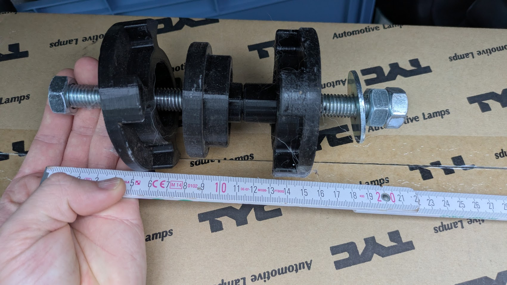

I used threaded rod, which was about 200mm long. You can substract 20mm for the two nuts and I think there was some additional length.
160mm might work, but you can probably use 1/2" threaded rod as well when you take additional care about the alignment.

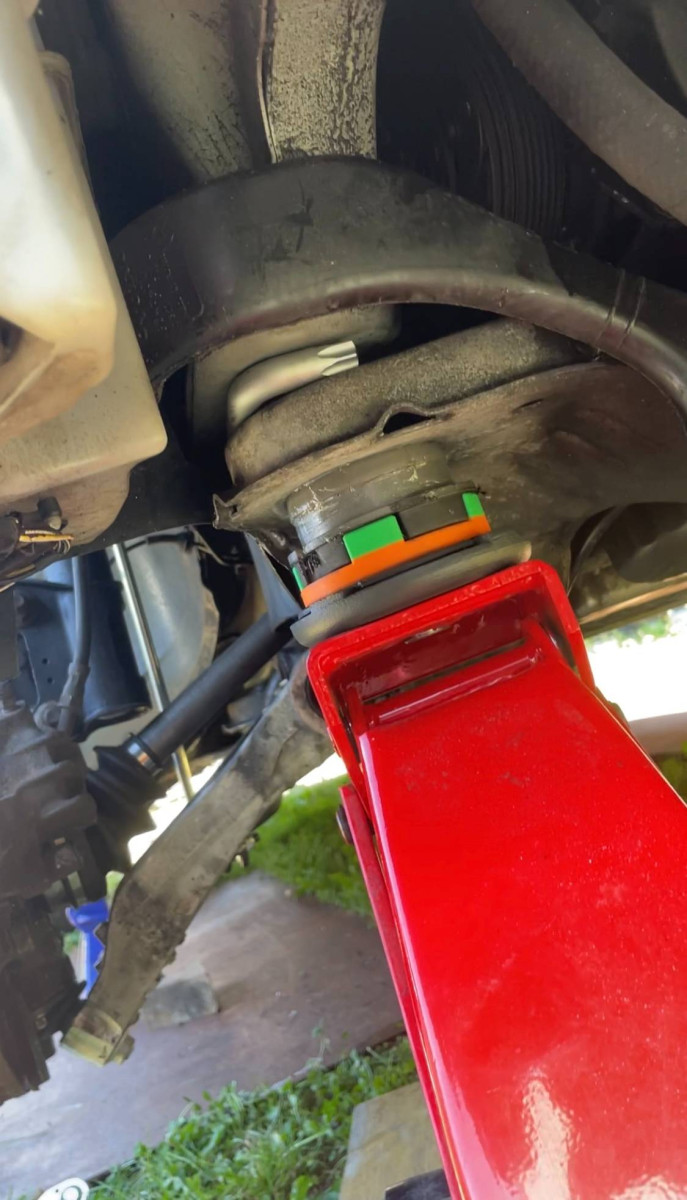

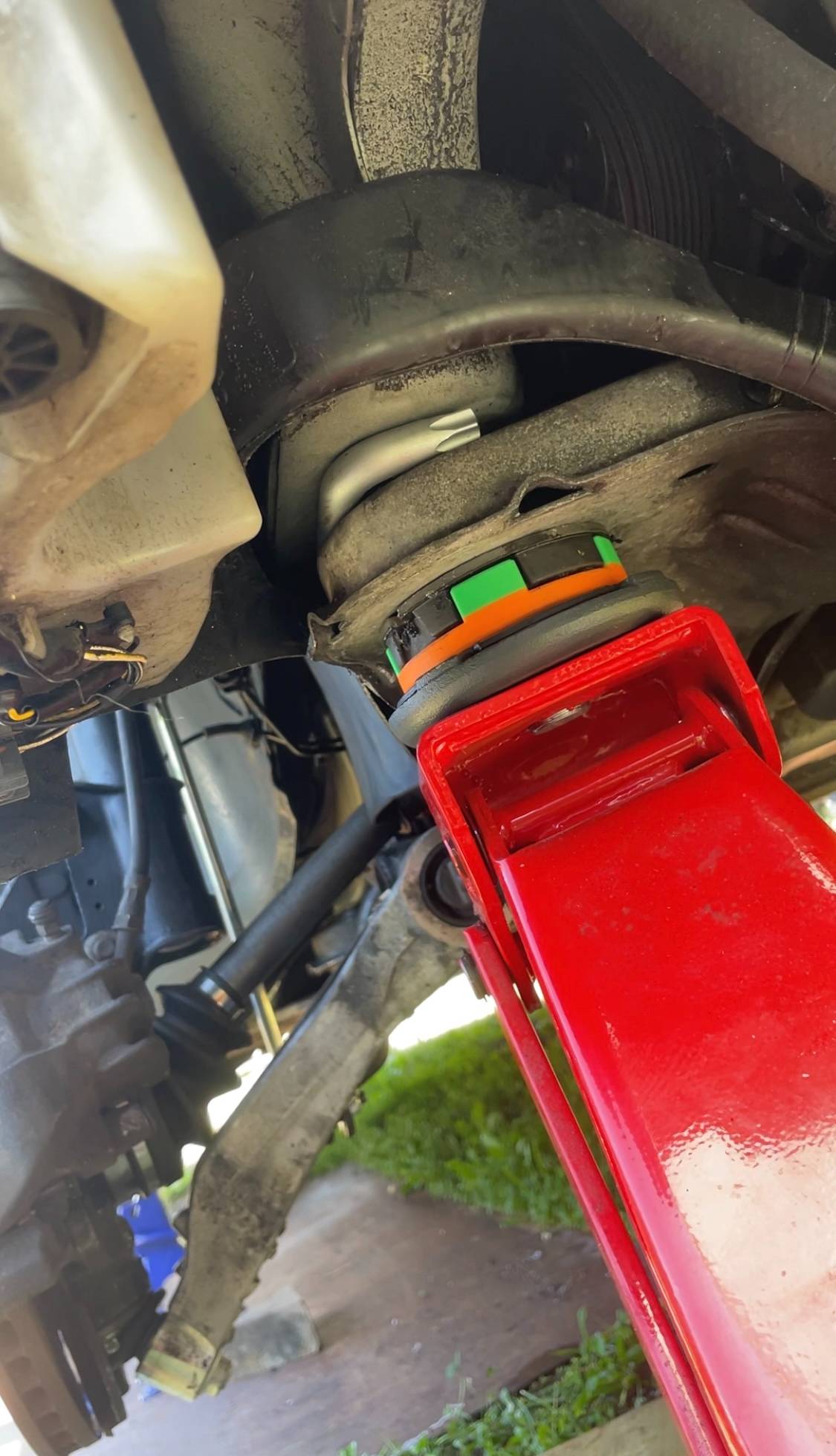

Hi everyone, I'm new here. Just wanted to thank you both @Blacklab467 and @crasbe for your work guys! I used a mix of both solutions -> fat allen key between subframe and frame, jack to push up and 3D printed tool to make the job easy and protect the bushing. All 4 bushings were fitted super fast. It was actually harder to get old ones off. Thanks guys you're my heroes of the day (week maybe!)

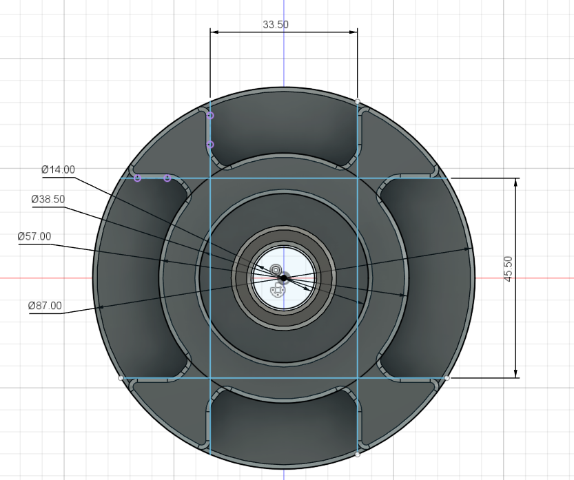

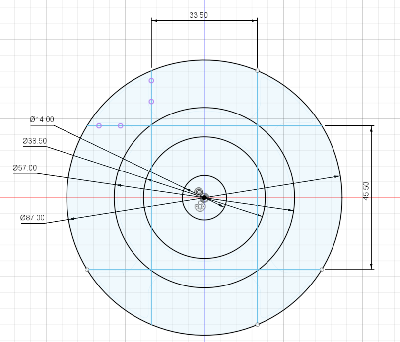

Just thinking what to use as a formed block since I do not have 3D printer. I think a hardwood block could be carved with a router to the required shape.
Can you publish dimensions?
crasbe
Posts: 91
Joined: 8 December 2022
Year and Model: 02 S60, 98 V70 (EV)
Location: Germany
Has thanked: 31 times
Been thanked: 79 times
Post by crasbe »
Perhaps you can find a volunteer from the US to print you the tool. Shipping it from Germany is quite expensive unfortunately.
But here you have the relevant dimensions:
Screenshot 2025-07-01 231308.png (245.34 KiB) Viewed 1197 times
Screenshot 2025-07-01 231259.png (145.14 KiB) Viewed 1197 times
