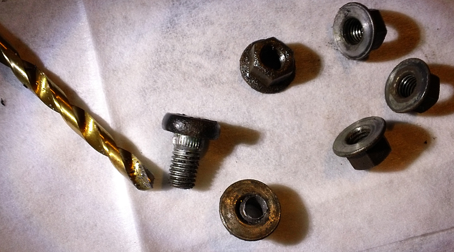

After taking the measurement for SRS, the five fasteners that were soaking PB, I decided to turn these loose few threads last night.
The head of four bolts are round, the one front passenger side received enough of the leaking ps fluid that it is coming loose. Anticipating troubles ahead I have stopped.

Arm hurts, but the five bolts are off after paying close attention and not rushing.
For the stubborn, it took 1/4" left-handed drill bit, then 21/64" standard to pull it out. Maestro says use machine oil when drilling.
the four bolts need care...

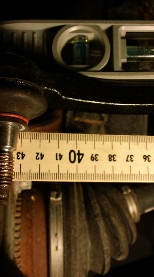

This measurement is while the rack is still on. The driver's side measures at 431-33mm, and passenger 424-26mm. Is the 6mm difference normal?
I will take another measurement after it is out, and on the workbench.
Will i need "the same" measure at install or would a close enough work as well?
measurement for SRS limit, Marty's rebuild axle in the background

On the tie rods, are those measurements from the JY rack? At re-install you will want to replicate the measurements on the rack in your car, not the measurements on the JY rack. You know your car is driving well, so I would trust whatever measurements you get there.

The measurements are from the leaking rack on my car erikv11.
