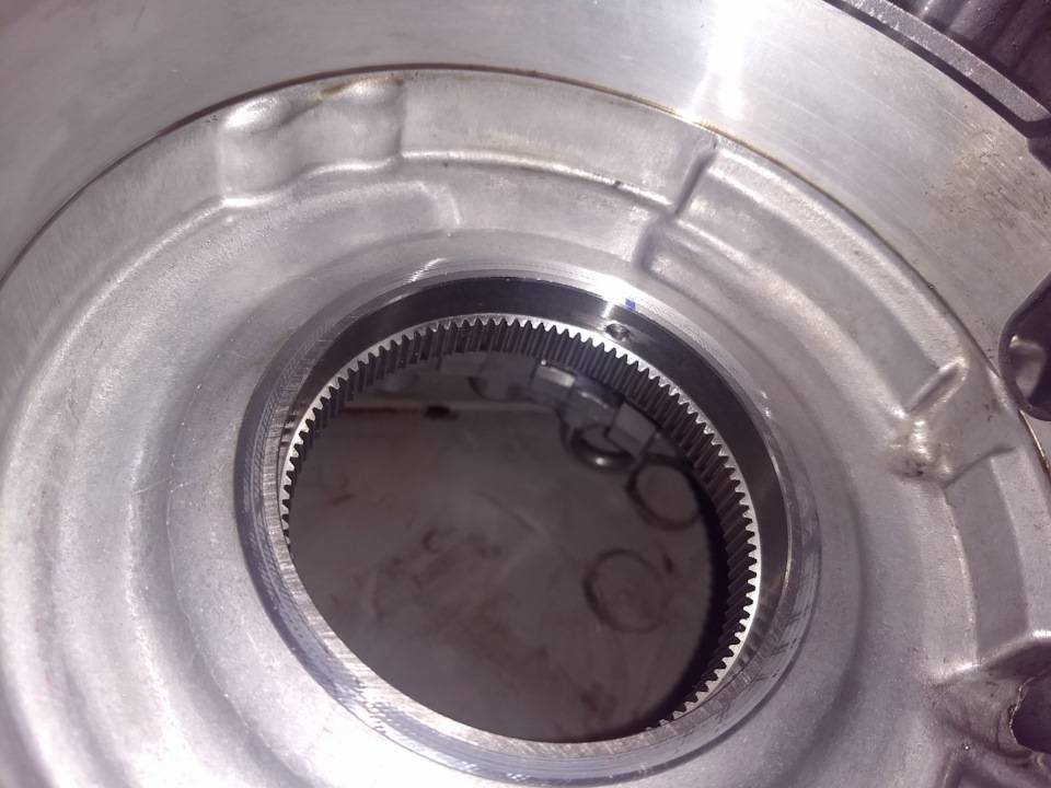

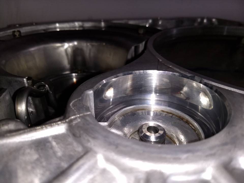

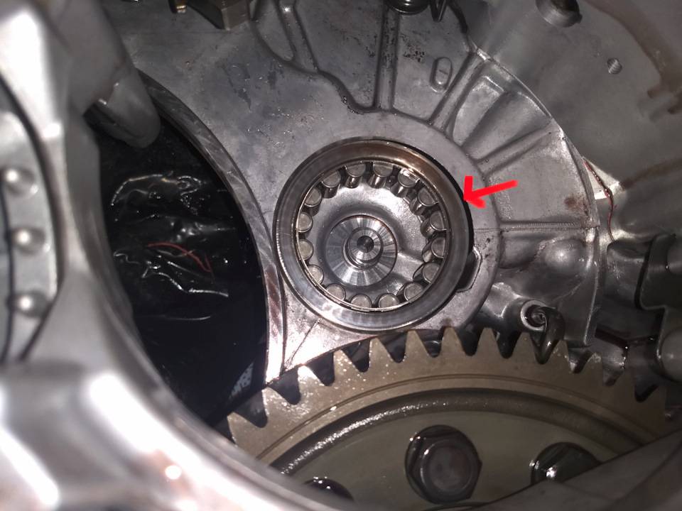

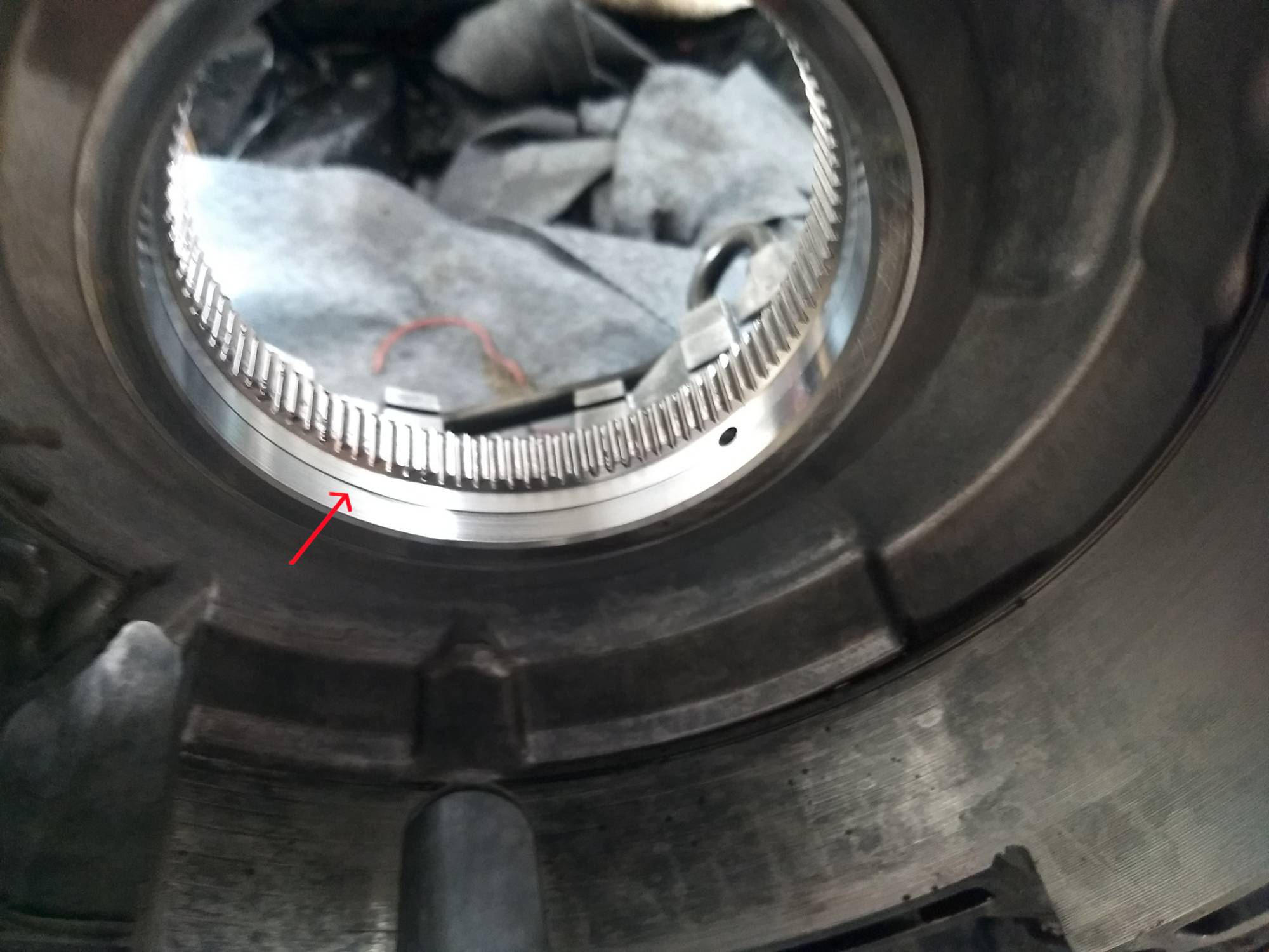

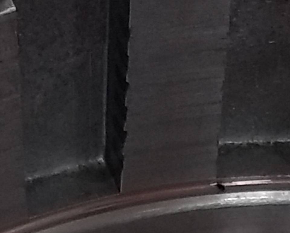

dikidera wrote: 07 Nov 2023, 05:50 What are those steel sleeves for? And does it require a press?
This one is responsible for harsh R and more:
The cure:
Spun bearing race grinds through casing, responsible for the third gear problems:
I don't have the sleeve there, mine just started to spin and still was OK for Loctite 620.
Why you want the lesser miles/km. This one from 220k miles transmission with only 1 ATF change at around 110k miles:
Sleeves installation requires a mill+press, yes.
