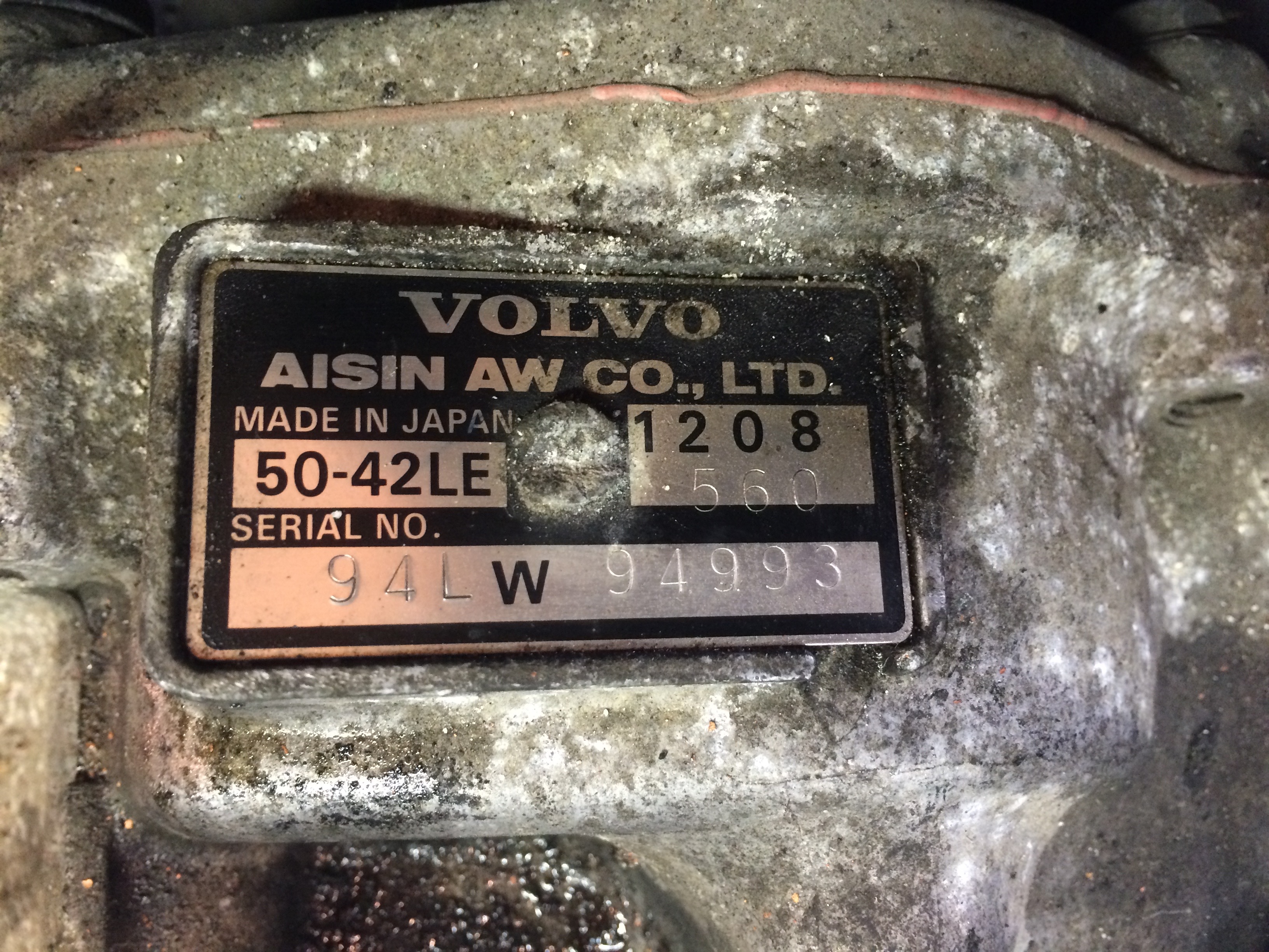

Original (dead) tranny from 2/95 keeper vehicle: 50-42LE 94L

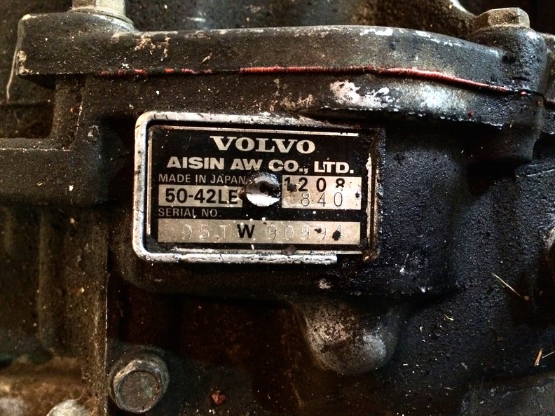

Donor tranny from 12/95 donor vehicle: 50-42LE 95J 1208-840

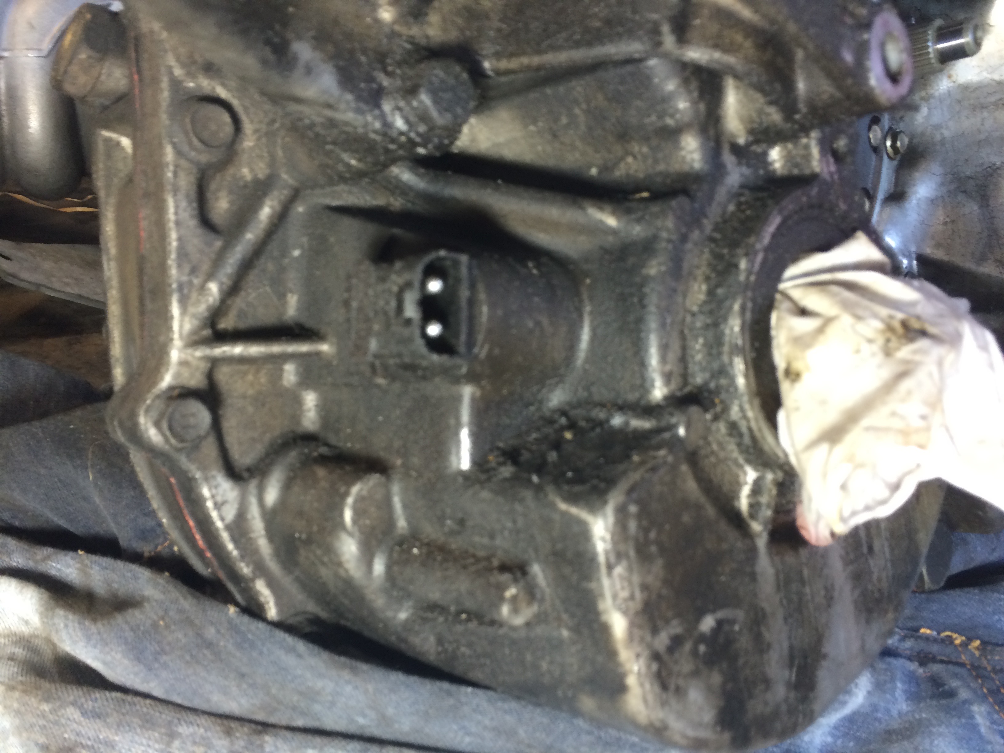

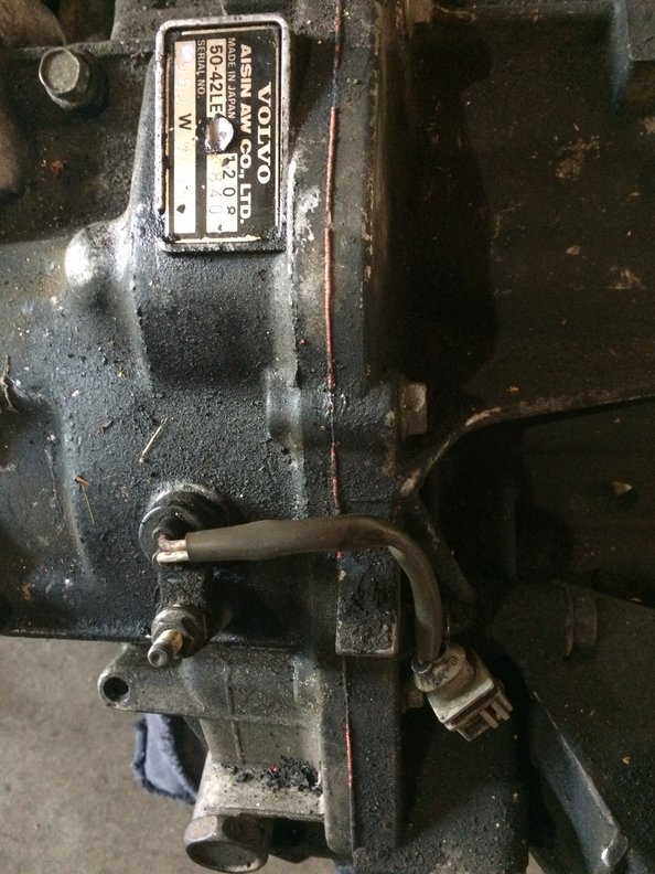

I think I have my sensors mixed up more than anything. On the dead 95 tranny there is a wide rectangular plug area beside the pax side axle hole. No such thing on the 96 donor. On the 96 donor there is a 1/2" round sensor on the top of the tranny just a few inches back of the stamped tranny info plate. Photos:
rectangle sensor on dead 95
round sensor on donor 96
