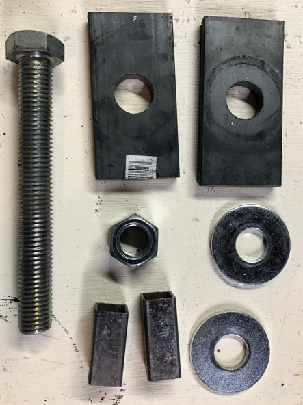

1) Materials:
I went to a home store and bought the following. (see picture in part 2)
1a) Metal bar stock that was 12x2x 3/8 (Length x Width x Thickness)
1b) 3/4 inch bolt and nut that was about 6 or 7 inches long (I don't have it in front of me to measure).
1c) washers
1d) rectangular tube stock that was about 3/4x3/4

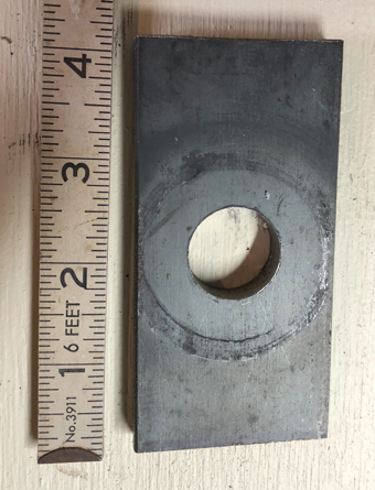

2) I cut the bar stock so I had two pieces that were 4 inches in length and I drilled a hole large enough for the 3/4 in bolt.
I also cut the tubular stock so I had two pieces about 1 - 1.5 inches long.

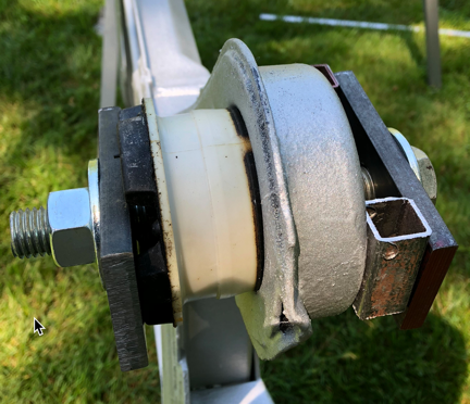

3) With help from my son, I was able to assemble the press and hand tighten the nut so that the press held the bushing snug against the frame. In the second picture below you can see how the two tubular pieces were used. They hold one of the plates away from the frame so the bushing can pass through.
4) I then used a socket and wrench to tighten the bolt and press the bearing in. Having a second person to hold the wrench while I operated the socket was helpful but I'm sure there is a way to do this part with one person.

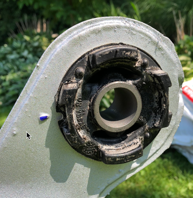

5) pressed in (note mark on frame that lines up with notch in bushing).

The use of rectangular bar stock did work fine but required me to back off the nut a bit and rotate the bar stock 90 degrees every so often as I pressed in the bushing. Press in 1/4 inch, back off and rotate bar stock, press in 1/4 inch, back off and rotate, etc.
Ideally the plate pushing on the bearing itself would be circular or a cross in shape so it would apply pressure equally on the bearing as it was pressed in. However, it's important that the diameter or length of the bearing press plate be no longer than 4 or 4.5 inches maximum. If it were longer, it may start hitting parts of the frame for at least two bearings.
