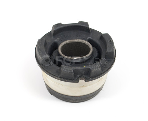

I'm going to order some subframe bushings. I know not to get URO under any circumstance (I really wish eEuroparts understood our aversion to their parts...) so I'm looking at the Pro Parts Sweden. (I know, I know, I know...) Price difference is substantial: $30 vs $130... Aside from getting the OEM Volvo ones, for which there is only one part number for all four subframe bushings (Volvo-3507923), does anyone know why there are two different ones that need to be ordered if going a non-OEM route? I found somewhere that the Volvo mount was updated at some point (which is why the hole is round instead of oval on the OEM ones?), but I can't seem to find that anywhere so maybe I am making that up. Am I missing something here? It would seem that installing the one with nubs all around would be better for the car, no? (Especially if that's the updated design...)
from FCP's site:
fits Front LEFT
fits Rear LEFT; Rear RIGHT; front RIGHT
And the OEM Volvo one looks a lot like the latter of these two:
(complete with nubs!)
Has anyone tried to install the bushings with nubs all around?

I used four 8678497 on my 850 and they fit and worked prefect.
http://www.tascaparts.com/oe-volvo/8678497
https://www.fcpeuro.com/products/volvo- ... 90-8678497
Pro Parts Sweden is ScanTech... poor quality.

Oh wow, I didn't know that we could put the XC90 piece into our cars. Thanks for that headsup. I have read through the write ups. Doesn't seem too hard, except that it requires determination and a whole lot of effort, especially if you're doing it on your back, in 90 degree heat... I am concerned about the "looseness" coming from the front of the car and of course, the dented washer. So I need to get on this. I don't want to go cheap. But I need to order new washers and the new plates (I dented them by placing my jack stands on them incorrectly.) Maybe I should just get the two front OEM ones? and wait a while to get to the rear ones?
Seems like Febi (Febi 22955) makes a part too... $28 at eEuroparts...
Rockauto has a Dorman (DORMAN 523138) 2004 XC90 subframe bushing for $20...
Dorman and Febi are much better brands than Proparts... right? I've always had luck with Dorman pieces. (Though, have never given them a go on our Volvo.)
