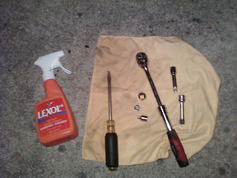

First the tools you will need are listed here
Wrench - I prefer craftsmen just in case it brakes i can take it back and get a new one free.
sockets - 12mm and a 15mm will work GREAT!
wd40 always helps! *or any type of lubricant*
Flat head screwdriver for the first clip others just come right off
TWO extensions although one will work.
Extras-
Leather cleaner if you wish to clean, and water if your using lexol to activate the cleaning additive.
Shop towel for cleaning leather and whipping down anything that needs it while your seat is out.
Vacuum with a hose! *now is the time to get those hard to reach areas!*

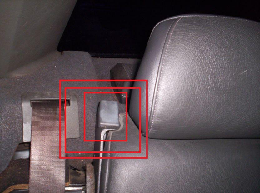

Firstly your going to want to pop off the plastic pieces, the one in the front next to the door is a major PITA and BECAREFUL! because if you do it wrong you will brake it.
First
Your going to want to remove the side peice. Simply pull up in the front and slide it back. thats all there is to it. then lift it up and out.

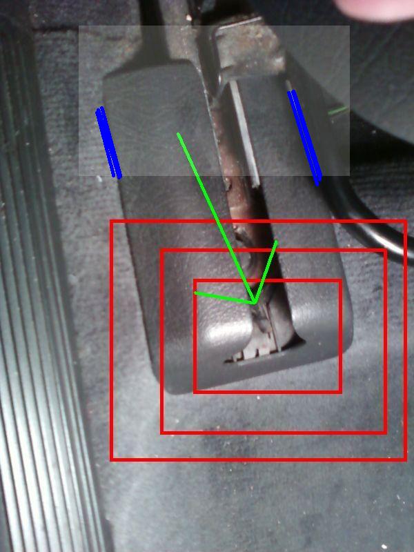

Move the seat all the way back

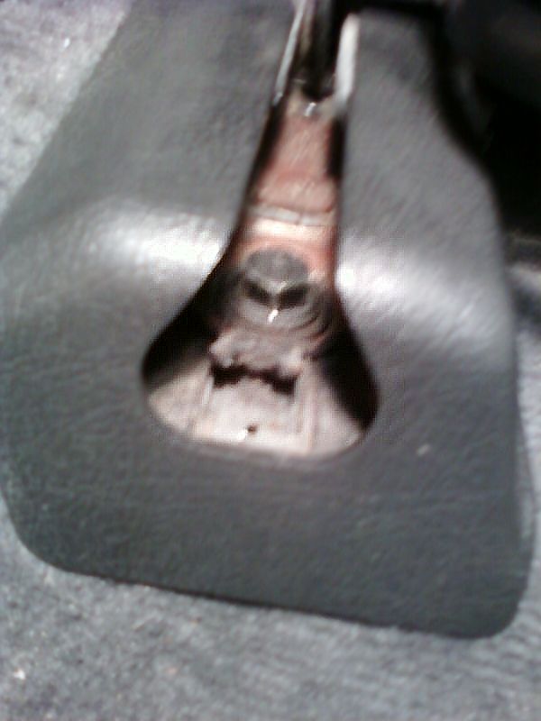

Take that flat head and put it between the silver clip and the seat frame *brown in my case* pry it up just enough to where it lets go and you can slide the plastic piece off. I started off by prying on it and ended up cracking mine... this is when i took a breath and analyzed it.
Note the photo- the green arrow is the direction to come with the flat head, and the red box is where the clip is located. Also squeeze a little where the blue is to decompress the sides. this will allow the piece to slide right out.
in this photo you can see what the clip was on.. i couldnt get it to clip back on when i reinstalled by the back part keeps it snug.
*sorry for the blurry photo, cell photo quality*

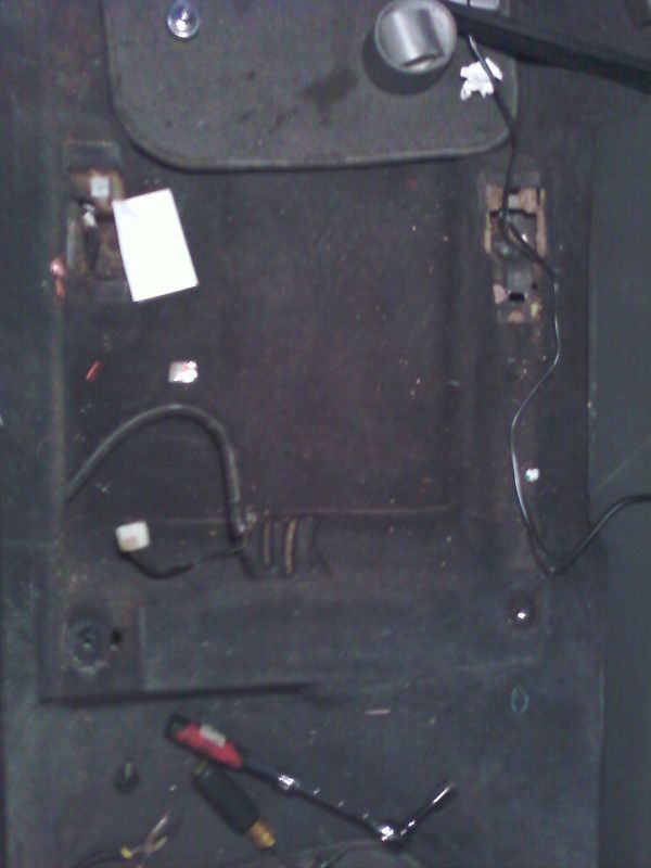

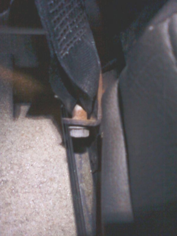

Once that is done slide your seat all the way to the front, the 2 backs are just a matter of wiggling them and prying a bit to get them out, I will take some photos of this step tonight to post.
Once you have gotten those out, you will have relieved the 15mm bolts that hold your seat down.
Now that they are exposed take this time to hit them with the WD40 and go over the seat to see if there is any extra cleaning to be done
now after 5 minutes or so its time to get cracking!
I started with the front just simply because I sprayed the back first and the fronts were exposed from me sliding the seat back.
Take your wrench with the *1* extension for now* and your 15mm, give a good torque left to loosen them Once youve done that just take the bolts out from the front, Slide the seat up all the way and move to the back. *I like this part because you get to sit on a nice cushion seat while you work!*
Depending on which one you start on.. for the sake of this we will start with easiest first, so the right bolt.
take again with your wrench and take out the bolt turning your wrench towards the back of the pass seat.
Now this step can be done with one or two extensions. if your not in a hurry you can use one, but if its 30 degrees or less out you are probably in a hurry... *although I found my light kept me warm*
Attach both the extensions and your 15mm socket. begin loosening, right here you will realize why two is better then one, gives you more room to turn the wrench. *if you have 3... i say go for it*

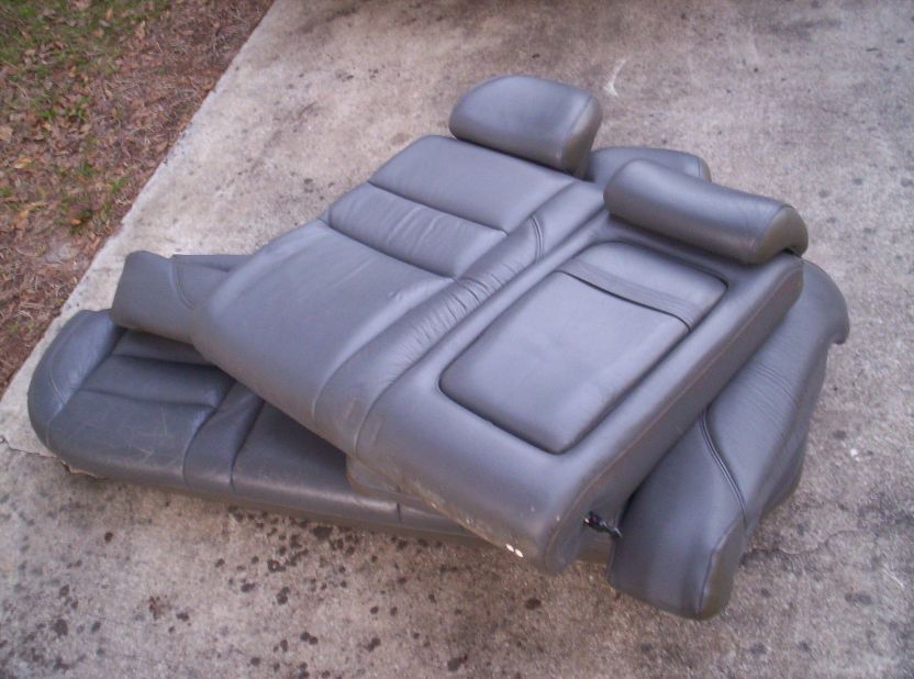

Here are some before and after shots of the pass seat.
Much better condition! and also it is black not charcoal. Im going to be selling the pass seat, and the whole back seat... the back seat is in near perfect condition as you will see from when i write up about that.

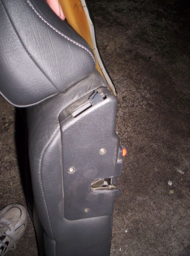

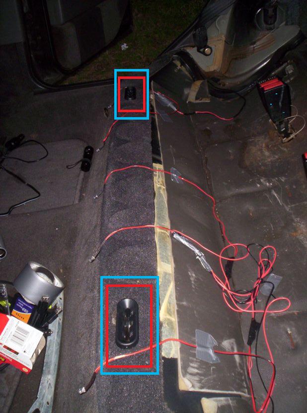

Start off by laying your seats down using the lever. Once your seats are down you can remove the side pieces. they come off by simply pulling at the top *YELLOW* , and lifting straight up *BLUE* Now that that is done and the two side pieces are off.
You can go one or two ways, remove the bottom seat, or the back seats...
Well go with the bottom first.

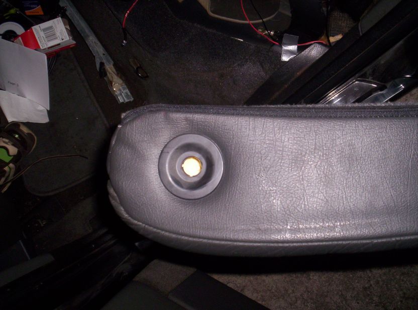

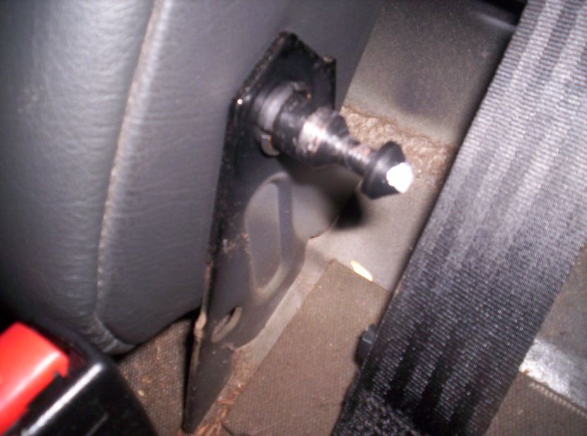

Simply pull up on the front and pull out. there are two holders, one on each side. simply pulling up in those locations will release the seat.
*please ignor my horrid wiring of leds... taking those out later. Once that is done you should be down to just your seat backs.

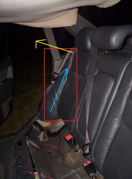

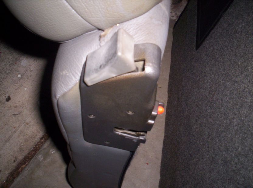

make sure they are folded down all the way and select a side, I went with the drivers side first just because it was closest.
Pull towards you and lift up on the seat. This will compress the clip and allow you to slide it out. once you get it, repeat on the other side, you will notice the pass side has a prong if you will, that goes into the other seat on the side. so you will need to remove the drivers side before you remove the pass side to avoid to much difficulty.

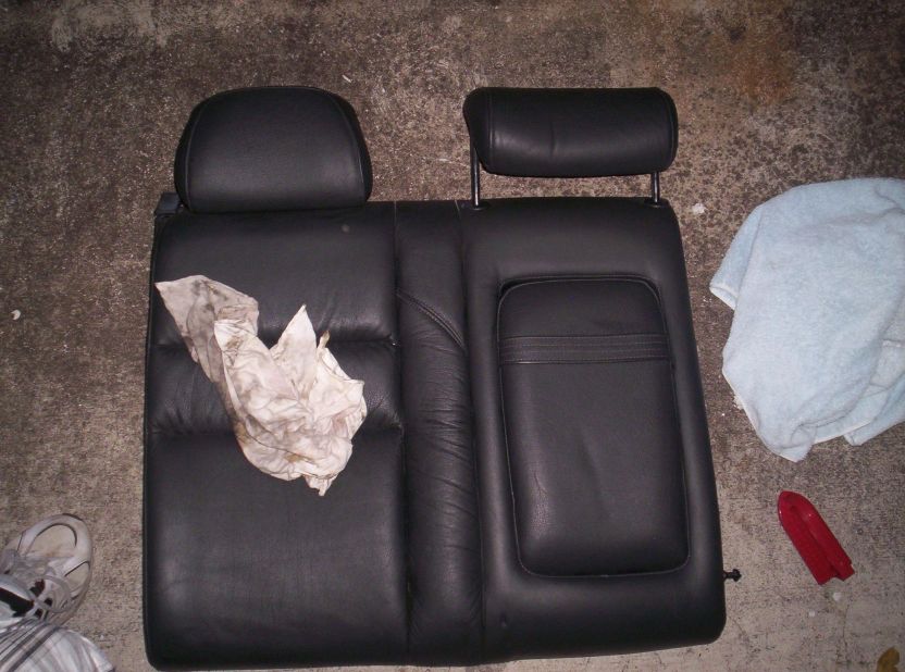

Now that they are out do what ever you need to do!
Before and after photos
previous seat color new seat color Also can someone help me with this...
