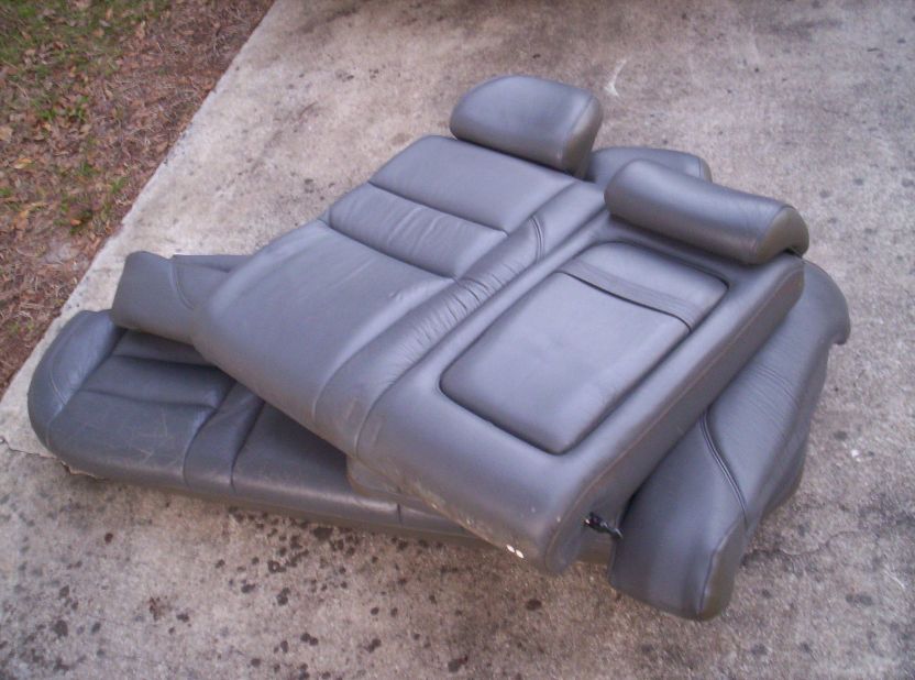

Here are some before and after shots of the pass seat.old pass seat.jpgold pass seat.jpgSeat after shot.jpgMuch better condition! and also it is black not charcoal. Im going to be selling the pass seat, and the whole back seat… the back seat is in near perfect condition as you will see from when i write up about that.
