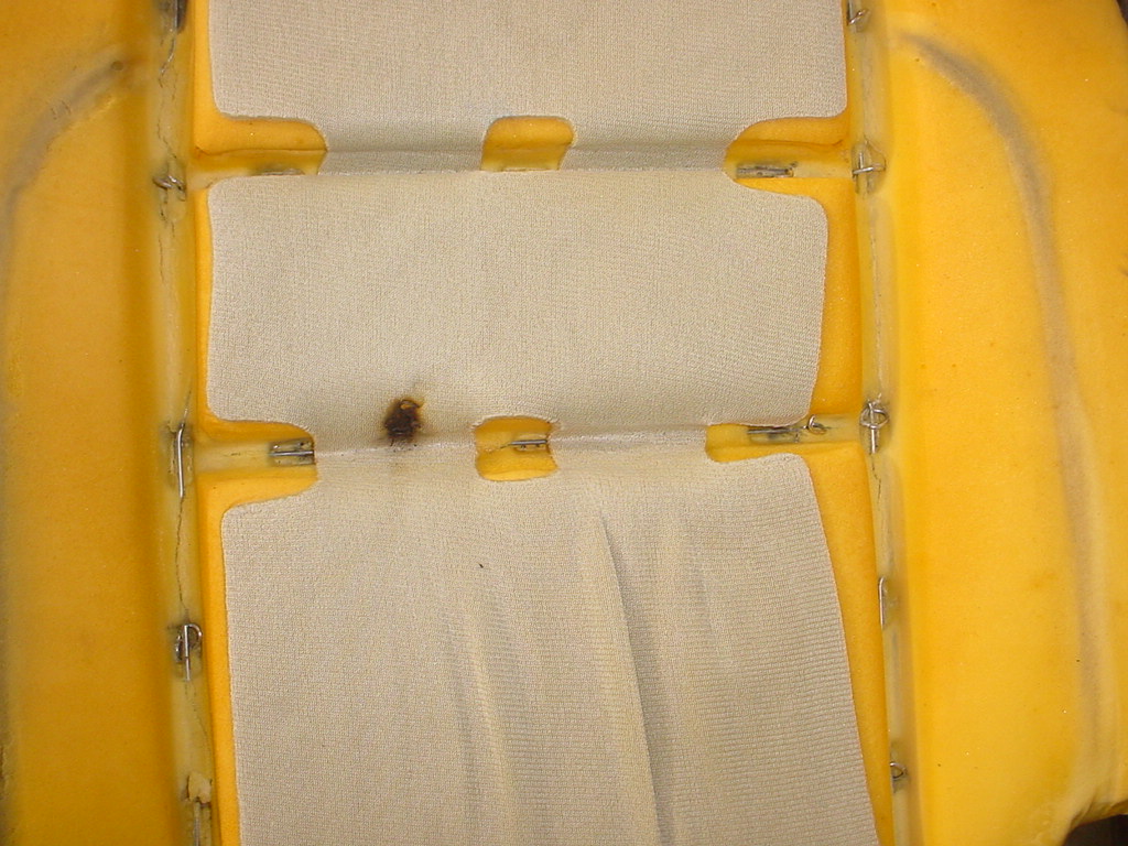

If memory serves, the notice indicated that the thermo could fail and cause the heating element to burn out and in some severe cases, cause the foam to catch on fire.
I never saw the recall but I can see that it might be a true story.
That was what one of my burned out elements looked like. Sadly the used replacement I bought only lasted about one "season" before it burned out again. Replacement pads only cost around $50.00 USD. Changing them is tedious but not difficult.
