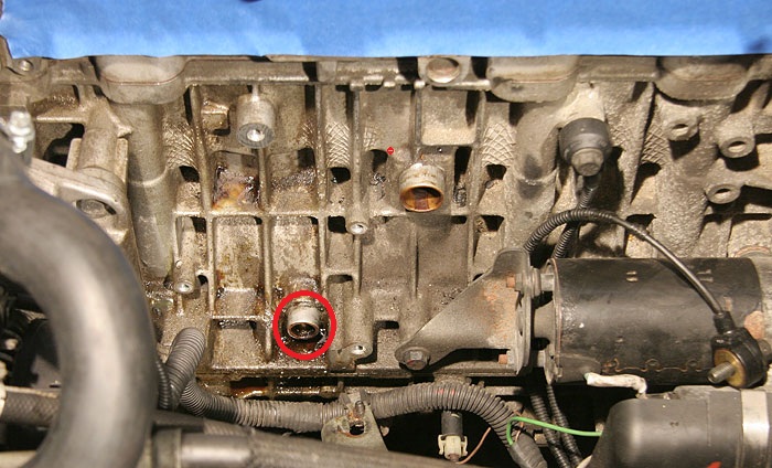

R_F_F wrote:It says to clean the PTC, how do I get the PTC out of the air intake tubing with out breaking it? Does it turn a certain way or do I just pull on it? I pulled and turned a little but I don't want to break it if theres a certain way to get it out.
I'm not sure since I have never removed mine. However, I don't think it applies to your situation since you have excess oil in the tubes: it's not a problem of the PTC being clogged and not allowing the vapors through. What I think might be the problem with your car is if the oil return opening in the front of the block is clogged then the oil will not be able to drain back and excess oil will be sucked into the intake.
The port I am talking about is circled in red in this photo:

I think you were right. Have the oil separator off. I stuck my finger in the hole that you have circled. Well, stuck it unto a bunch of gunk. Have it cleaned out now. Do I need a new separator or can I just clean the old one?

R_F_F wrote:I think you were right. Have the oil separator off. I stuck my finger in the hole that you have circled. Well, stuck it unto a bunch of gunk. Have it cleaned out now. Do I need a new separator or can I just clean the old one?
You can clean the old one as long as it's not cracked.
