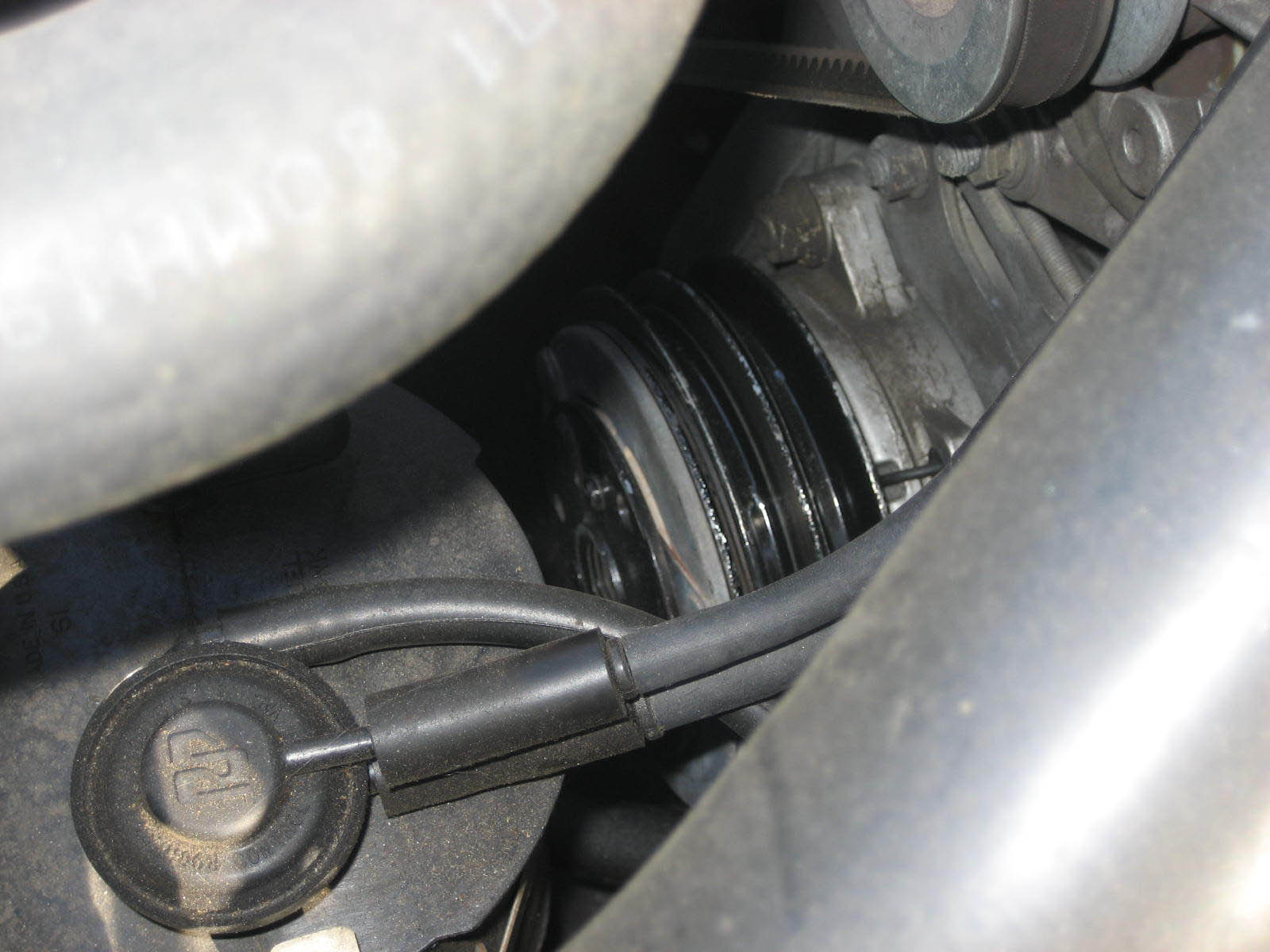

Herewith photo of condensor collar.
The gray ring  is the problem.

Compressor with pulley and compressor clutch assembly. That one is seized, I bet. Sure looks like it got really hot!
I think the clutch assembly is available seperately, otherwise replace the whole compressor and clutch assembly. Was the A/C working ok before all this?

If you reach down there and try to turn that pulley, with the engine off of course, does anything rotate?
I'm guessing he took it off because there was alot of smoke , right?

I reached down, grabbed the gray collar and turned it with my hand. It and the pulleys behind it turned easily but not loosely.
