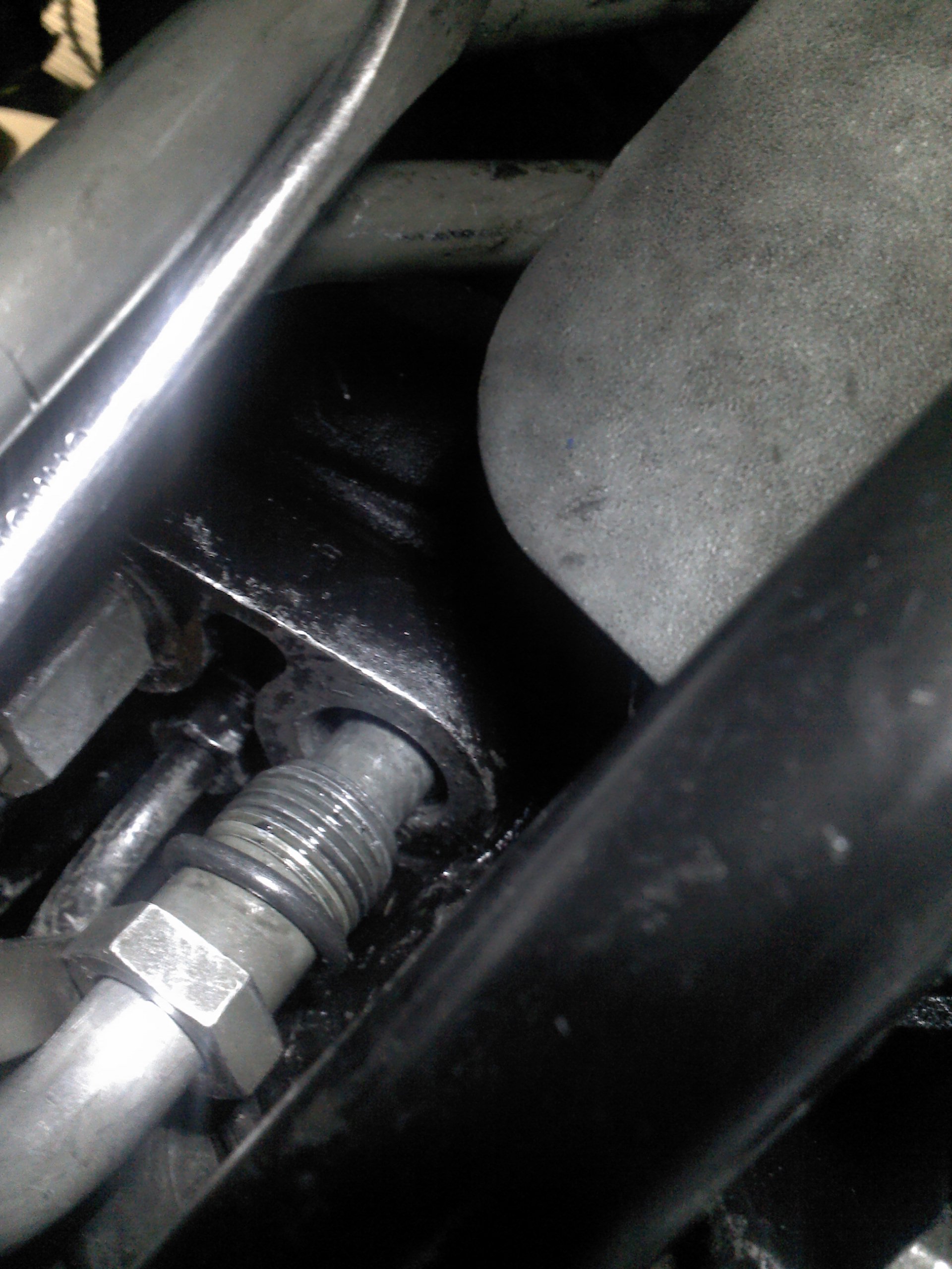

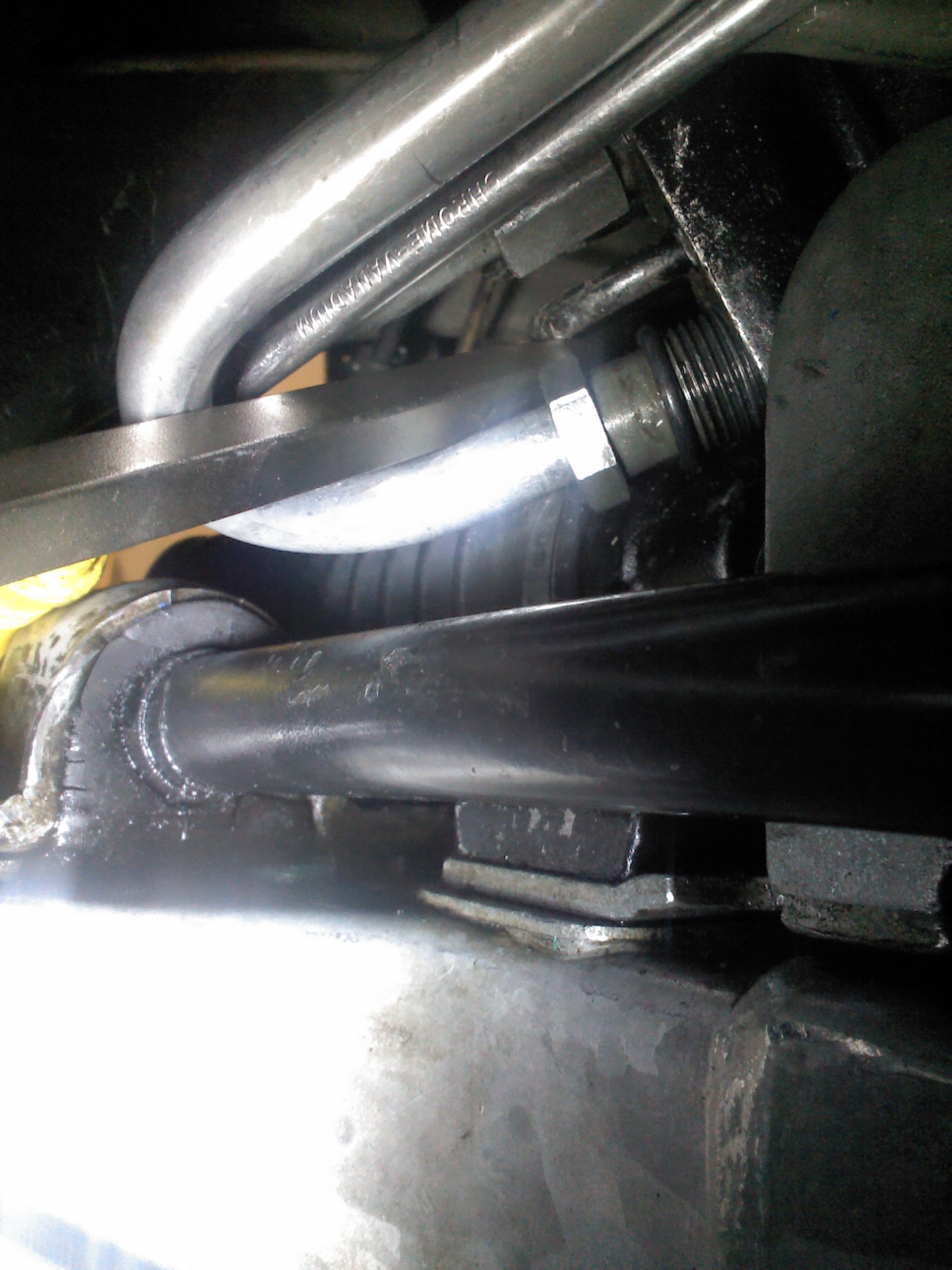

Thanks! We finally figured it out! Now my fluid line; the large one want catch into the rack! This is the only issue with me putting it back together! It doesn't look to be stripped inside but the nut first thread doesn't look right! The line will line up great but can't get it to catch; so I can tighten it down.
I am at the point of redoing it; taking all of it out again; to pull the line out and maybe replacing it.
Is there any other ideas of how to get the connections together or to pull the large line out without taking all the stuff loose again????
I bought a rack for 139 plus tax; had an issue with the steering shaft but got passed that and now the large hydro line want catch a thread to the steering rack so I can tightened it down. I have it lined up perfectly but it still want catch enough to be tightened. Anyone have suggestions? Thanks!
As you can see it is so close but no completeness!!
Any and all Ideas or suggestions are appreciated! Thanks!

Is it possible to partially loosen off the other end of the hydro line sufficient to get the bottom end thread to align better and to start the thread off?
