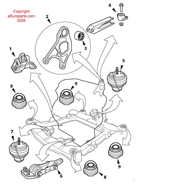

I posted the same thing here.
Use this diagram as a reference to the thread below (open the thread below in a separate window so you can compare what these guys are saying):
http://volvospeed.com/vs_forum/index.ph ... nts-total/

Okay so I finally had a chance to take a look! If you are using the picture above. #1 is smashed and and I can only see one of the 2 bolts that go into the engine. Numbers 5 and 7 have white "something" all around them I am told that this is the fluid but I don't see where the fluid is coming from! So the plan is to do them all myself, is this outlined somewhere on this site? Also am I correct in finding the OEM parts are 7: Hutchinson, 5:Corteco 1:Lemforder?
- Posts: 8254
- Joined: 31 March 2010
- Location: Omaha NE
- Been thanked: 467 times
Changing any engine mounts in any car is usually a straightforward business.
- Place a floor jack under the engine with a piece of wood in between as cushion.
- Gently jack the engine oil sump until it is snug and stop.
- Now gently jack it up maybe 1/2 inch to release pressure on the engine mounts.
- Replace one engine mount at a time for obvious reasons!
(The other engine mounts, although bad, still support the engine somehow).
You may as well do them all.
eeuroparts.com has the best prices.
Corteco, Hutchinson, and Lemforder are all good brands.
Stay away from Uro and Hamburg-Technic.
