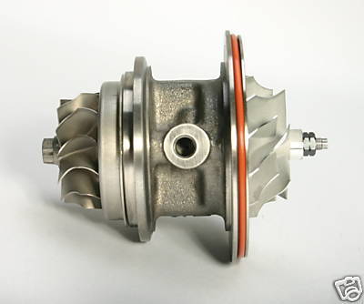

i mentioned this on volvospeed and got chastized before i could even explain myself, but i have done more research and thinking, i know that a dsm turbo will not bolt directly up to volvo, however i was thinking that if you fully disassemble the turbo, removing the intake and hotside of a dsm 20g, and put the volvo housings on the core, i dont see why it wouldnt work and still look stock even.

the turbo cartridge should be the same, correct me if im wrong
td05 cartridge.jpg (12.73 KiB) Viewed 804 times

If you can fit it into the 18-19 housing there won't be a problem ok you might need to adjust the manifold for the offset on the turbocharger housing.
