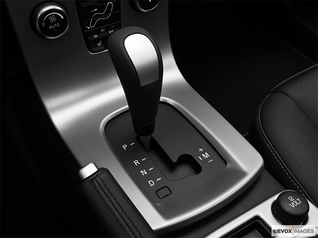

There is no button for the solenoid.
2001 center console.jpg (136.46 KiB) Viewed 2790 times

I may be wrong, but I believe your shift lock override button is under that little rectangle just below the "D" symbol. Get a small slot screwdriver and pry that off; it should be under there. A lot of cars don't have them as handy as the 1st gen 70 series Volvo. I am just going off the small picture, use common sense and don't pry on it if it is not made to move :)

EstVolvo wrote:There is no button for the solenoid.
Looks like it would be that spot under the D like previous member stated.
