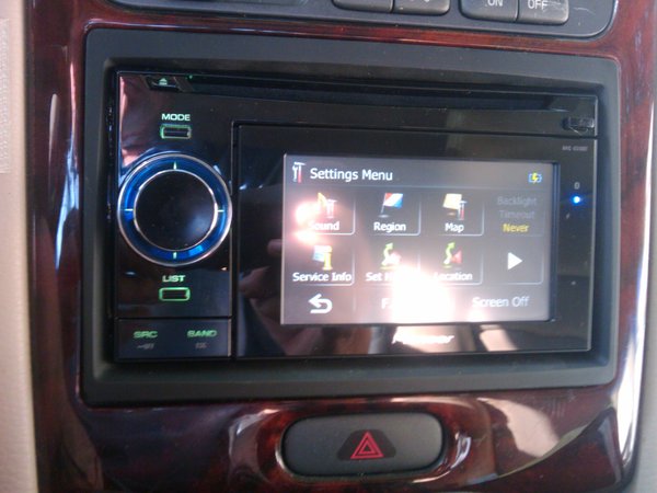

Hate to revive this, but I had a hard time finding information.
I did have to trim the rails inside the hole a little.
I also bought a trim ring for a f-150 ford 2004-2008 to get the finished look - it did require trimming to fit. I think it looks good.
I hope this helps some of you out there!
Double Din
Double Din
larger area

That looks REALLY good.
