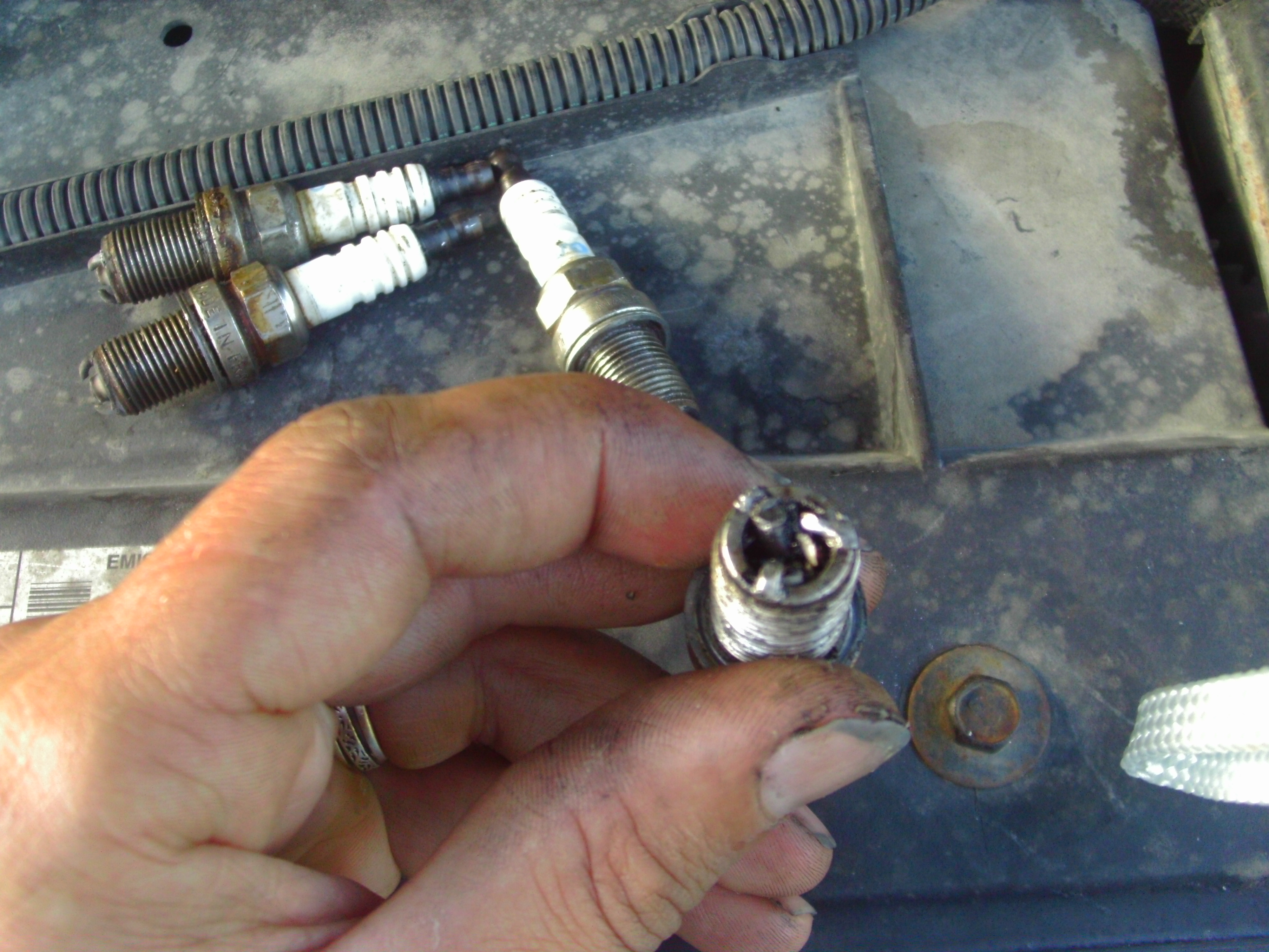

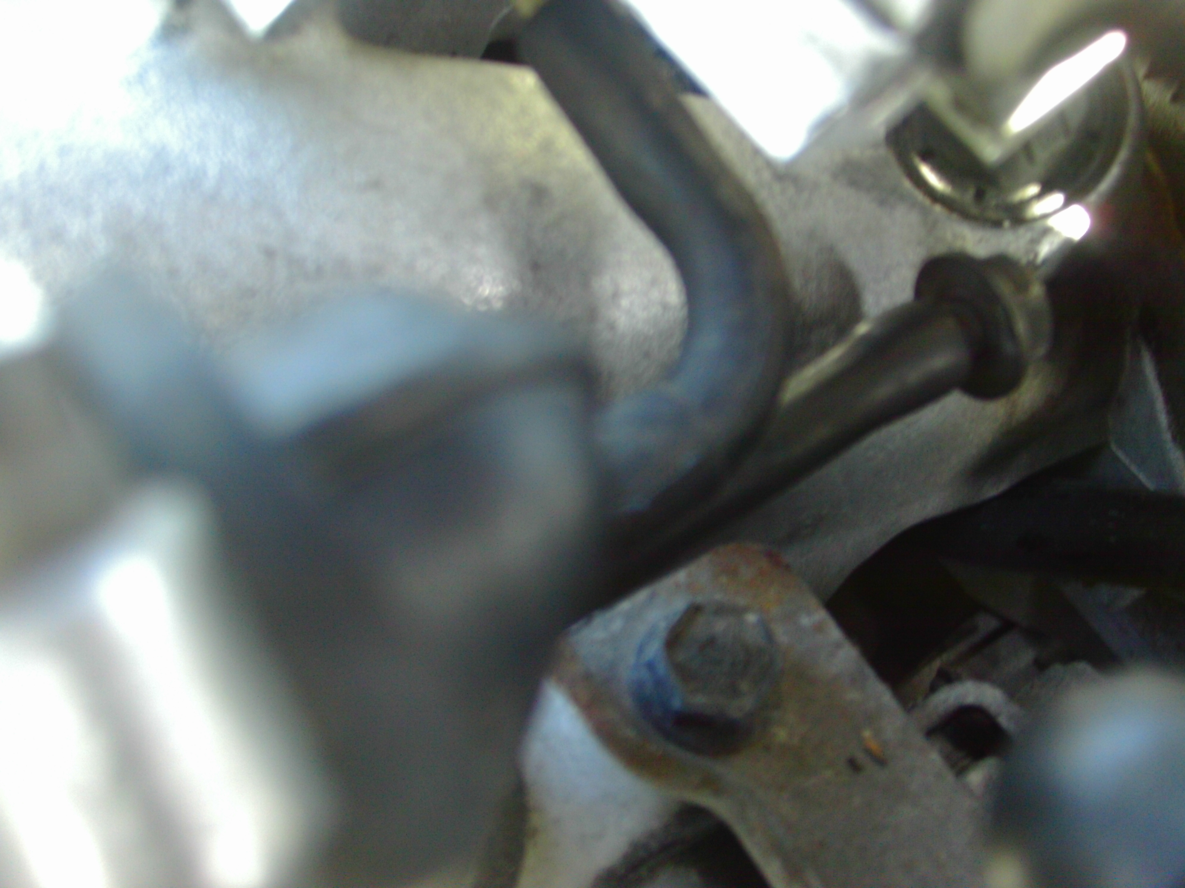

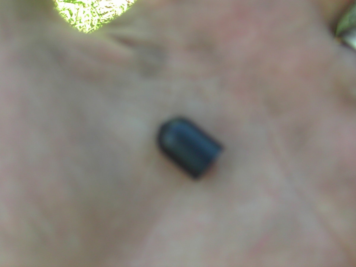

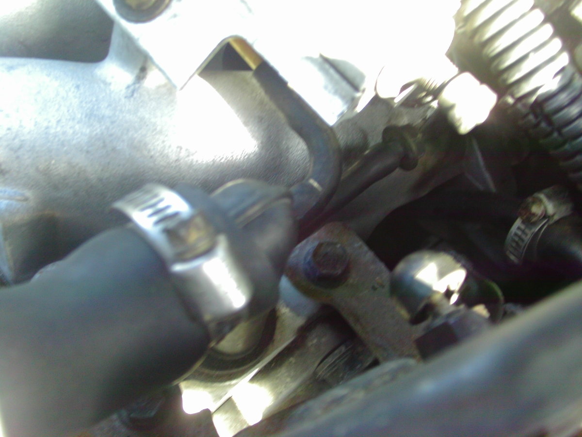

Hi, and thank you for the post, I have got the code 543 today when I did a bad mistake, I bought a hose plug and I put in in place of other hose that was closed with a bolt,. after I left the junk yard, I started the car, and I drove it about 100 feet when I heard a noise. I tought it is something normal with compression, then the car kept shaking and making more fire noises, then it stopped, when I pulled over I found the spark on the coolant side crashed and dirty but others were fine, I towed my car to the house, I changed the spark plus, but I found pieces of metal inside the EGR, I looked for the antifreeze in the tank which was empty, I checked then the oil dipstick and I found it full! the car doesnt crank or start. I guess it is head gasket and bent valves, am I right, or I hope there is something easy to fix. I love my volvo, ad I want to save it. Thank you guys.

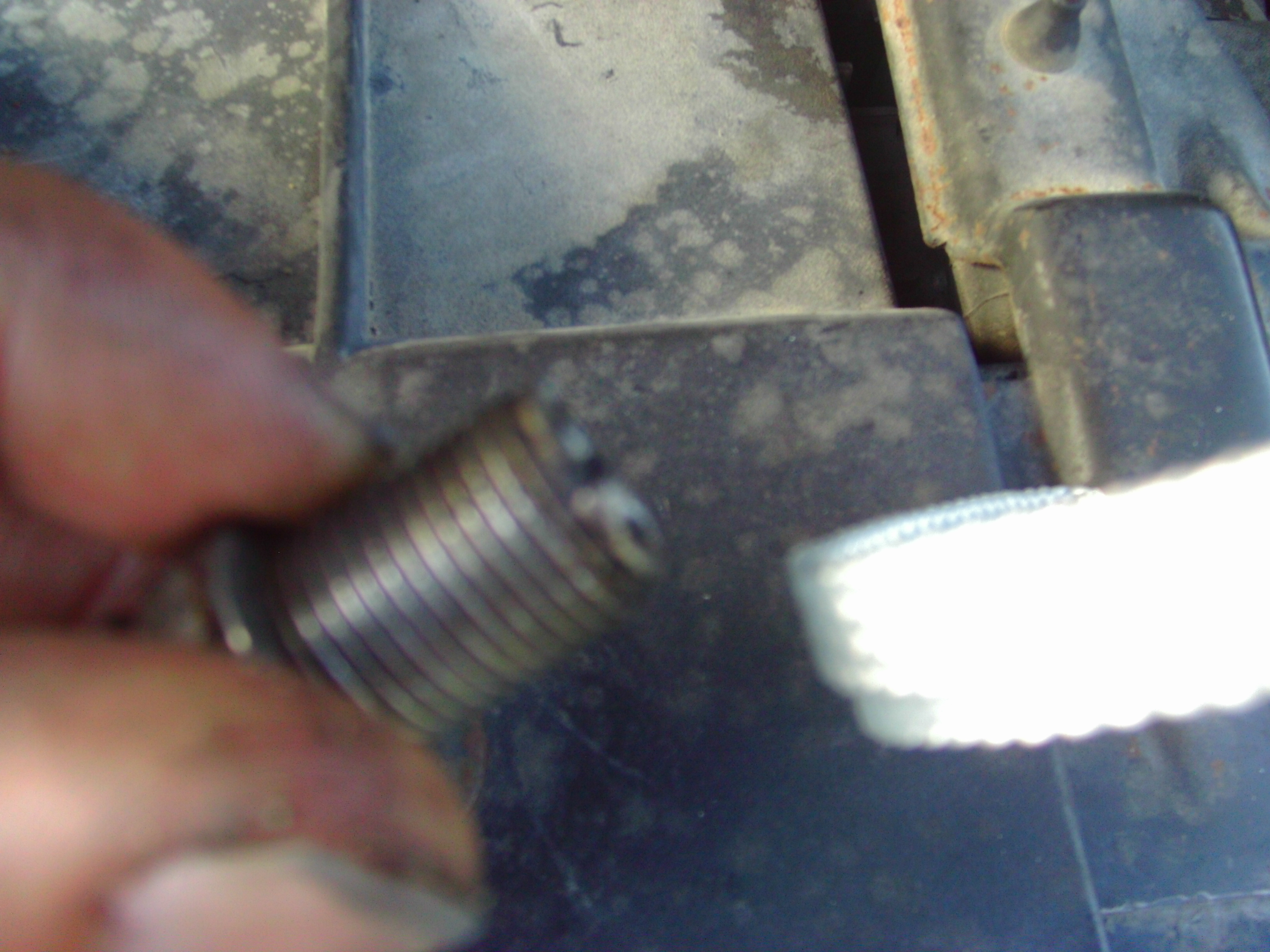

other pics, shown here, and the spark plug crushed. please help me guys, what was that tower? is it EGR? and why it made that issue?

That's the idle control valve hose in the lower picture, but I'm not sure what happened to your spark plug. I'm thinking your timing belt jumped and may have smashed a valve into it.
