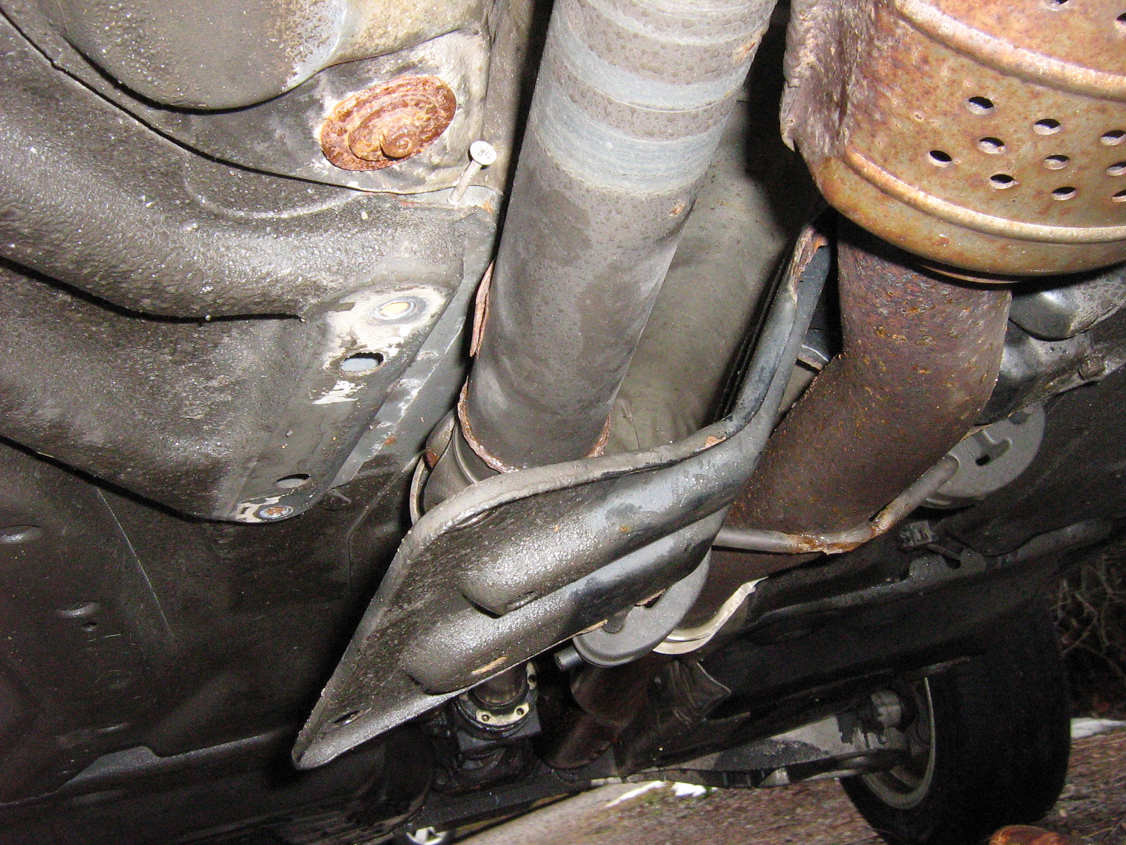

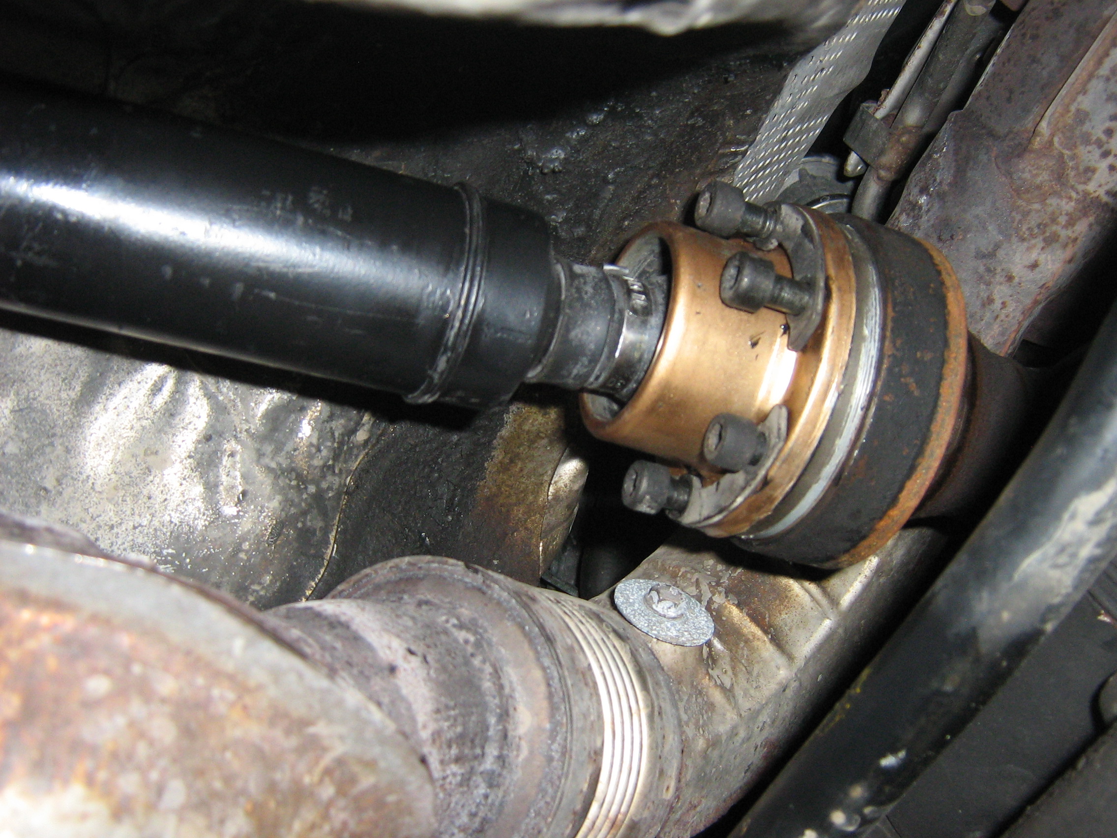

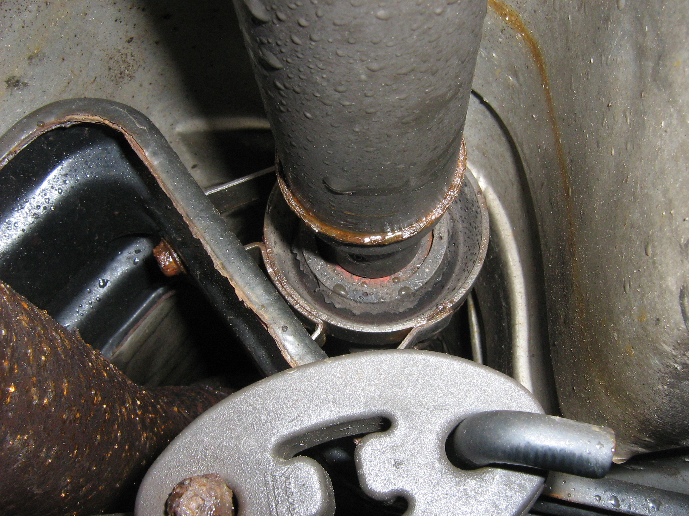

These are good points on the driveshaft removal. The PDF post above also has a lot of good info. The driveshaft is a two piece design with a universal joint and bearing in the middle and CV joints at each end. The CV joints are attached to the angle gear on the front and the VC at the rear. Mark the bolt locations as mentioned above. Basically, to remove the shaft, take out six hex bolts at each end and tap the CV sections loose from the angle gear and VC. Then remove two bolts that hold the center bearing housing (see picture) to the crossbar below it, loosen one side of the crossbar, and let the shaft slip down beside the crossbar. The crossbar is below the driveshaft but over the exhaust pipe, a little complicated but this is do-able. I'll attach some pictures that might help a little- one of an old and new driveshaft (from Colorado Driveshaft), another other of the end that connects at the front, some pictures of the center bearing housing and the crossbar. These got out of order in the upload-start at the bottom. My experience is that the front CV joint fails due to heat from the exhaust. However, the CV joint makes a repetitive pinging or clanging noise when it fails, not a growl. Other people have had problems with the center bearing.johngxc wrote:There's a post somewhere on how to remove the prop shaft. This (IMO) is harder than the post makes it sound. Be SURE to mark the shaft and flanges, and bolts, so you can replace them in the SAME positions if necessary. The bolts may be different lengths - different lengths are used to balance. Also, the newer bolts are a hex size (at least the ones I got from the local dealer) - I think 6 and 8 mm hex, but not sure.
