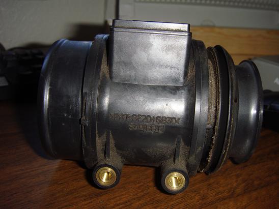

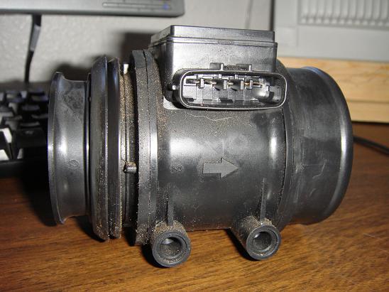

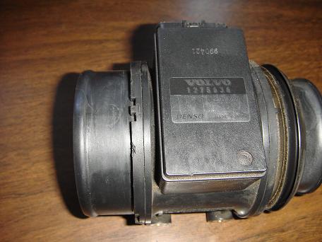

Is this the MAF sensor I need to clean?
E Showell
Posts: 3275
Joined: 16 Oct 2008, 16:00
Year and Model: ‘07 S80 3.2
Location: Long Valley, N.J.
Has thanked: 37 times
Been thanked: 112 times
Post by E Showell »
Yes. Make sure you use only MAF cleaner -- aerosol spray. Do not touch the filament inside the unit or you will be buying a new one. Spray the cleaner. Let it dry/evaporate for several minutes and reassemble. Should be good to go if a dirty MAF was your problem.
