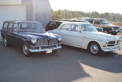

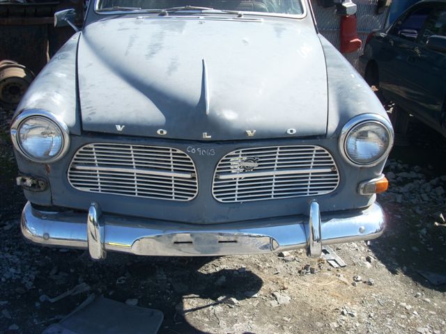

Does anyone know if the bumper guards from these (2) bumpers are interchangeable? From the blue wagons.

Yes, they are interchangeable...The bumper over-rider on the wagon was a dealer installed option that required drilling both of the guards plus drilling 2 holes in the outboard ends of the bumper itself...That is a 3 piece bumper...The joint between the center piece and the 2 outer ends is behind the guards...

The wagon is a '67...The sedan looks like a '65...

Thanks I found a bumper at a salvage yard. Too pricey to re chrome! And yes, Jerry you are correct about the years.
