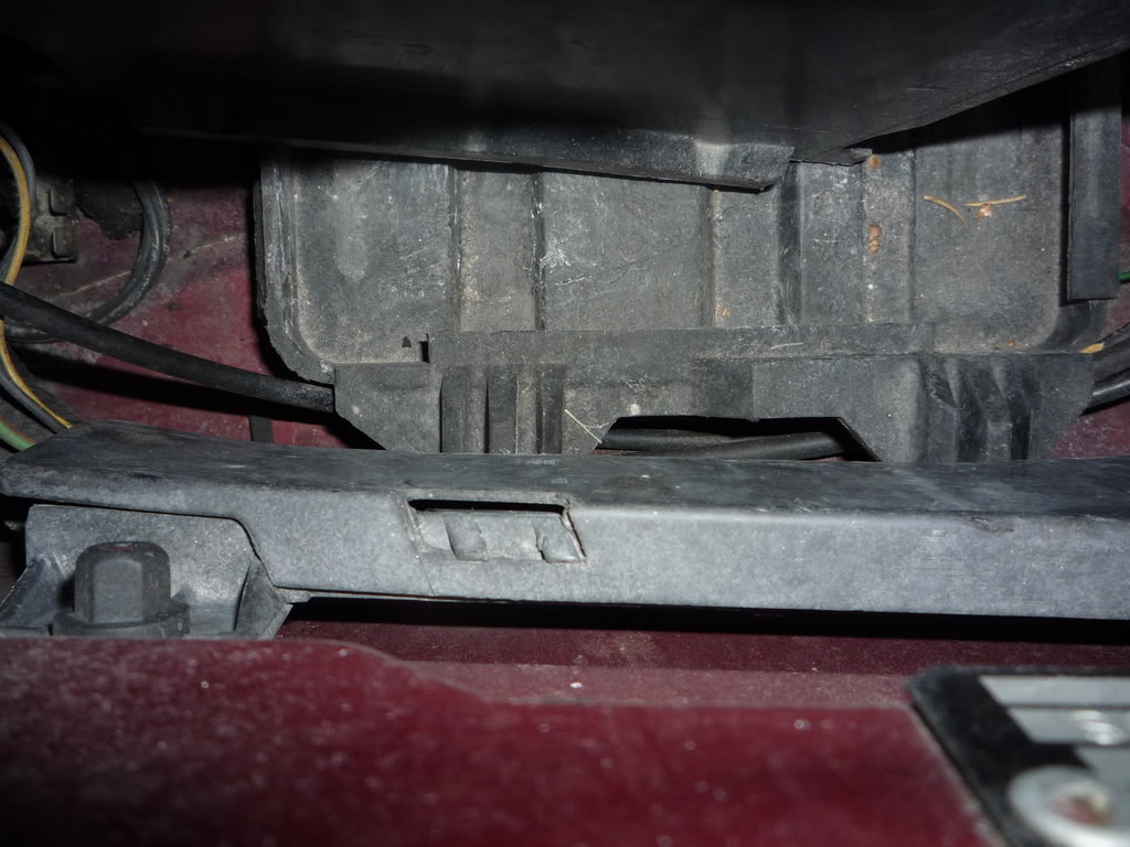

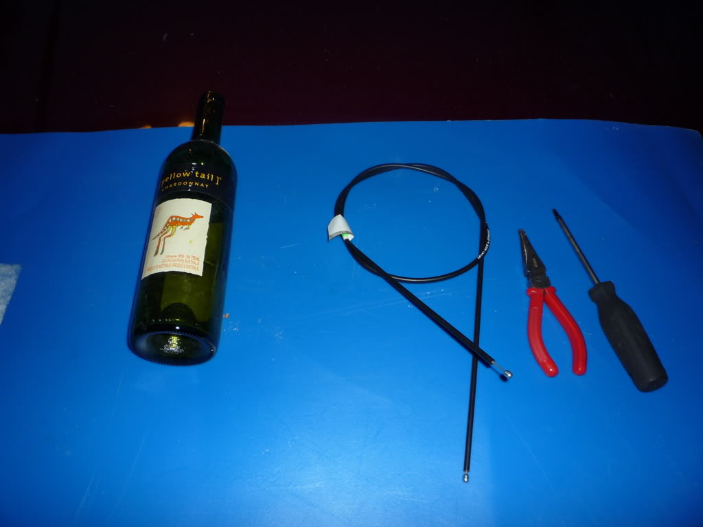

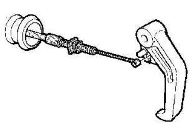

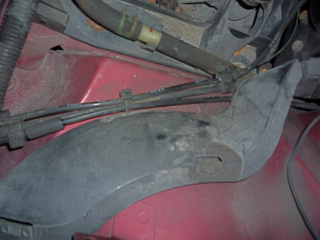

I had an annoying problem with my 2000 V70 XC and I couldn’t find any references to figure out and fix the problem. When I pulled the hood release handle inside the car, the driver’s side hood latch would still be locked when I tried to open the hood.
I would have to pull the handle a few times and eventually it would unlock the driver’s side latch or I would get someone to pull and hold the latch while I lifted the hood. Needless to say, this drove me nuts. I then began to examine the car using the one diagram I had of the hood latch release. I would assume that this adjustment would work on a number of Volvo models, but I am unsure. What follows is the method I used. This method seems to work perfectly, but your mileage may vary!
