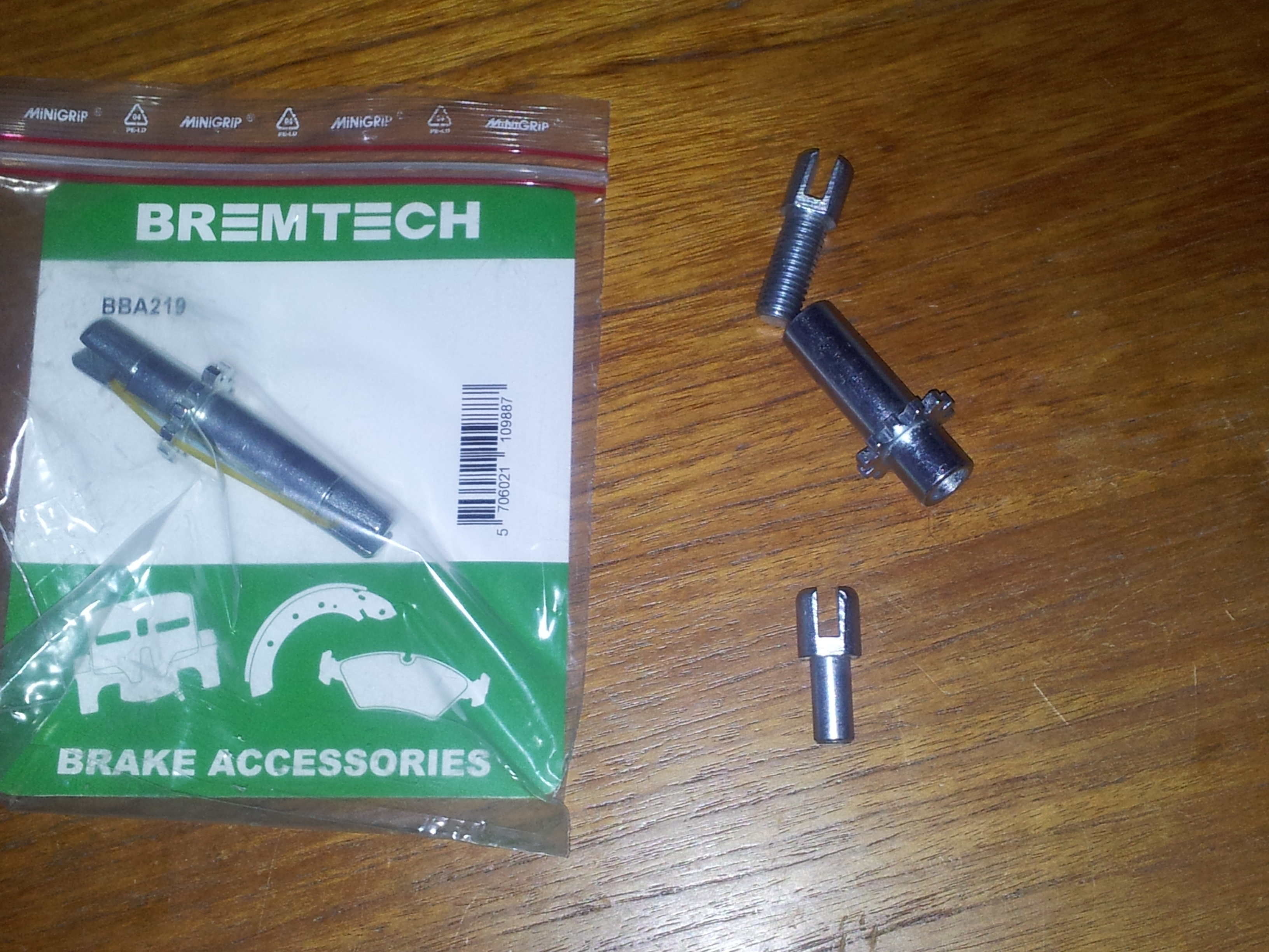

I am waiting on disks to do my rears, parking break shoes and springs. I have also purchased two star wheel adjusters (about $30 US) which I am going to retro fit in place of the 'H' shape bar . Once in place, the shoes can be adjusted with a a screwdriver blade via one of the wheel bolt holes.
