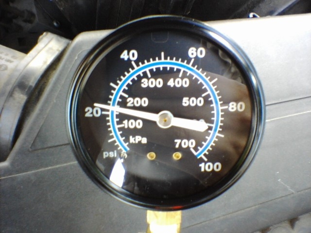

Dealership said fuel pressure should not be below 200 kpa on my Volvo C70 Turbo (2001), with car key in position II (not started).
Bought a fuel pressure gauge ($34, ugh) and tested.
Results: app. 150 kpa and holding there.
Does this mean new fuel pump?

Hi GeorgiaGirlie, You have answered your own question.
Definitely replace the pump but try not to skimp on quality if you can afford it.
