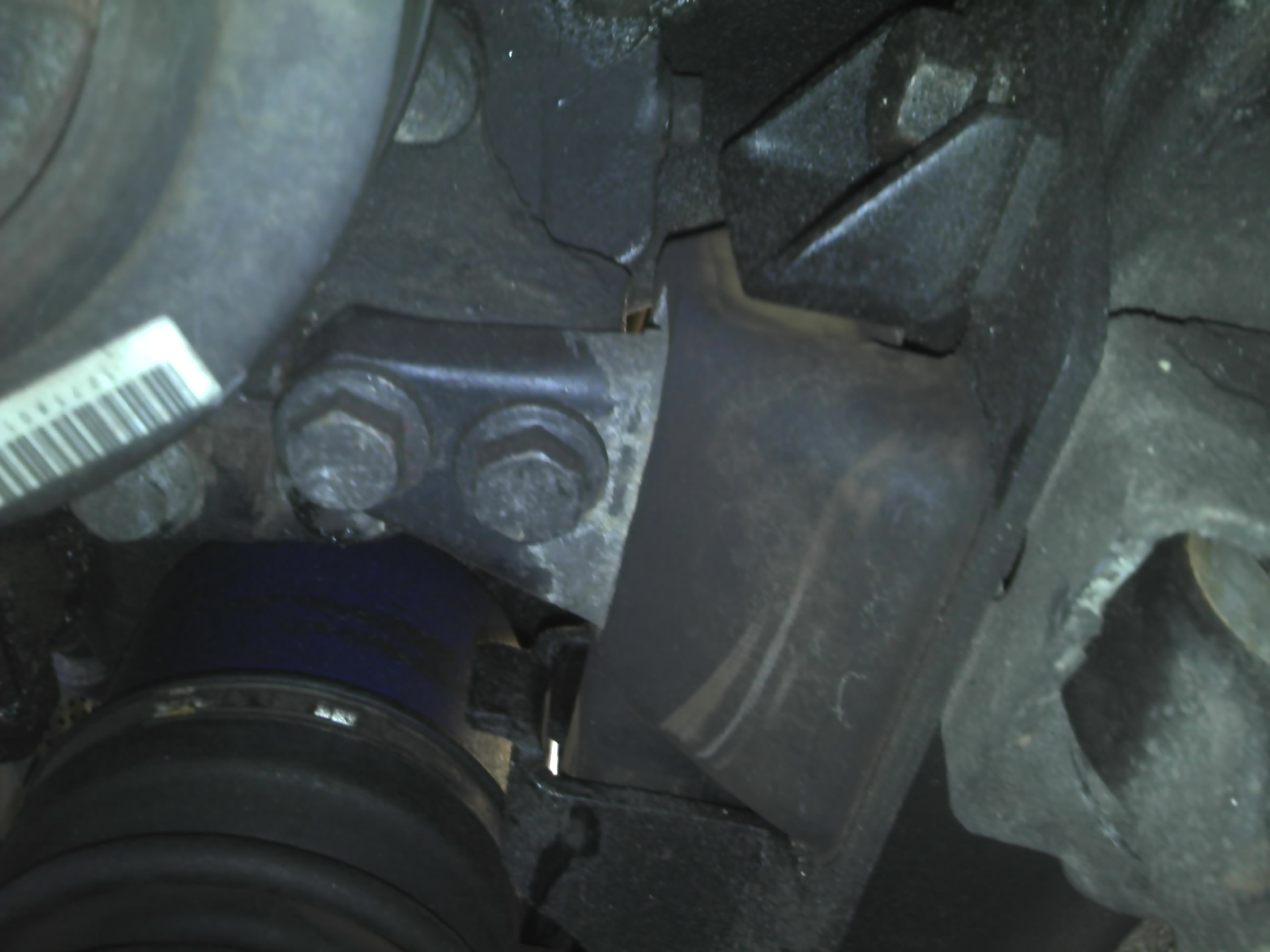

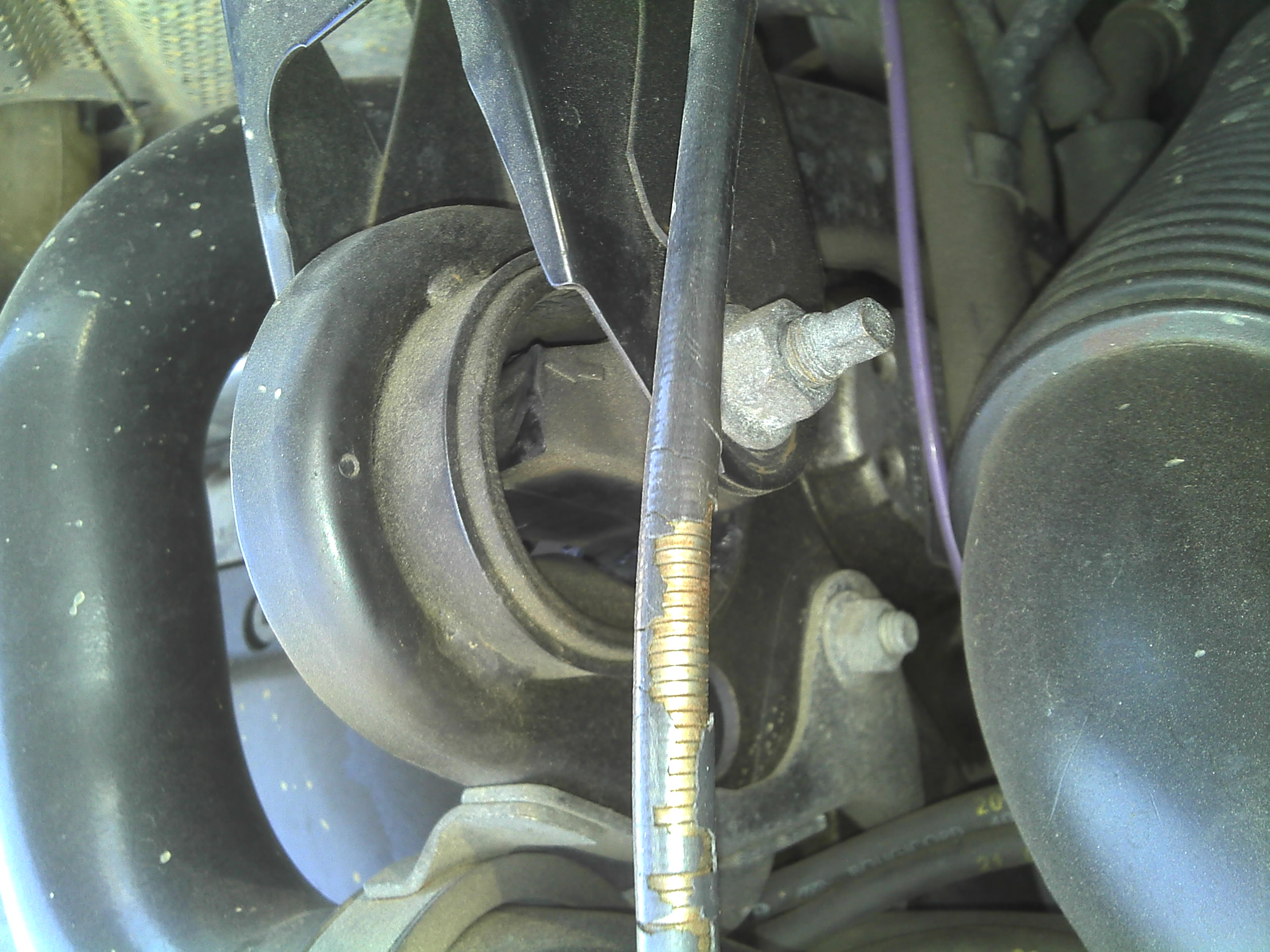

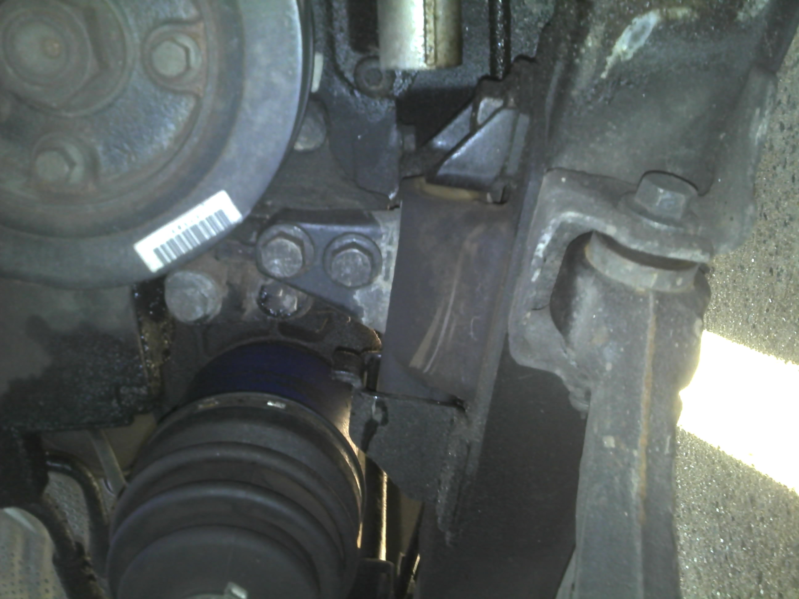

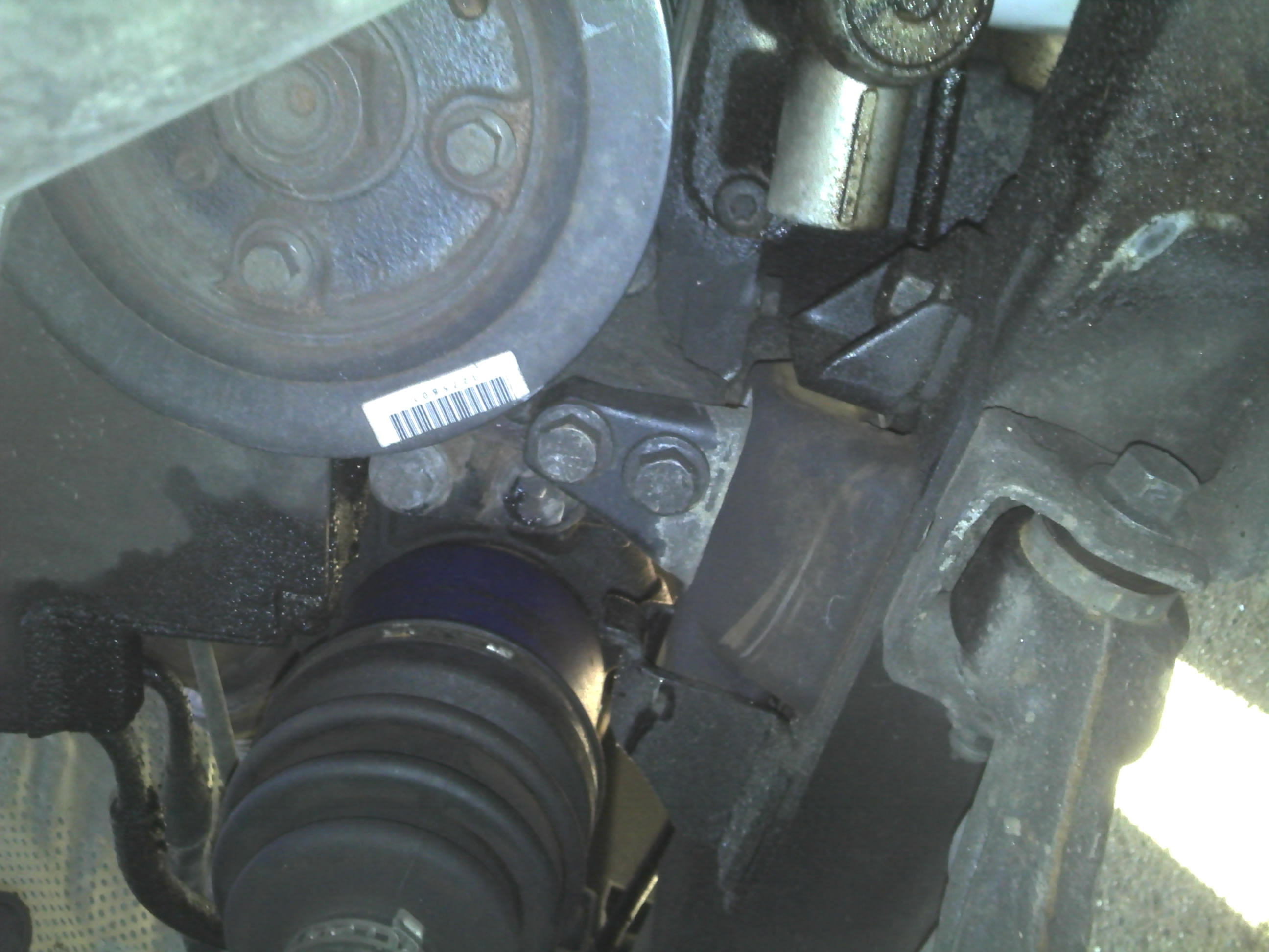

I need someone to tell me if this motor mount is bad. I know the top one is. Also, can I use the poly bushing and just replace that. It seems much easier since it's ripped already. I took some pics of the lower mount but it' looks ok, Is it?

Well, as you already know, the top is shot. As far as the lower (looks like the lower one on passenger side) looks good to me, although I had to bend my head like a pretzel to take a good look at it.
As far as Poly's: I'm OK with it. It does cause extra vibration but it is something I can live with. Most here will shy you away from them so be prepared for the feedback!
Al
