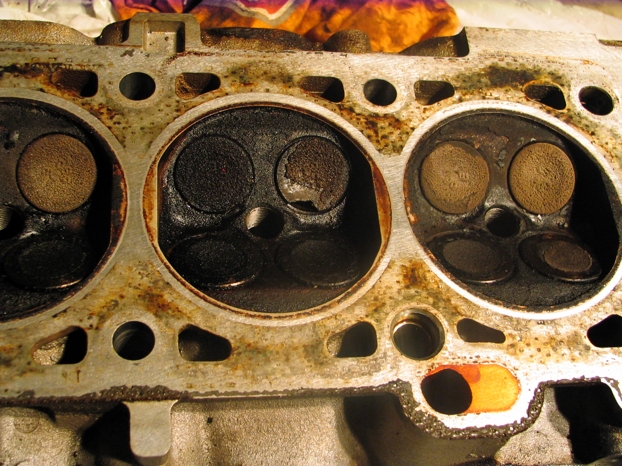

Couple weeks back my car had pretty much the same symptoms: 10-190-200-195-195 (or something very similar - don't remember the exact high numbers). I didn't bother with the leakdown test: pulled the head, there was a pencil eraser-sized hole in the #1 exhaust valve.
It made sense because the engine has been burning oil through the valve stem seals for several months now. Head comes back from the machine shop tomorrow, all other valves etc were in good shape. Should be up and running by the long weekend.

I head gasket failure can create all kinds of symptoms like water in your oil and if its just a chunk blown out you will hear it blowing gas from the head.
Ozark is right as no matter what you do you will have to remove the head and replace the headgasket anyway. I would rather get another head from a yard and have it machined and inspected. I feel for you man but it has to be done.

I will start taking the head off the volvo tomorrow, and I will post back to let you guys know what the result is and follow up on the thread. I think I am just going to get the head rebuilt anyway, instead of just doing the damaged valves(if this is the problem). I am going to give clearwater a try, and hopefully we will be back on the road in no time. Thanks for the help and input.

Ok, I know it has been awhile since the problems with my volvo, but I finally took the head off and discovered it was a burned exhaust valve on the no. 2 cylinder causing my misfire. There was a little chip missing on the valve.
I debated on whether to get my head rebuilt or just get a rebuilt head from Clearwater cylinder head. I went with the head from clearwater, and so far so good. I still have a puff of blue smoke at startup which I thought was bad valve stem seals, but if they have been replaced on the rebuilt head then I guess I have another problem.

pulled mine same thing easer size hole in #3 1998 volvo v70 x/c
